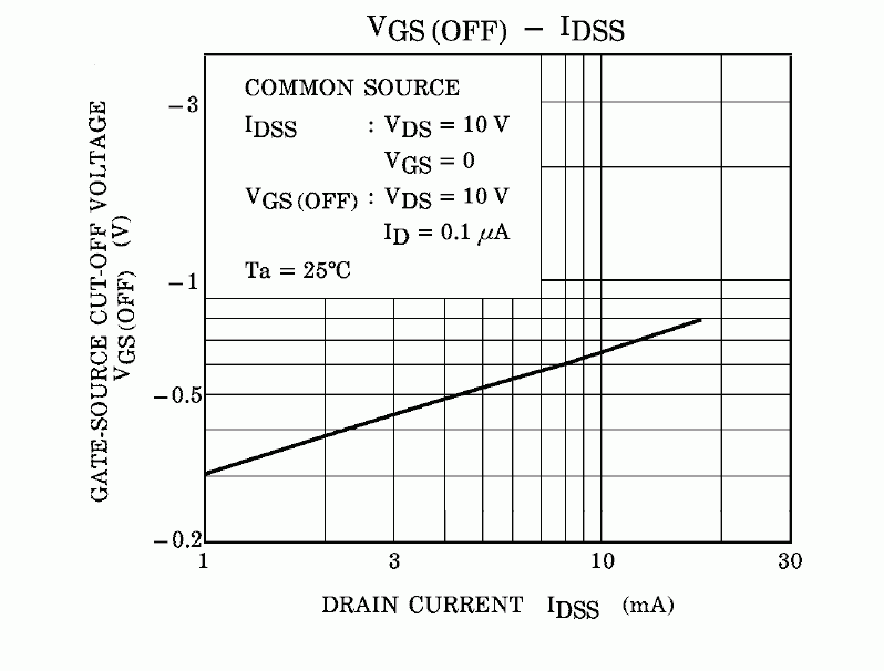

I did the math, and using your formulas:
Idss*(1-(Vg/Vto)^2) = Beta*(Vg-Vto)^2
Idss = Beta*(Vg-Vto)^2 / (1-(Vg/Vto)^2)
and - at Vg = 0 - that
Idss = Beta * Vto^2
Looking in the datasheet, I read that
Idss is dependant on Vto.
I copied the relavant part and attached it.
Tell me, where am I wrong.
Sigurd
Idss = Beta * Vto^2
Sigurd

Syn08,
maybe we are talking about different hings here. I am talking about how to create JFET models that approximately correlate to the JFET's datasheet.
You are of course correct that if you vary Beta, Idss will change.
That is as Idss = Beta * Vto^2 (at VGS = 0),
but you can also vary Vto to get the same Idss value!
The formula Idss = Beta * Vto^2 is only valid for UGS = 0.
When UGS != 0, you will have to use the formula
You say that Vto is in the model, that it correct. But how do you get that value? In SPICE you can get whatever Idss value you want just by changing Vto. No need to fiddle with Beta. But that will not give you real world JFETs.
I get Vto by looking in the datasheet, in the figure I attached in my previous post, by looking at what Idss my model shall have at VGS= and and VDS = 10V,
and then I get the Vto for that JFET from that figure. That Vto is then used in the model.
I then adjust both Beta and Lambda so that SPICE shows me the IDss value I wanted at VGS=0 and VDS = 10V.
Idss also depends on VDS. That is why the lambda parameter is there in JFET models.
There also temparature dependencies in Vto and Beta but I do not use that dependencie.
Sigurd

Sigurd,
For device physics reasons, the FET Id-Vgs dependency is, in a first approximation, parabolic.
For the particular case of a JFET (it's formally almost the same for depletion MOSFETs or enhancement MOSFETs, to an X axis translation) now imagine that x=Vg and y=Id.
By convention, the Vg at which Id=0 (well... almost 0) is defined as Vto. Also by convention, the drain current at Vg=0 is defined as Idss. Please note that these are definitions and they do not, by any means, depend on Vds or Vg or any other variable. This representation leads to an Id dependency to Vg as Id=Idss*(1-(Vg/Vt)^2).
You may chose another set of parameters, that is for example Beta and Vto. Such a representation tells more to the device physicist because Beta can be conveniently further identified (by writing the device physics equations) as a function of the device geometry and some other parameters (carriers mobilities, etc...). In this representation, Id=Beta*(Vg-Vt)^2
Please note that in the above we discussed two ways to write the same physical dependency of Id(Vg). Id(Vg) should be the same whatever representation you may chose, therefore the two representations should be identical. The only way to make them identical is to chose Beta=Idss*Vto^2
Now, again from a device physics perspective, Id(Vg) is parabolic in at least two simplifying circumstances: a) Vds is very small and b) mobility carrier degradation is neglected. We need more that two (Idss and Vto or Beta and Vto) parameters to model these phenomena. Here comes Lambda and the other parameters in the model files I've posted, but these are by no means impacting the Idss or Beta definitions.
The bottom line is that Vto and Idss (or Beta) are independent parameters that you have to extract in order to be able to model a JFET. Idss is something you could directly measure as I've mentioned in my previous post, so it is sometimes preffered by EEs. If you have Idss, then you may calculate Beta to plug into the spice JFET model.
Now, for Idss and Vto you have to choose some numerical values. The regular (and simple) approach is to chose Idss and Vto as the average values between the min and max in the datasheet. Another approach is to get the datasheet curves, digitize them, and do a best fit analysis to extract Idss and Vto and perhaps the other parameters (Lambda, etc...). This can be difficult, because you have to chose in advance the model you are fitting against. Depending of the chosen model, the best fitting (usually non-linear) process could be difficult and definitely could use some sort of computer aided help. Some simulators have the feature to let you enter the digitized curves and spit out the device model.
Datasheet curves are "typical" as much as the datasheet parameters have a certain dispersion (min...max). So in fact you are always simulating a "typical" or "average" case and for anything else you need either multiple simulations or the Monte Carlo method.
I hope this clears the muddy waters.

Onvinyl said:
I have the same models. Your definition, however, is not reflected there, if I'm not completly off anything.
For the 2SK170, it is stated BETA= 59.86m, Vto=0.5024, and you said Idss 12mA. When processing BETA=Idss*Vto^2
I get BETA=12*(0.5024^2)
BETA=12*0.2524=3.028m
Or, vice versa, if BETA is correct, you'd get an Idss of 237mA. Gosh!
I hope I don't mis-interprete the mathematical chars...
The relation of the modeled values are close to BETA=Idss*(Vto*10), however...
Rüdiger
Sorry, it's a typo in my latest post! it should read Idss=BETA*Vto^2 as I've said in the previous posts. Now 60*(0.5)^2=12
Thanks for spotting this.
