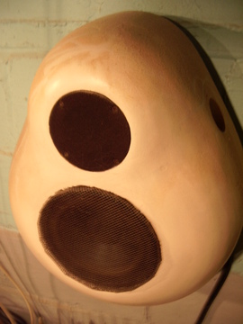

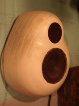

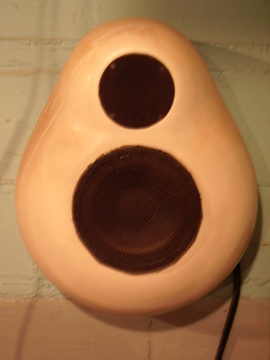

Below are some pictures of my own experiment with reducing diffraction. I built these a few years before the Nautilus was introduced. In fact, the experiment was so successful that I was considering tooling up to produce these commercially until I saw the first ad for the Nautilus. I even considered contacting B&W to discuss compensation. Their idea was publicized before mine, however, and I quickly came to my senses.
Besides, I like B&W speakers a lot. I purchased one of the first 50 pairs of B&W speakers to be imported to the US in 1976, the DM6. I sold them to a good friend ten years ago and he still enjoys them. I currently own a pair of 802's, but I've replaced the stock crossovers with outboard units. B&W is very innovative at driver design and implementation, but they don't seem to put much importance in crossovers. They function, but they don't excel.
The speakers pictured here contain a 6-1/2" Peerless CC Line woofer and a Vifa tweeter. All four drivers cost under $100. The cabs are laminated, plywood and particle board layers mixed. Even mounted flat against the wall, they image like crazy and produce a deep 3D soundstage. If the FR weren't quite so rough (if I had used better drivers), these would be in my main system with a sub. As it happens, they were once used in the kitchen, but now reside in my workshop (hence the coating of sawdust!).
