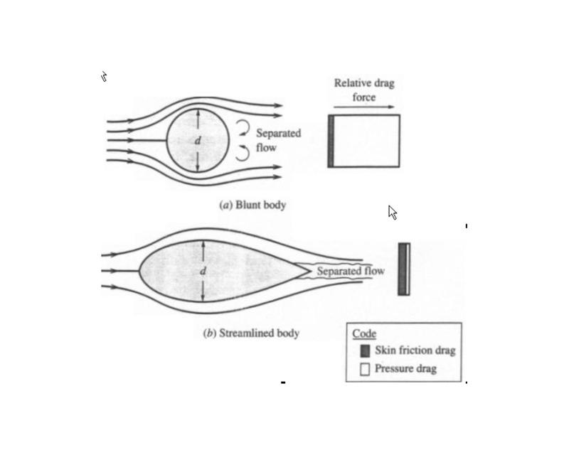

Being very interested in flying I couldn't help noticing the fact that the B&W speaker designs are very similar to low drag streamlined shapes used in the aeronautical world as shown in the illustration below. I wouldn't be surprised if there wasn't a good technical reason for this to be so.
Streamlined body designs are readily available from NASA and others on the Internet,
perhaps we should choose and copy one and use it for a speaker enclosure. Any ideas?

Ovoid gevalt!
cirrus18: I had wondered that myself; how much could fluid flow and aerodynamics could be allied to speaker design.

Re: Ovoid gevalt!
Little if anything from aerodynamics is applicable to acoustics. One is zero frequency nonlinear Bernouille equation and the other the linear Wave equation valid above DC. The solutions are quite different and don't even overlap in comparable regions.
