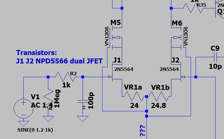

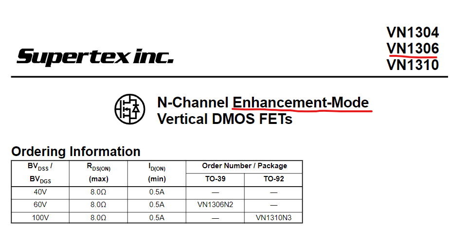

Demian:
Thanks for sharing this.
I'm curious - I didn't think those old Supertex VN1306 were Depletion Mode MOSFETs. Assuming they really are not, how does the front-end diff amp in the "DMA-50 driver revised" bias up properly? I would have expected some high IDSS JFET like a pair of J111 as cascodes instead for this kind of cascode configuration ...
Sorry about the oversight. I am using depleation mod gets now. I just sailed past that detail. I have not looked at this stuff closely since the 1990's. Fortunately my amp has been working fine since then.

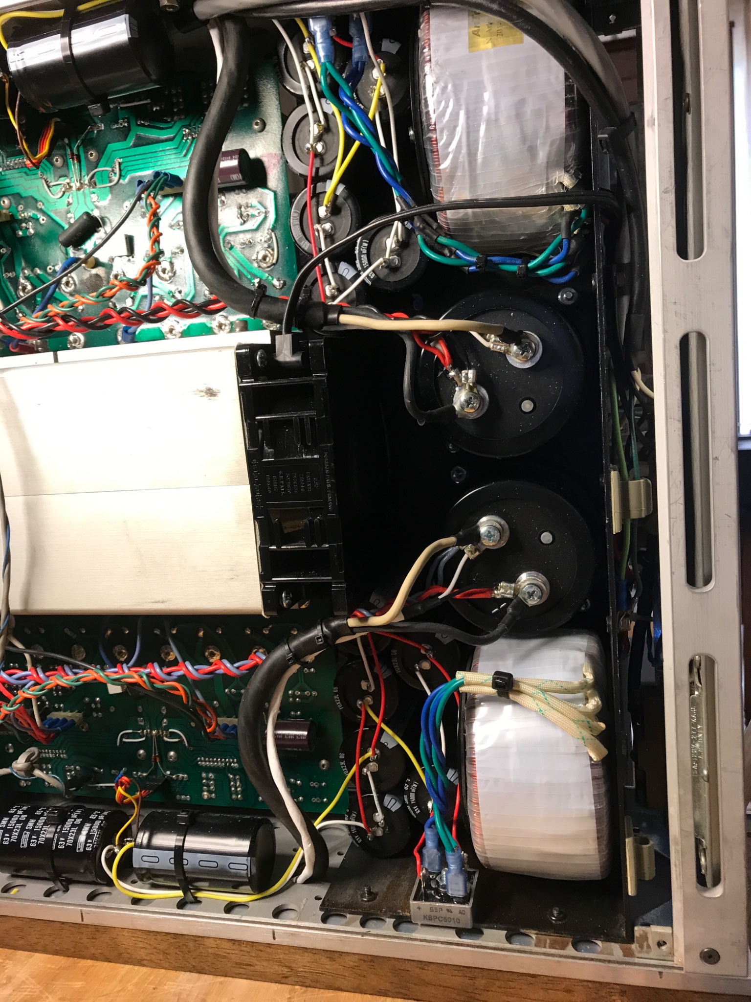

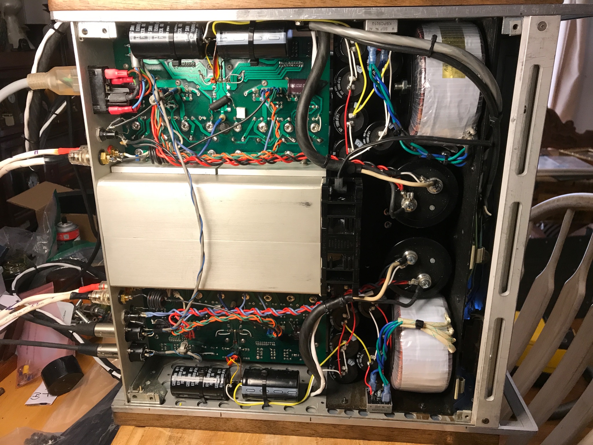

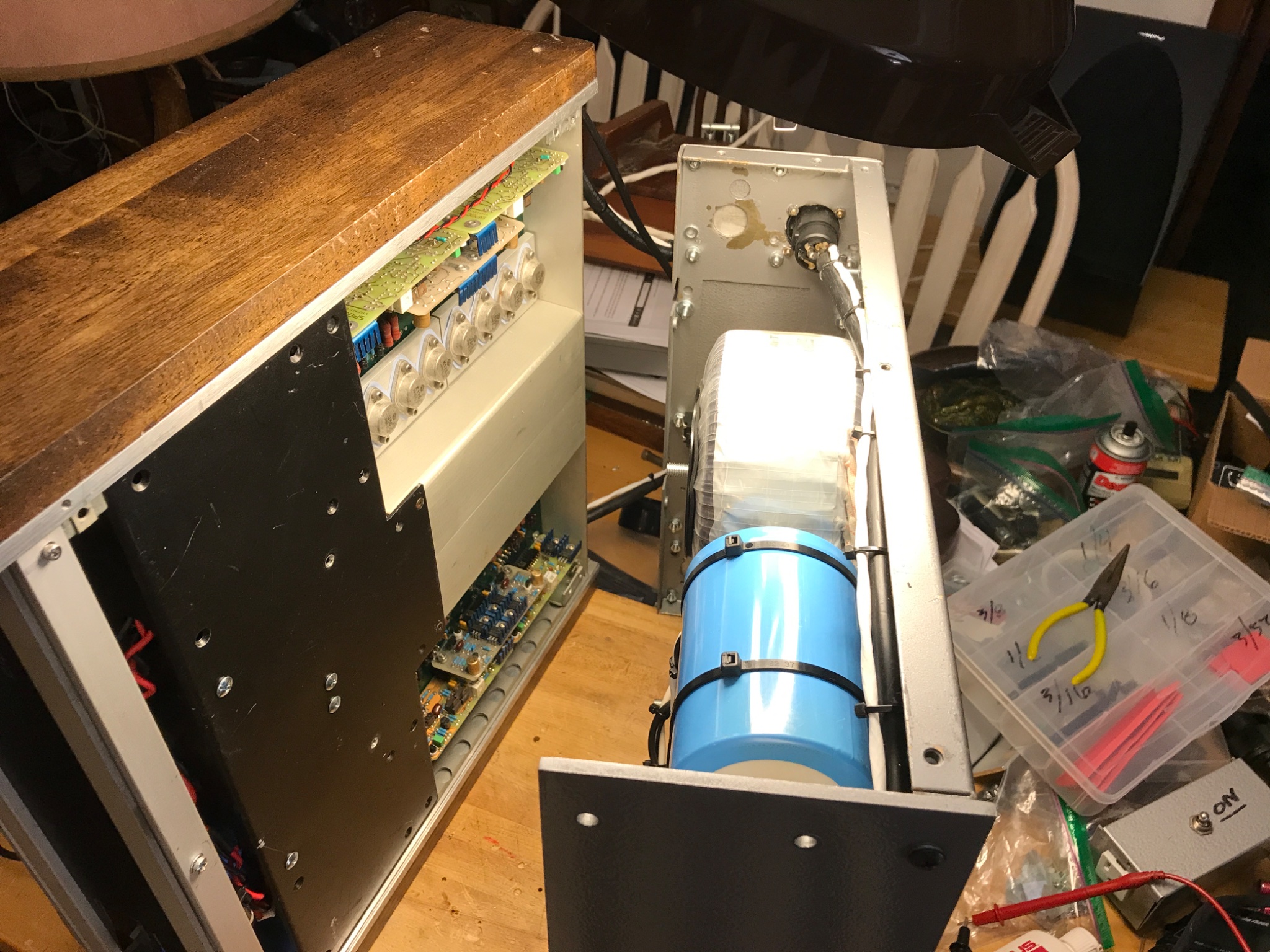

Hi,working on building up the spectral DMA power supply,do you have a figure for the max voltage to the output section….
Currently running 48 vdc +/- …I have a pair of 1000va 25volt transformers,want to use them since it’s no money out,can the output section handle the increase….25 volt in series,50 volt,so,would be 68.7….you had referenced to 50 vdc for full output,48 vdc works fine though,but present supply is a single 500va transformer feeding both boards……

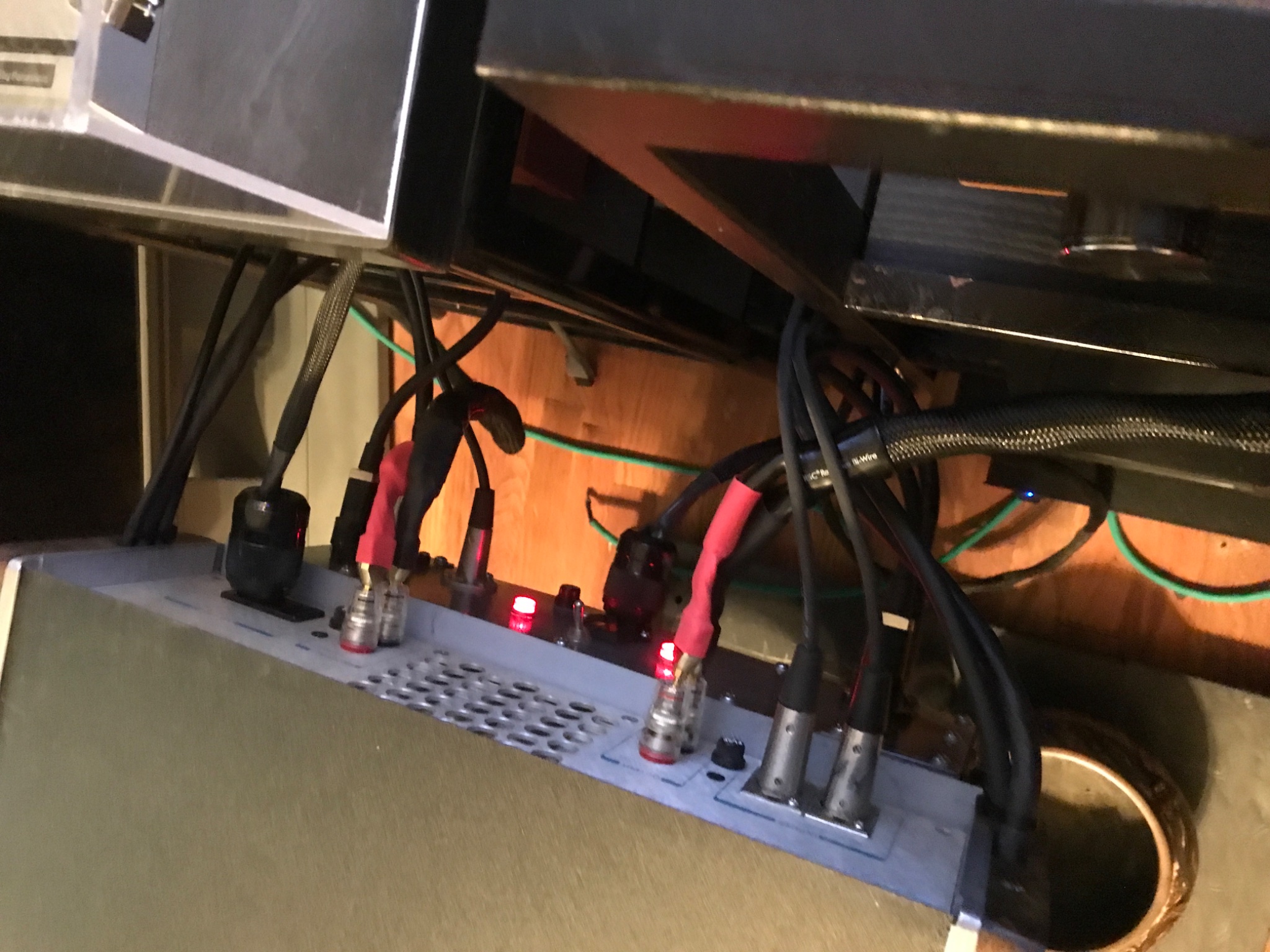

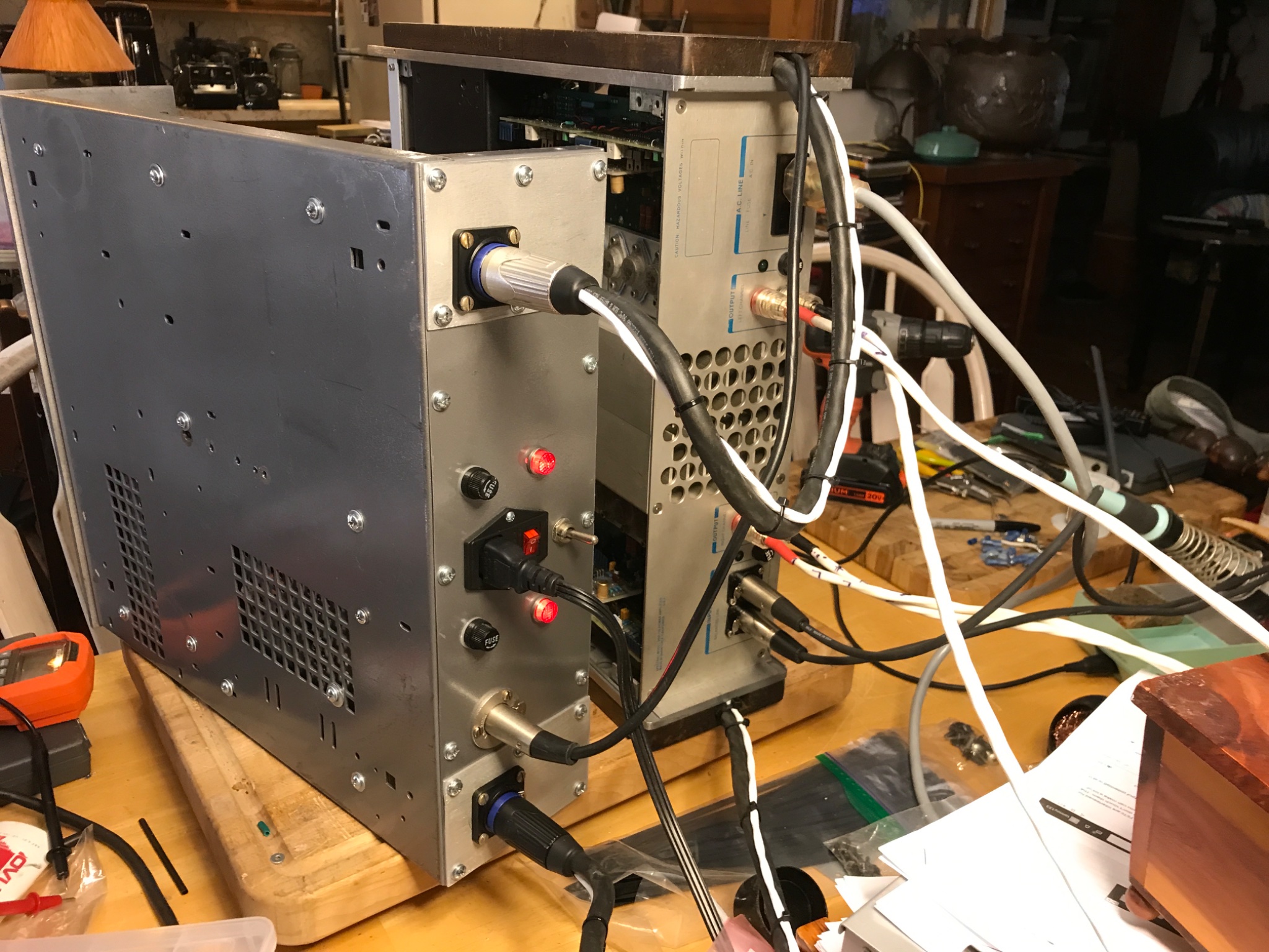

Hi,just finished finals on Spectral DMA 100….dual mono 300va’s at 62 vdc on drivers, dual mono on outputs,800 va’s at 50vdc,yowza great…..much better slam and definition,dead quiet still,much greater detail….im a happy camper!,
Damien,I have a question about setting offset on each side,I need to know the purpose of the resistors that are raised on the edge of each board,also,how can I assure accurate offset,as being BTL,it seems possible to adjust each board individually up or down…I am able to easily set offset,but am I being accurate…bias also is stable,both sides sitting at 100mv
Tha amp is dead quiet,dynamic and sweet….finished with dual 300va at 10000uf at 62vdc for inputs,dual 800va 55,000uf at 50vdc on outputs….Dave
The goal is to set the offset to zero +/- 10 mV or so. it won't be super stable and its DC coupled to your source device can affect things. Having both a few millivolts off of zero will not have any negative effects. its more important that the voltage across the load is zero. I'm delighted its all working for you.
