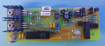

Thanks for sharing the simulation. I have a board here (attached) and I'll check what I did 40 years ago. I'll revise the simulation to better match the board. This is the CAW revised version. I may be able to share my later versions if I can find them.

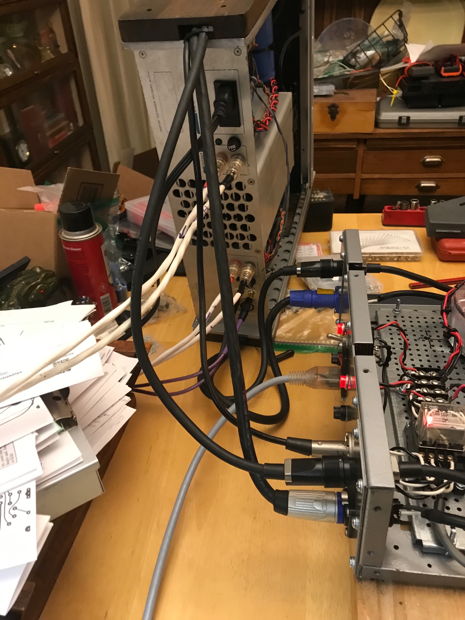

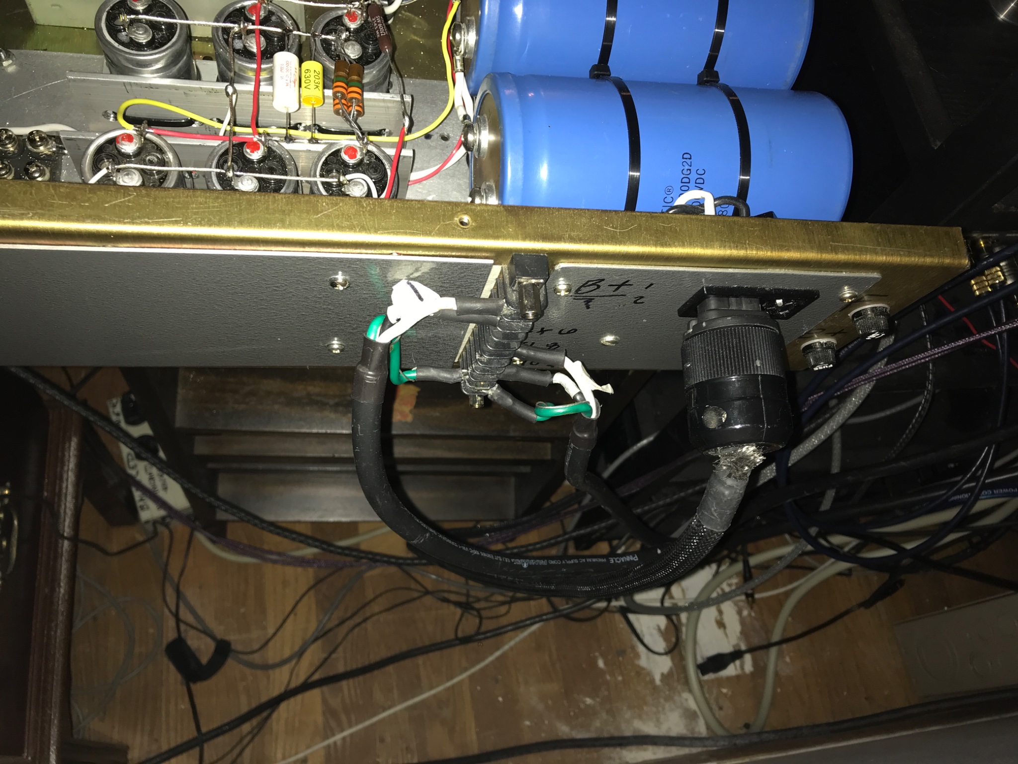

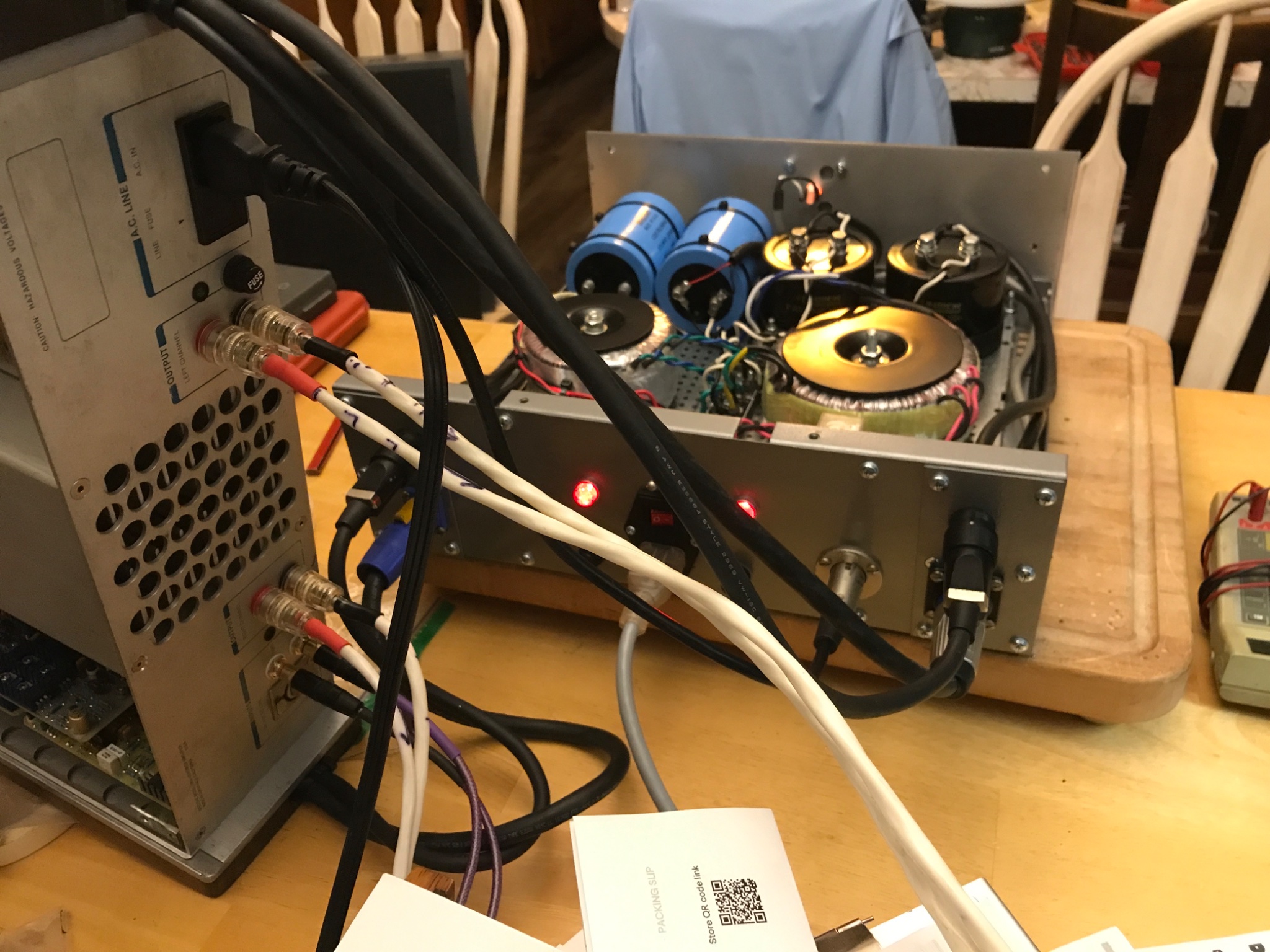

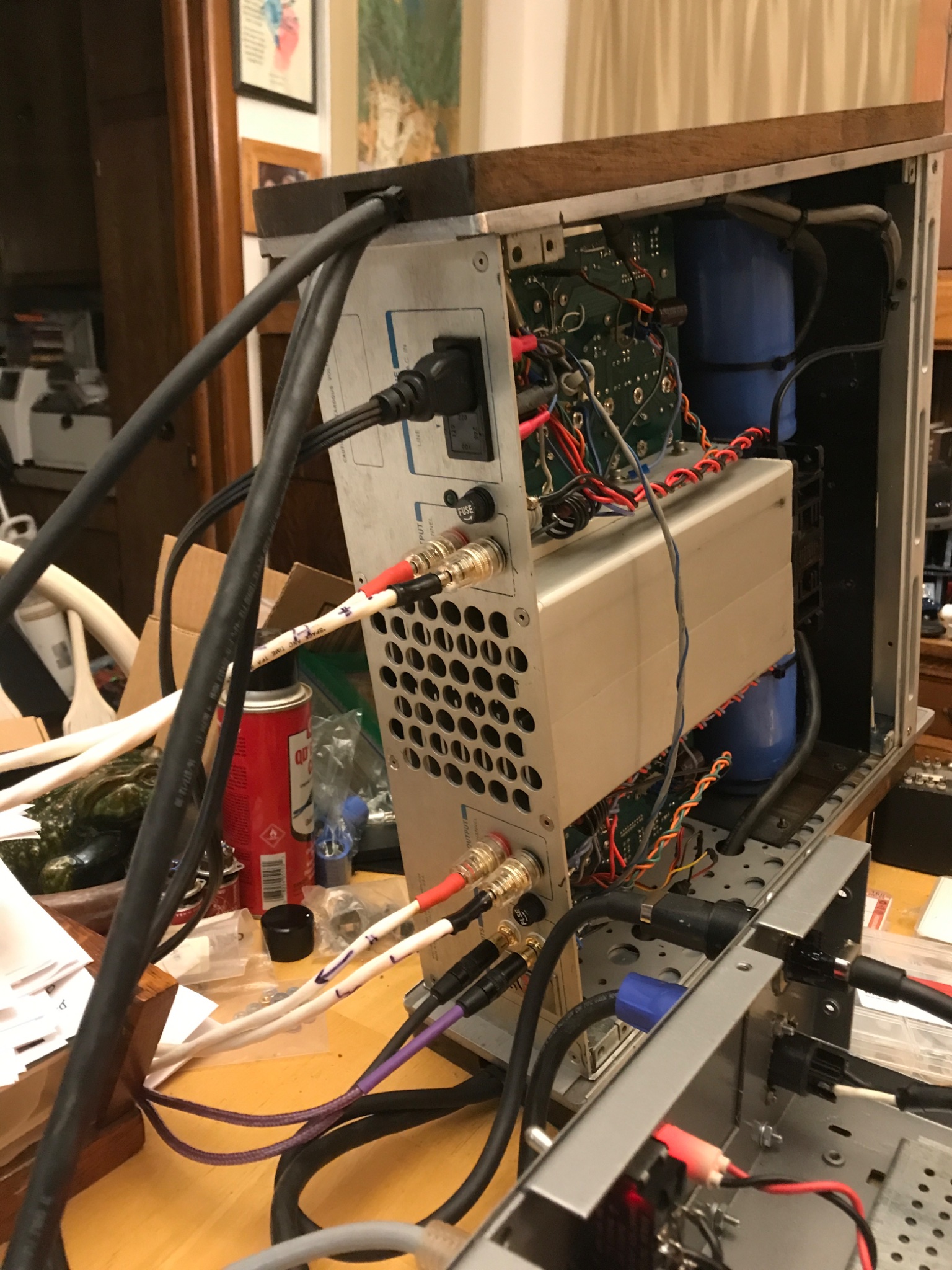

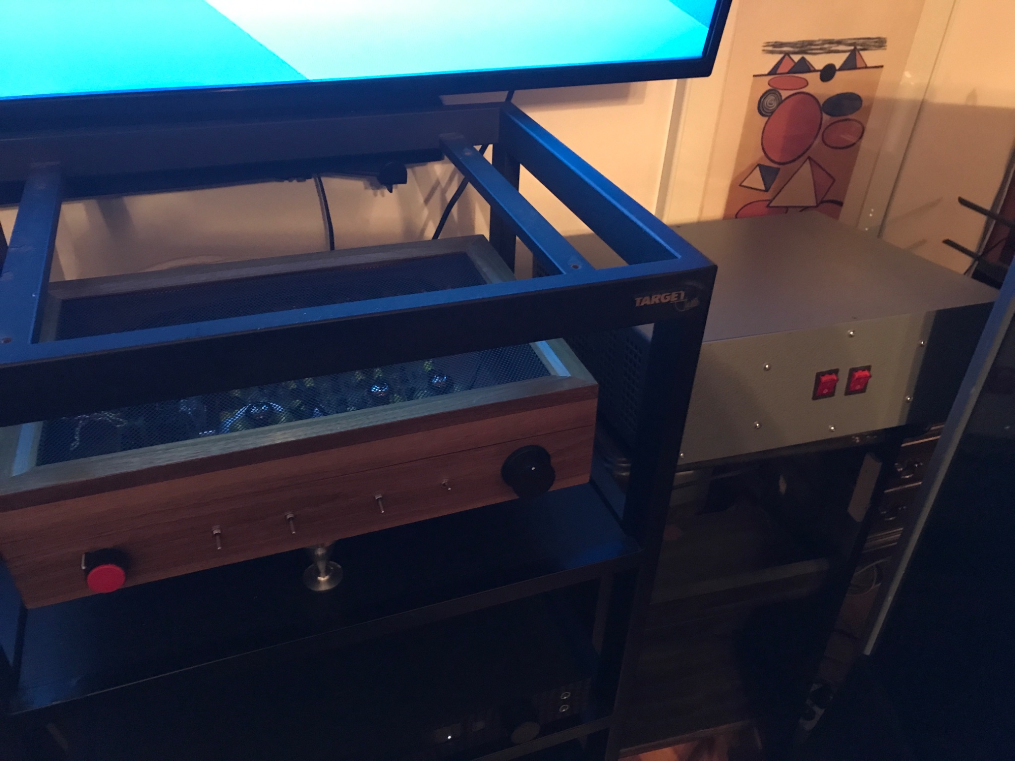

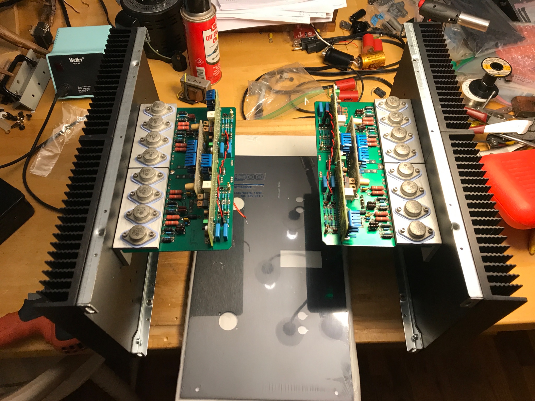

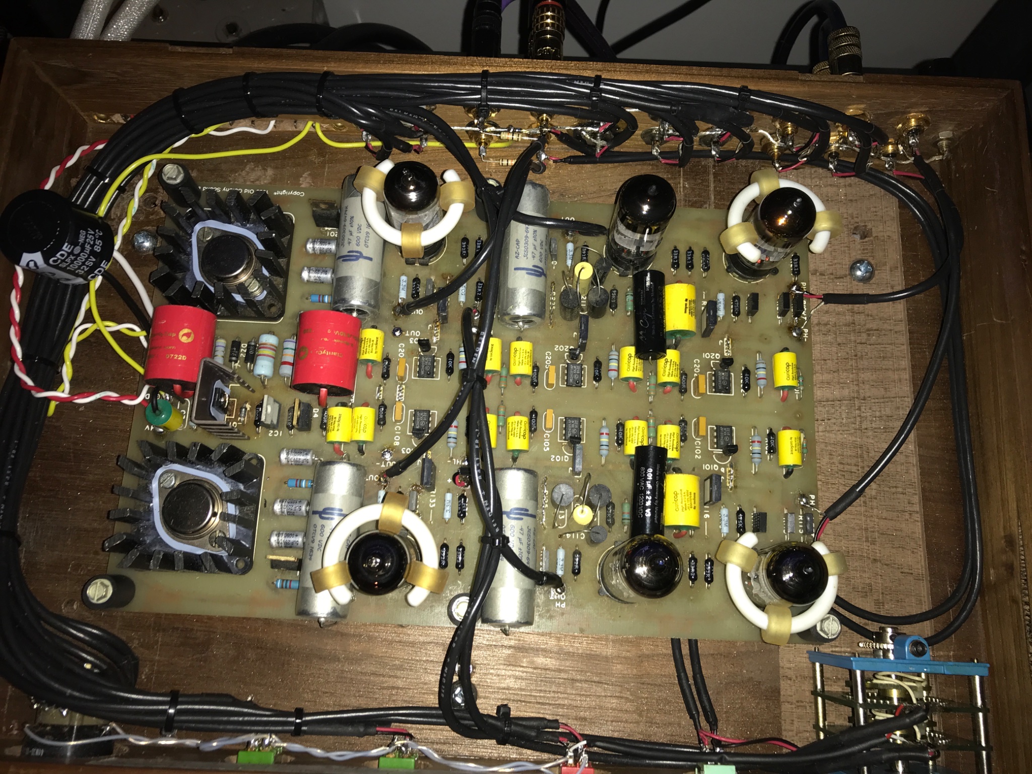

Hi,just finished my latest project,any help on the waiting Spectral project would be great…
I have ordered stick on graphics,the preamp is a resurrected Curcio Daniel 6dj8 preamp,sounds great……

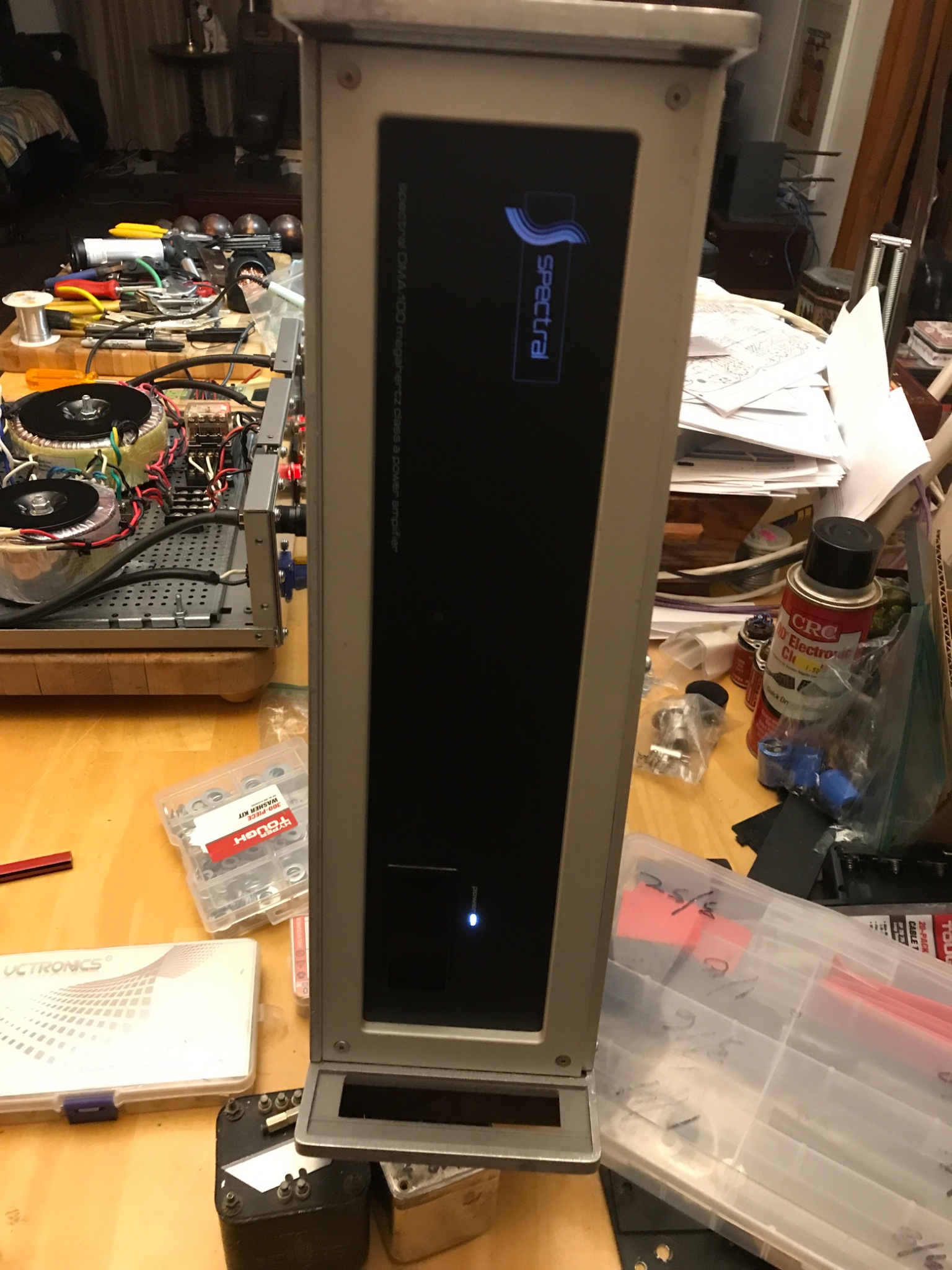

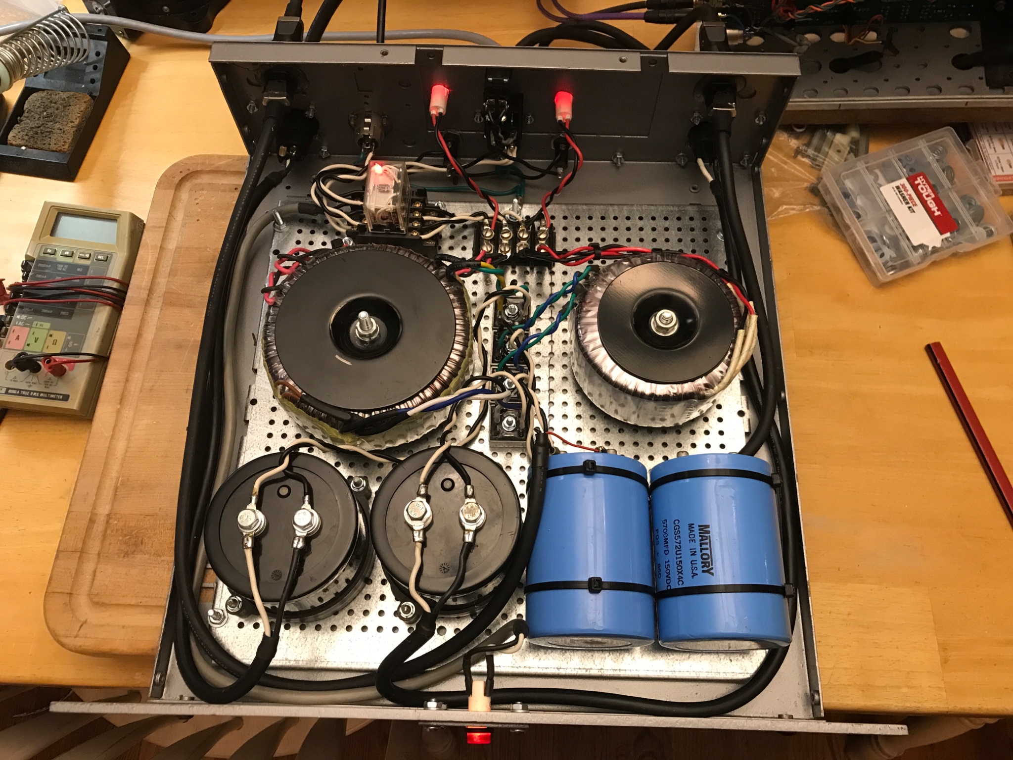

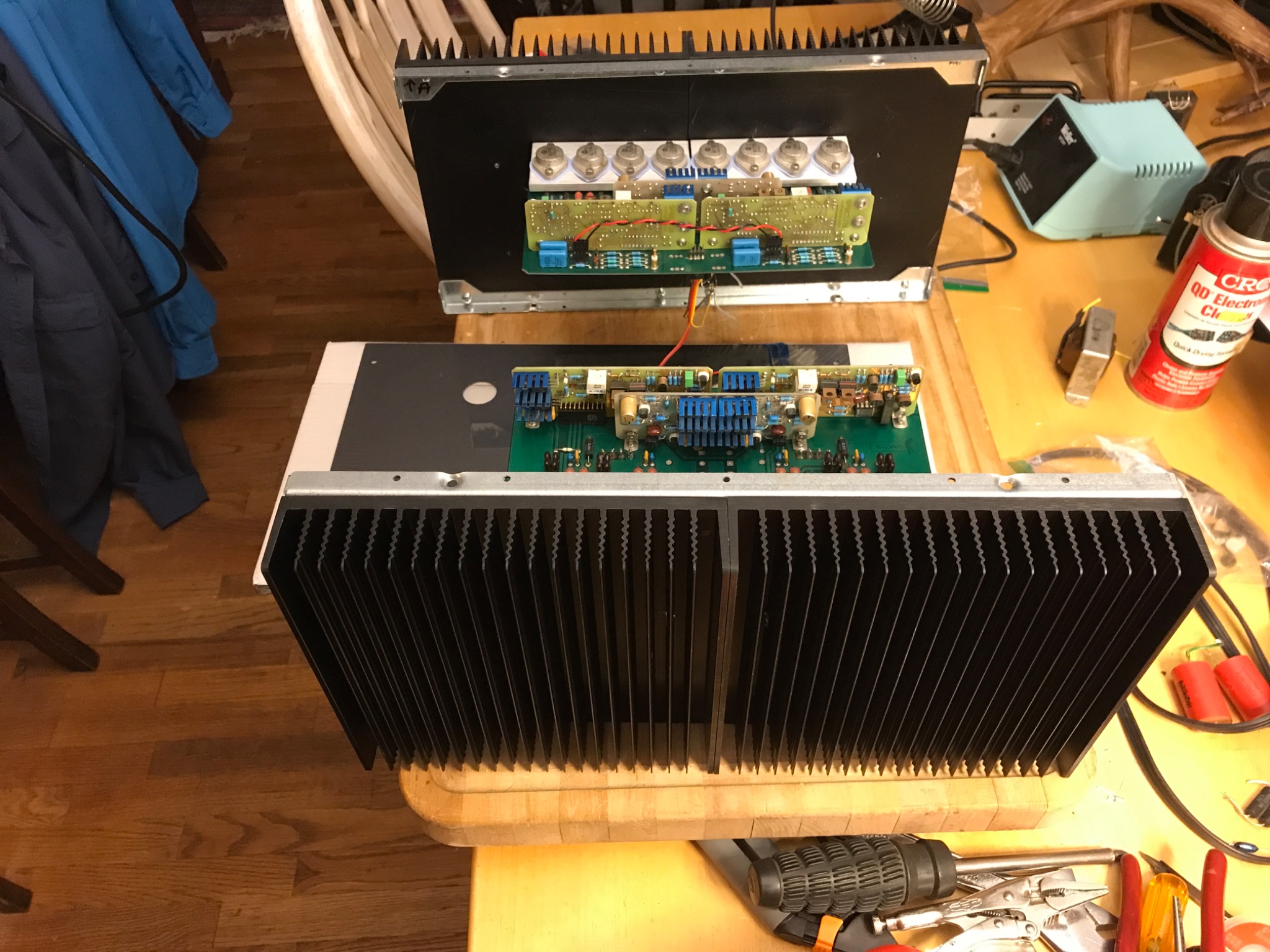

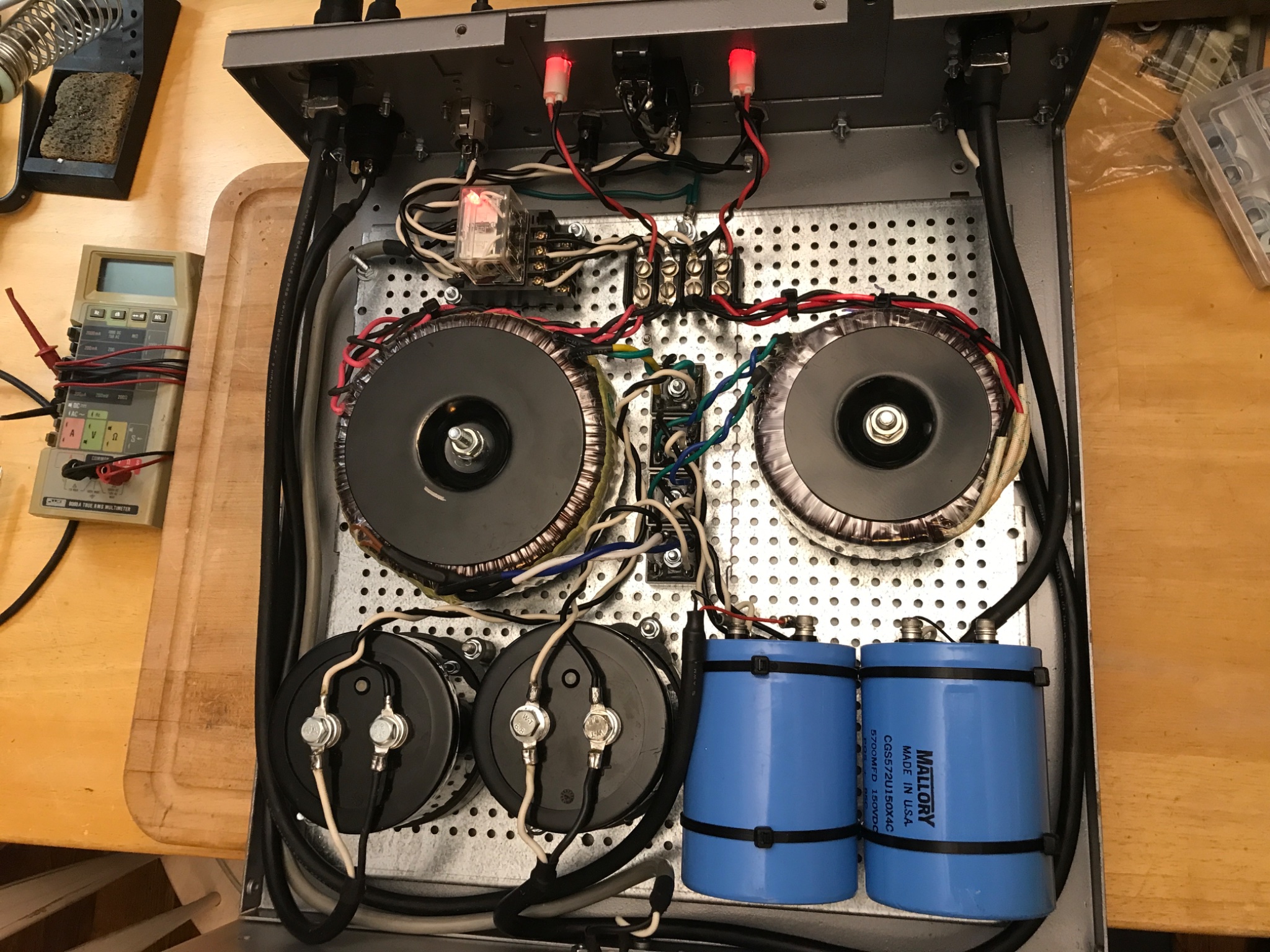

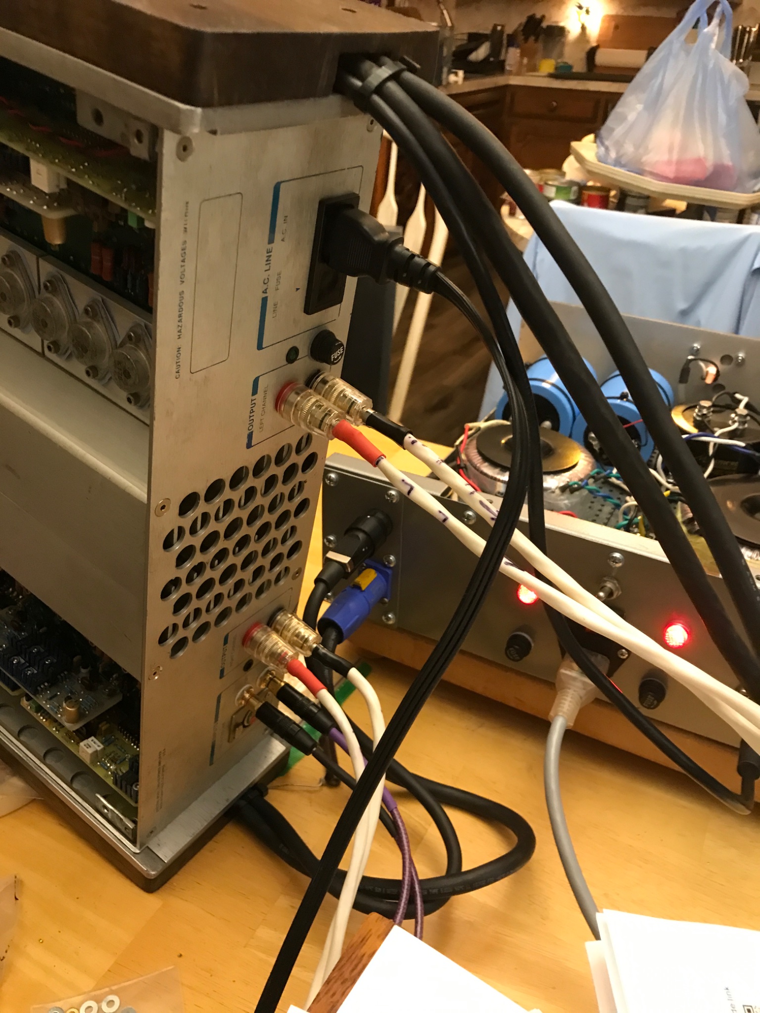

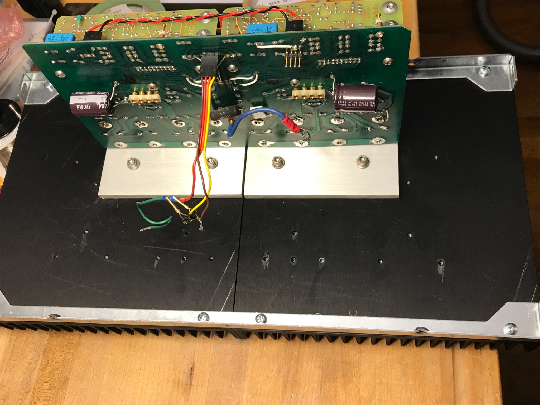

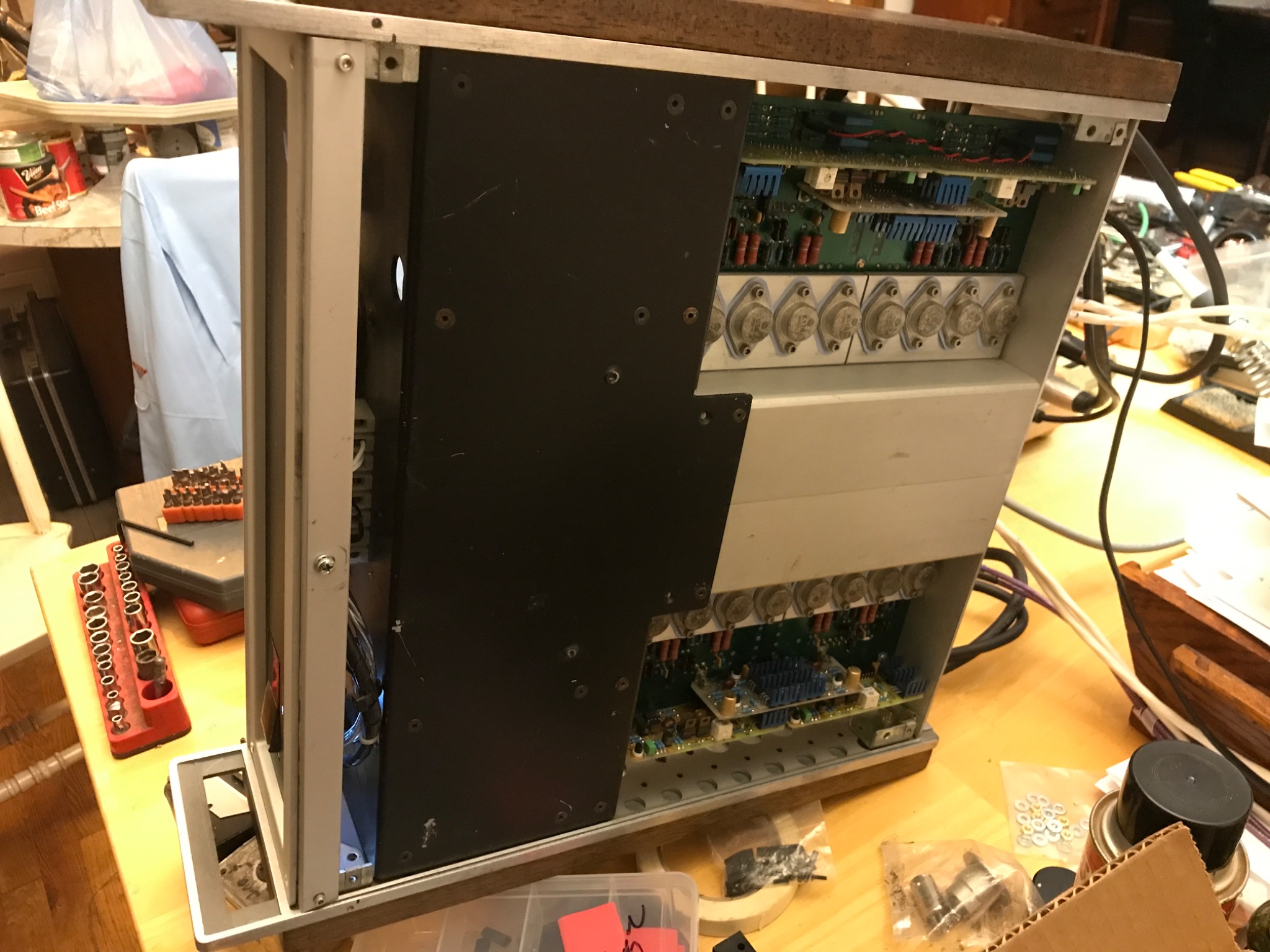

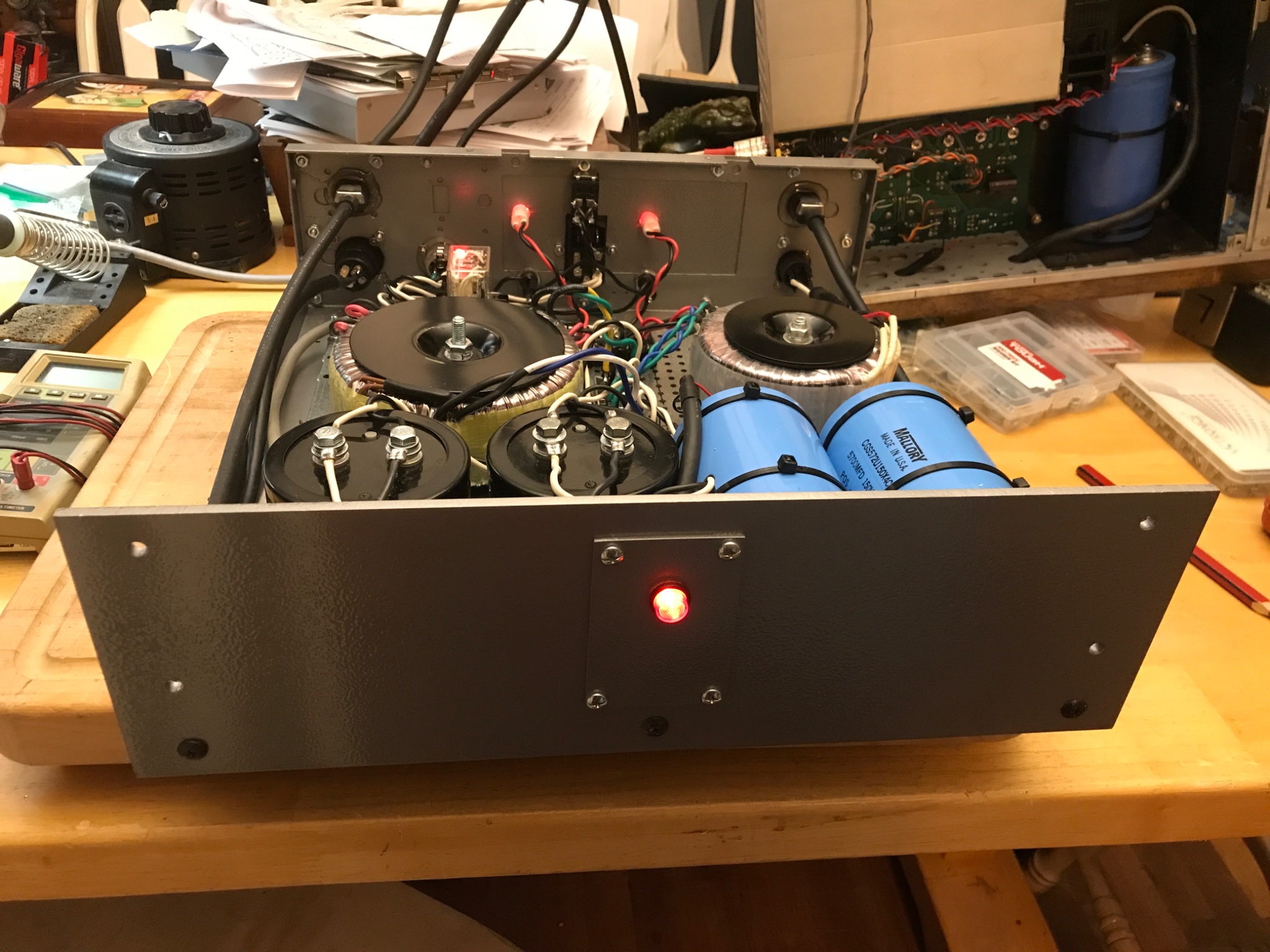

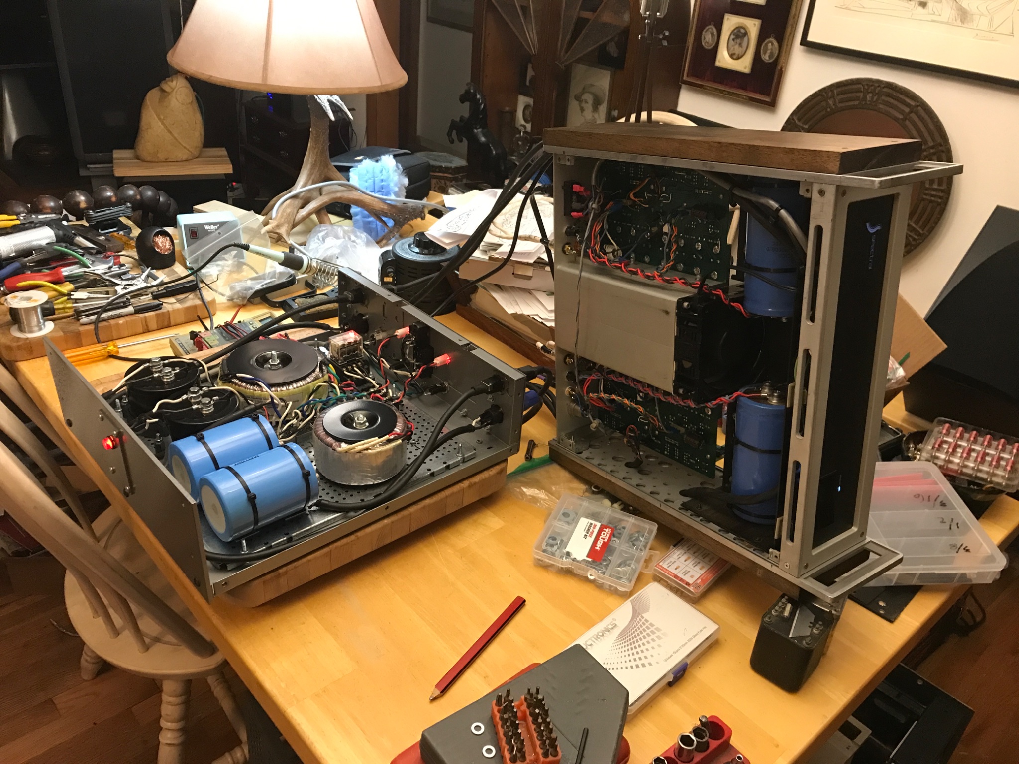

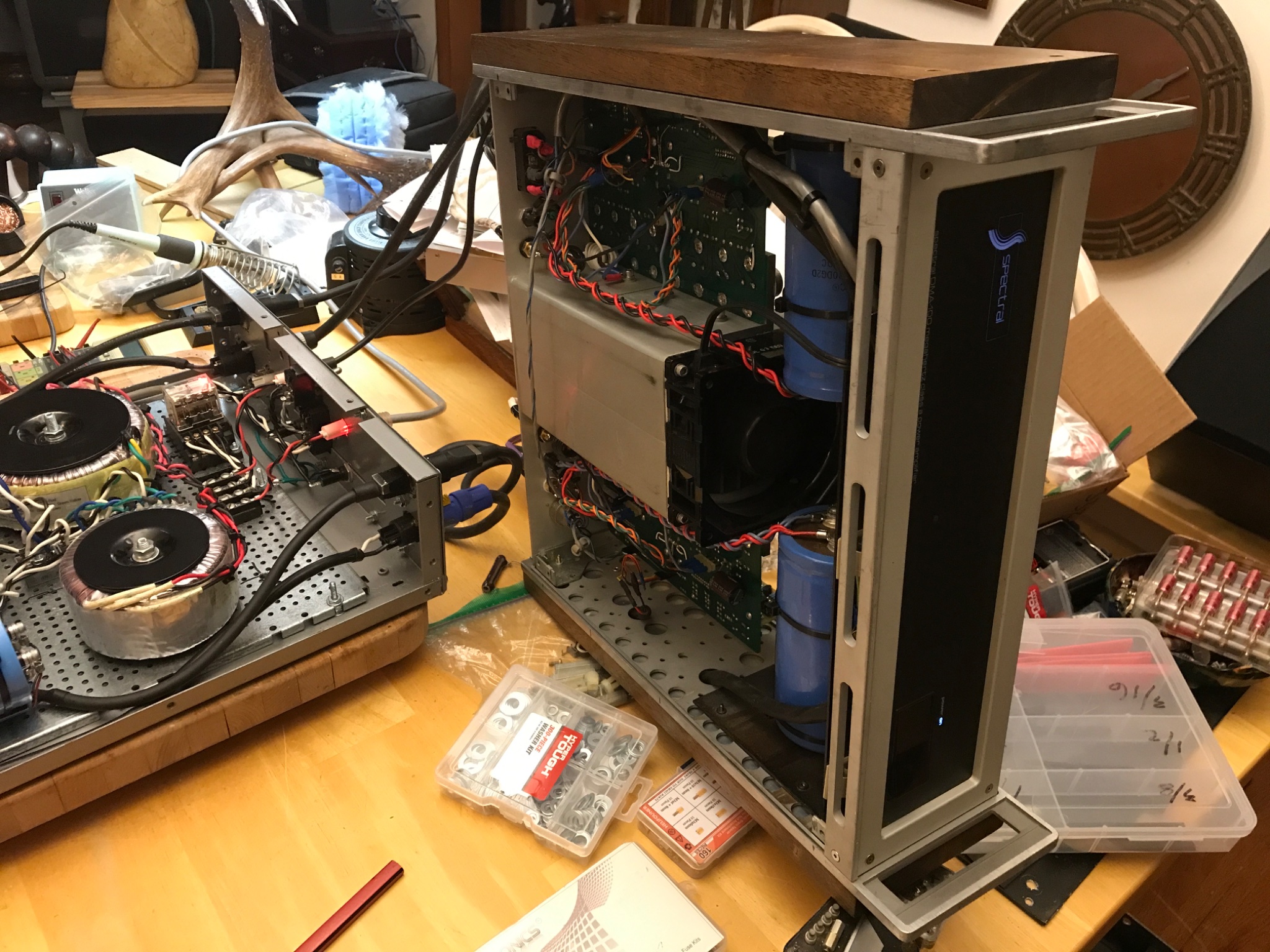

Finished Spectral DMA 100 yesterday,burnin on bench for a few hours…..

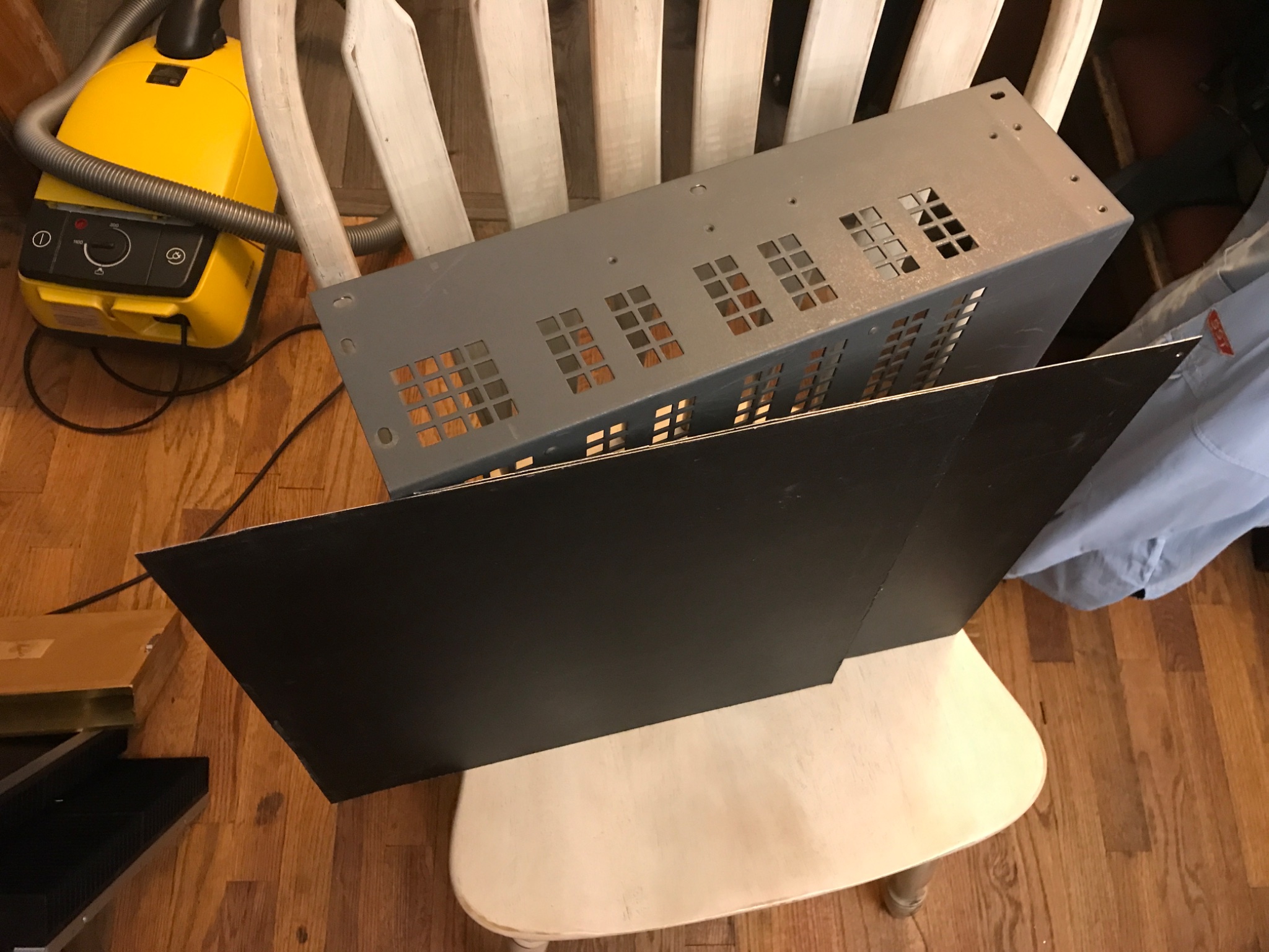

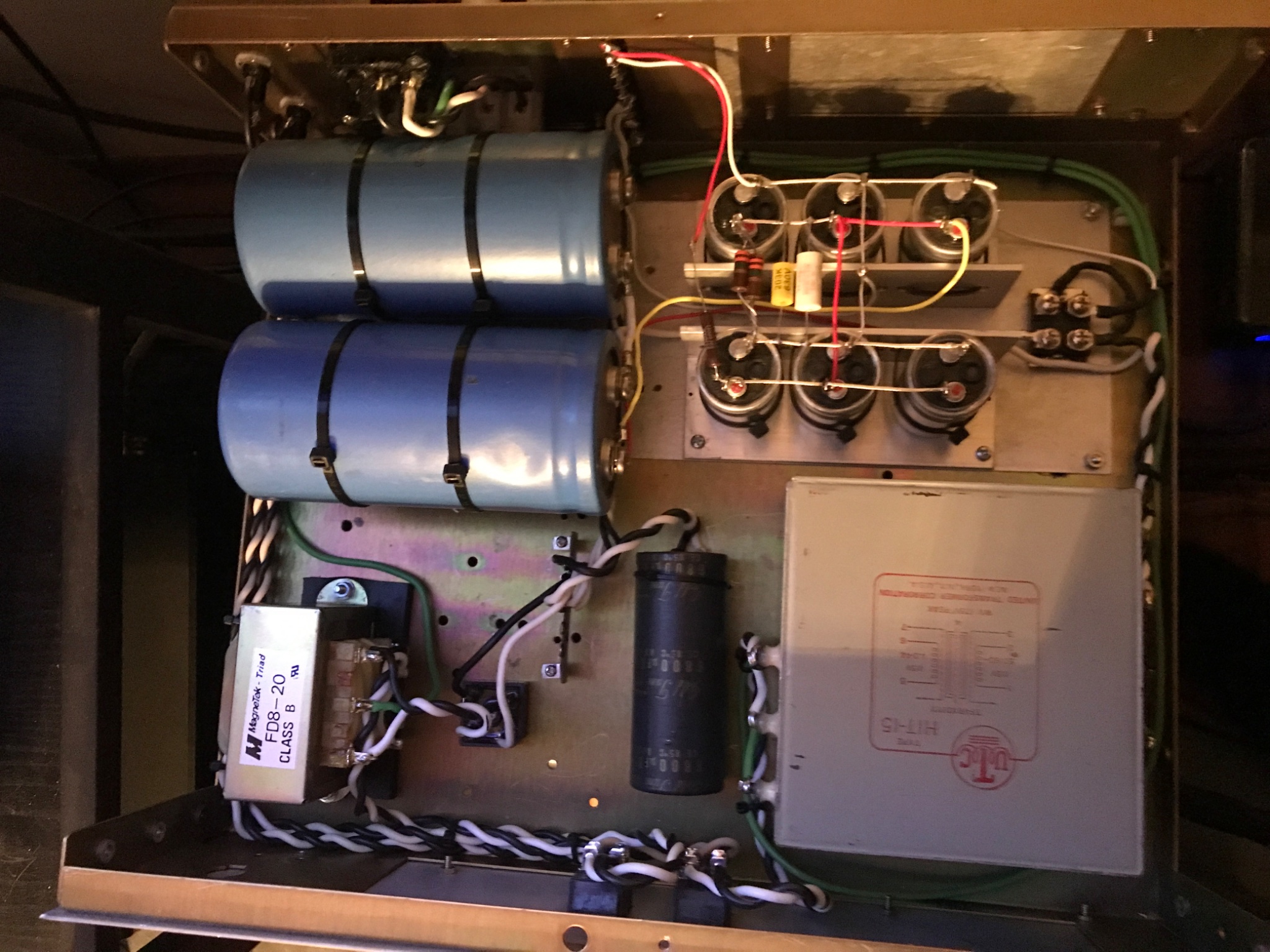

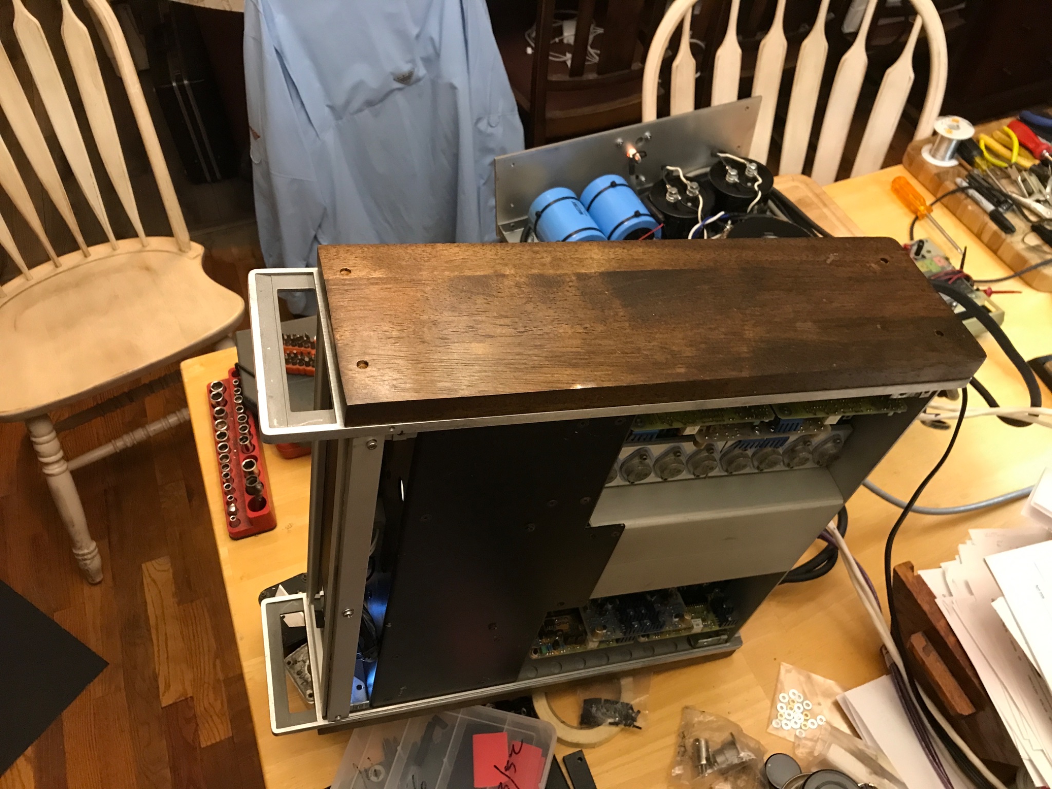

The covers for amp and power supply….
This Spectral amp is already a winner..dead quiet,dynamic,musical to a fault…been listening from a distance,has qualities that astound me…😳
Has to still prove to me reliability before I install in main system,driven presently direct by a Roon Transporter endpoint through cheap *** Pioneer bookshelf speakers…all I can say is I’m shaking my head at the musicality of this amp…..

I finally got a chance to review the schematics posted above. They are close but not quite there. The corrected file shows how the output circuits are connected. Zener diodes are used as current limiters on the outputs. We tested them in production by shorting the output at full level. The circuit was set up to use Jfets as cascodes but the mosfets work better and don't need biasing, shown in DMA 50 driver revised. The 3V threshold works well with the low noise Jfet front end which should run at 10 mA (2X J511). Current diodes were once $.50. No more. The diodes on Q4 and Q10 are Baker clamps that prevent the transistors from hard saturation so it recovers from clipping instantly.
