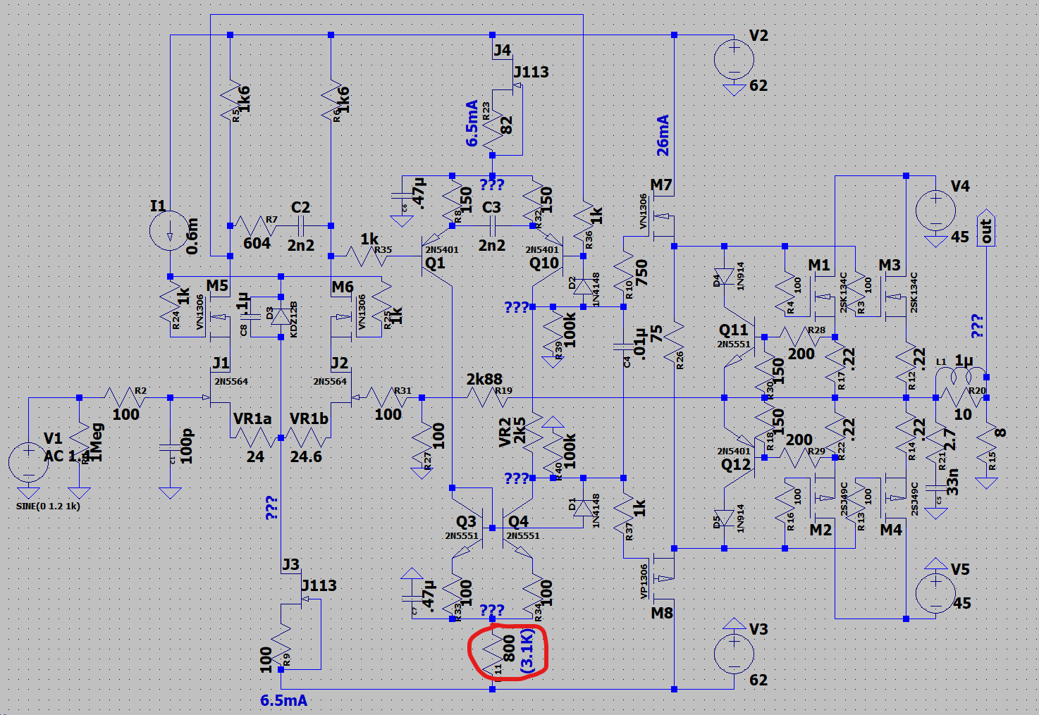

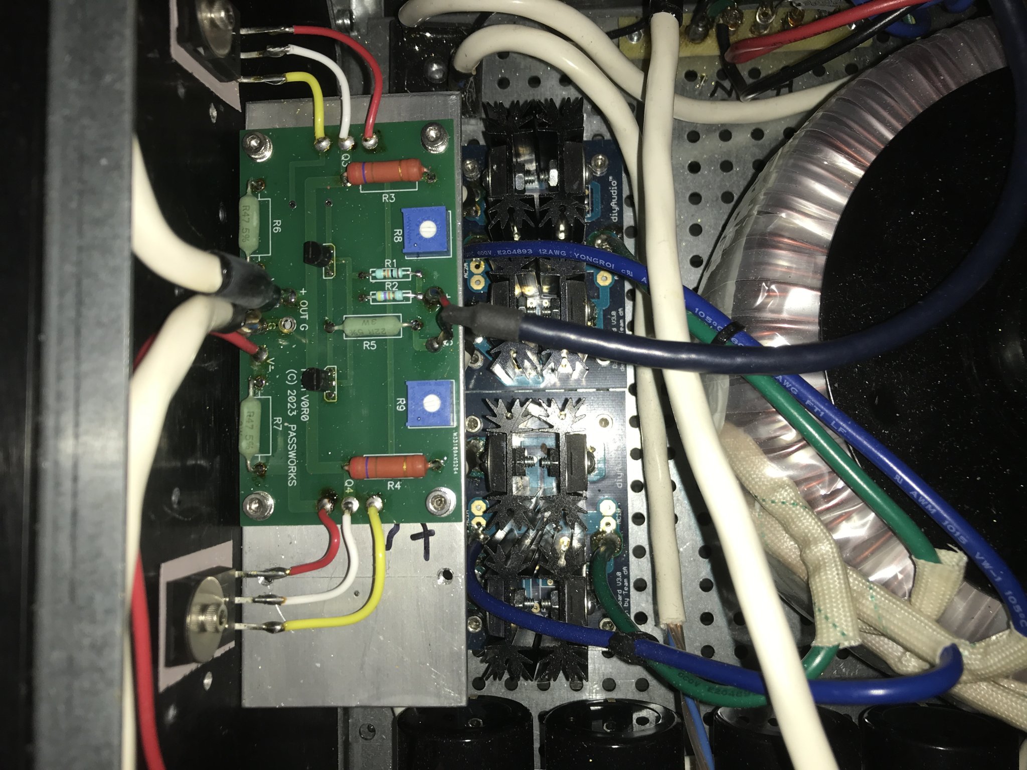

Demian:
Thanks for sharing this.

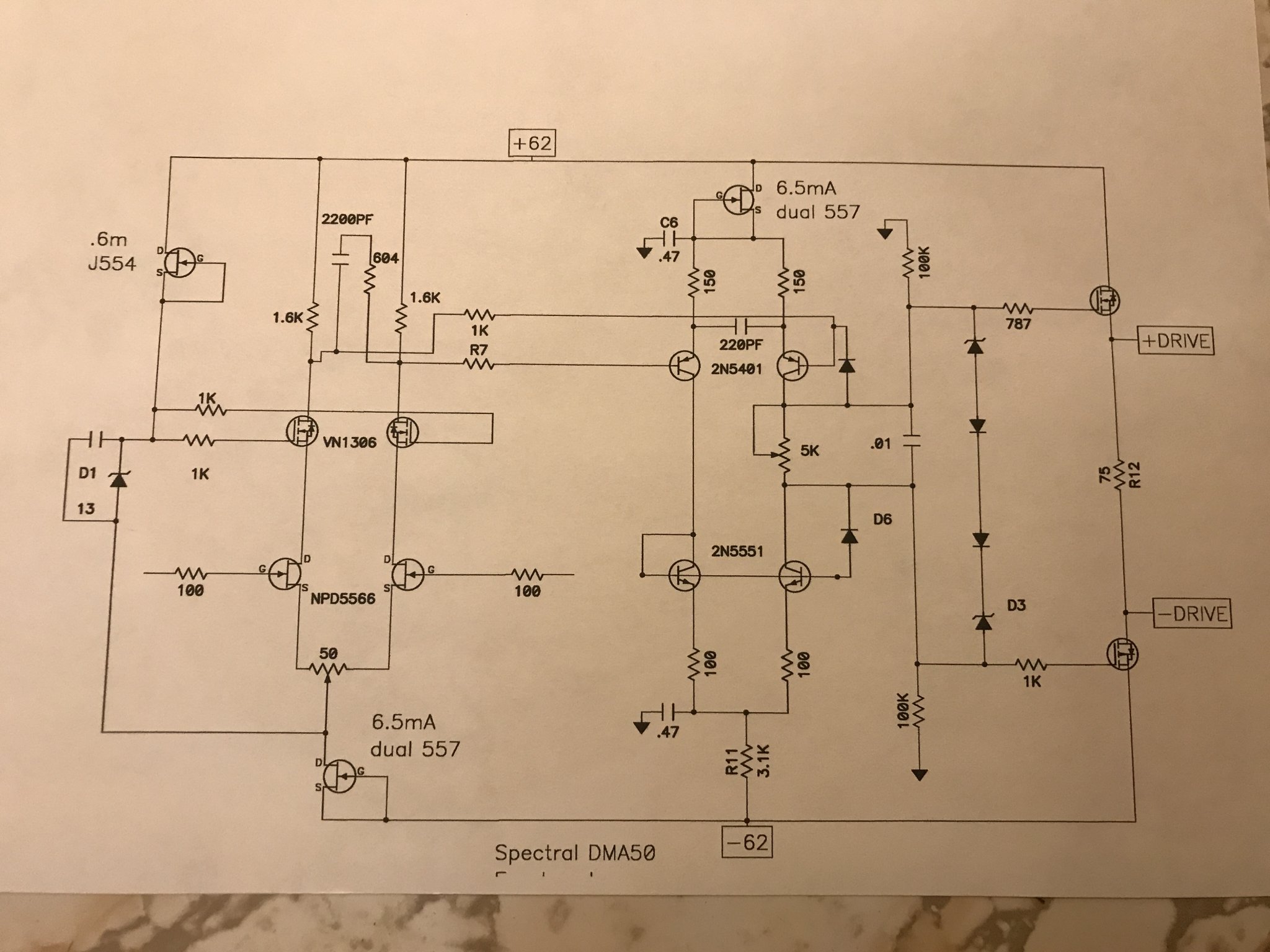

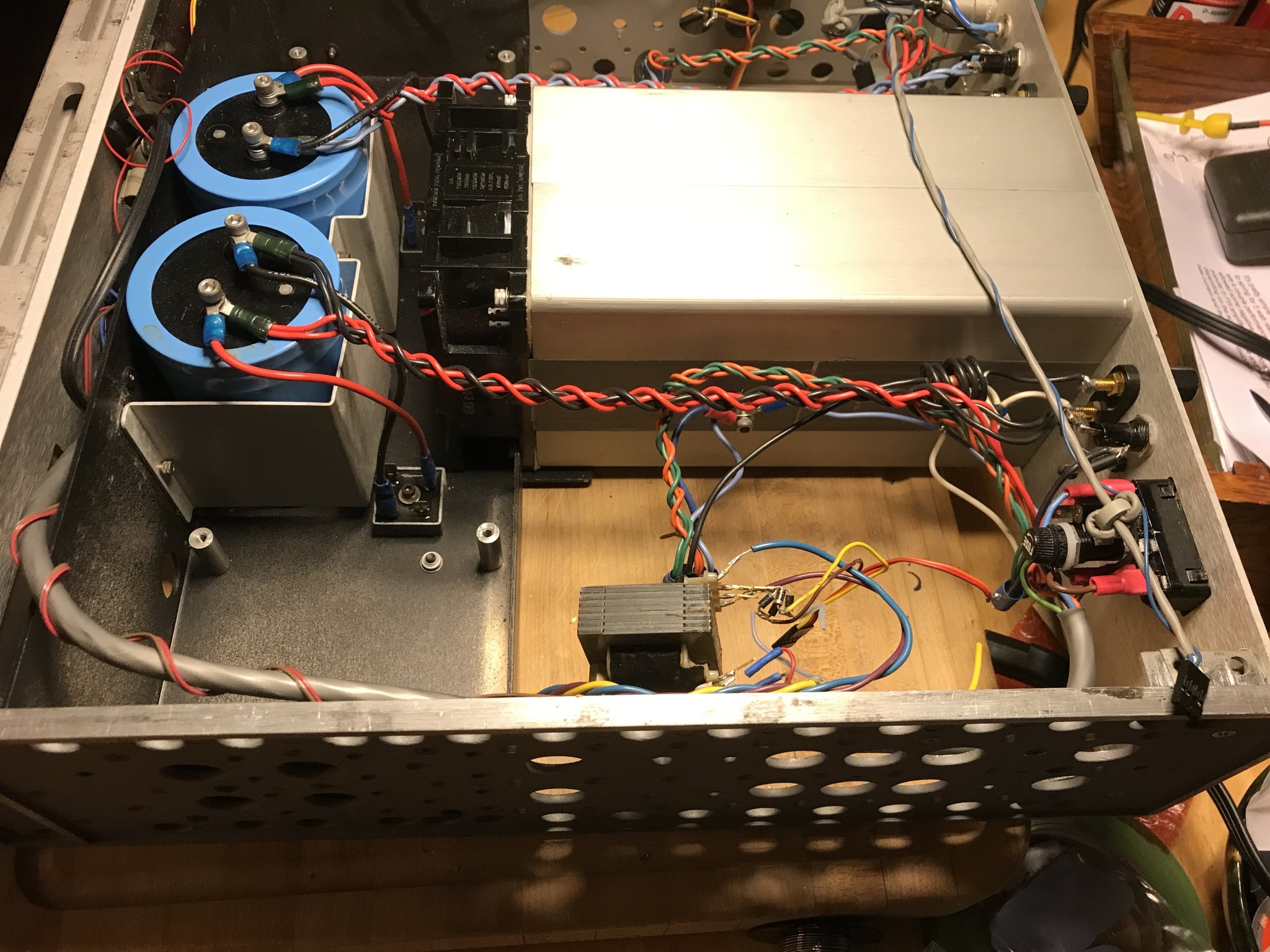

I'm curious - I didn't think those old Supertex VN1306 were Depletion Mode MOSFETs. Assuming they really are not, how does the front-end diff amp in the "DMA-50 driver revised" bias up properly? I would have expected some high IDSS JFET like a pair of J111 as cascodes instead for this kind of cascode configuration ...
Sorry about the oversight. I am using depleation mod gets now. I just sailed past that detail. I have not looked at this stuff closely since the 1990's. Fortunately my amp has been working fine since then.

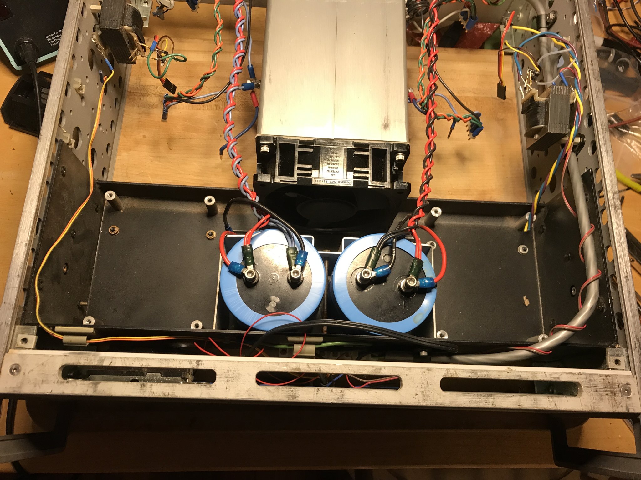

Thanks for the comments,yes the DMA 100 is amazing ……1 audio,if you could divulge a bit on the Crosby mods,can I do better?
Also,any way to find the front logo light array,it’s getting dimmer by the day…..Dave
You have the full Crosby mod. There are possibly other areas to tweak but not many and not much ROI for huge effort.
The Crosby mod started with the active regulator for the input/driver circuit. I believe there was also a seperate always on supply for the regulator. (There is in the DMA 50 mod) Then additional caps and component tweaks on the modules. Since it used very premium parts initially there is not a lot to upgrade.
The backlight is an electrolumincent panel. An LED backlight for a display would be the best modern option. This may be a "direct fit" option: https://www.adafruit.com/product/625

Thanks,do you have information to implement the always on regulator supply,as the driver / regulator power is switched on at the same time as the output power supply….

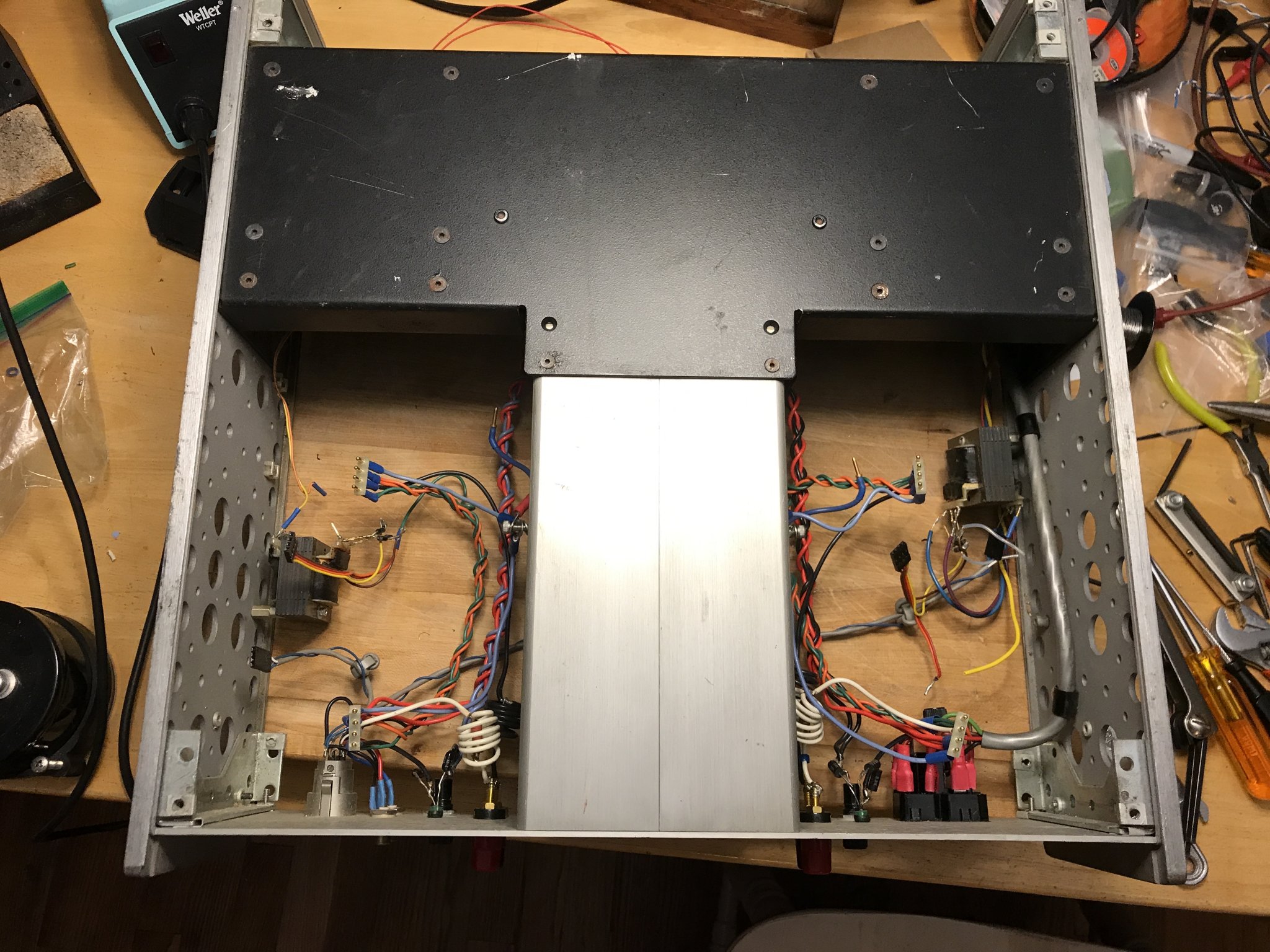

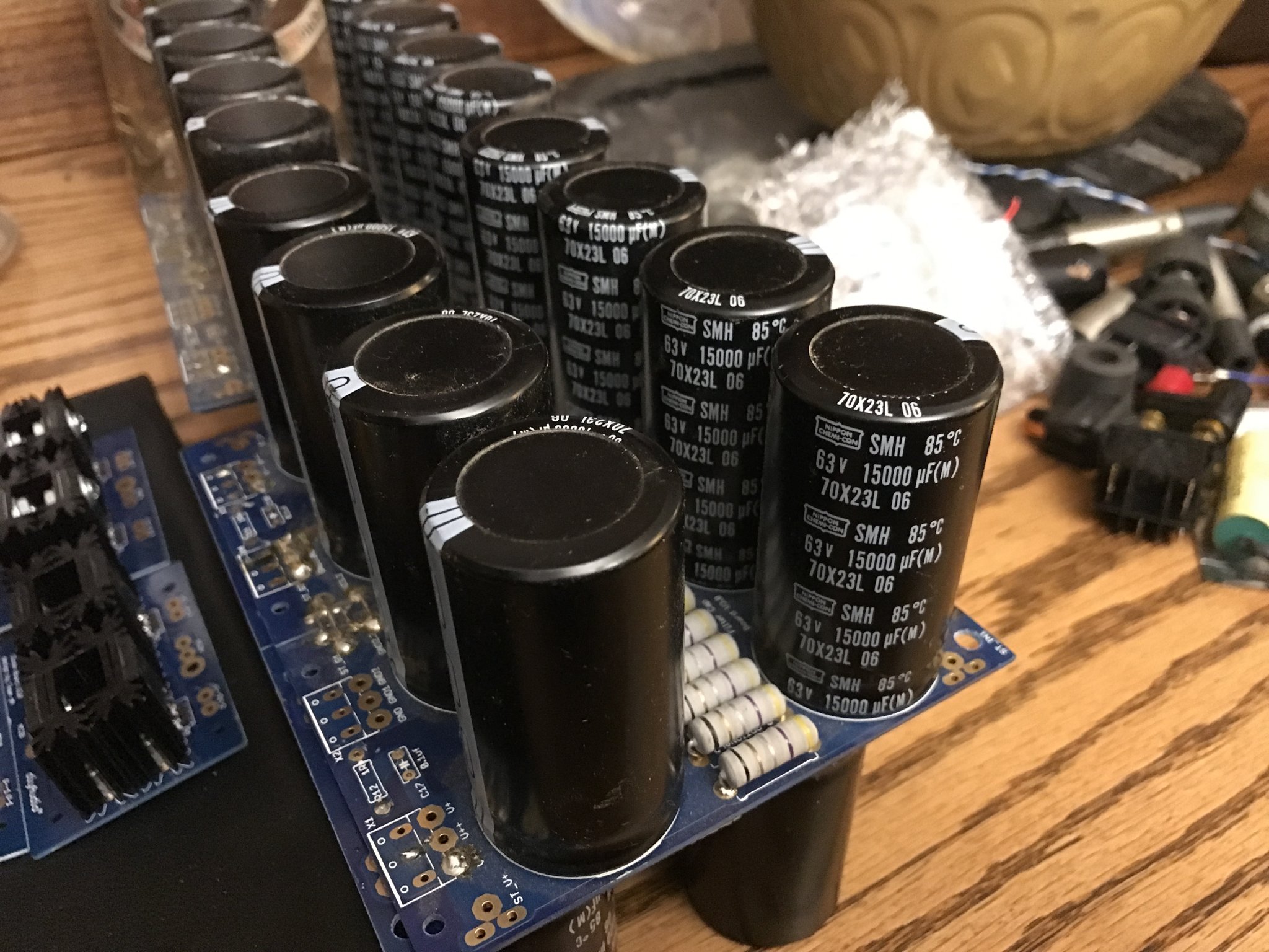

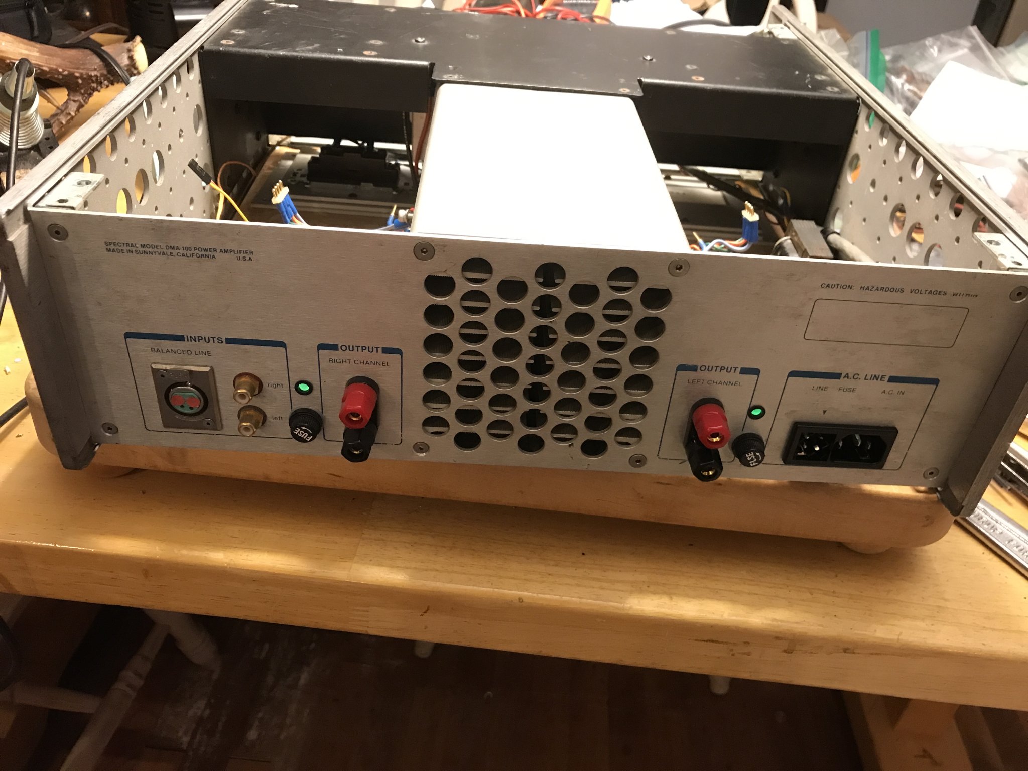

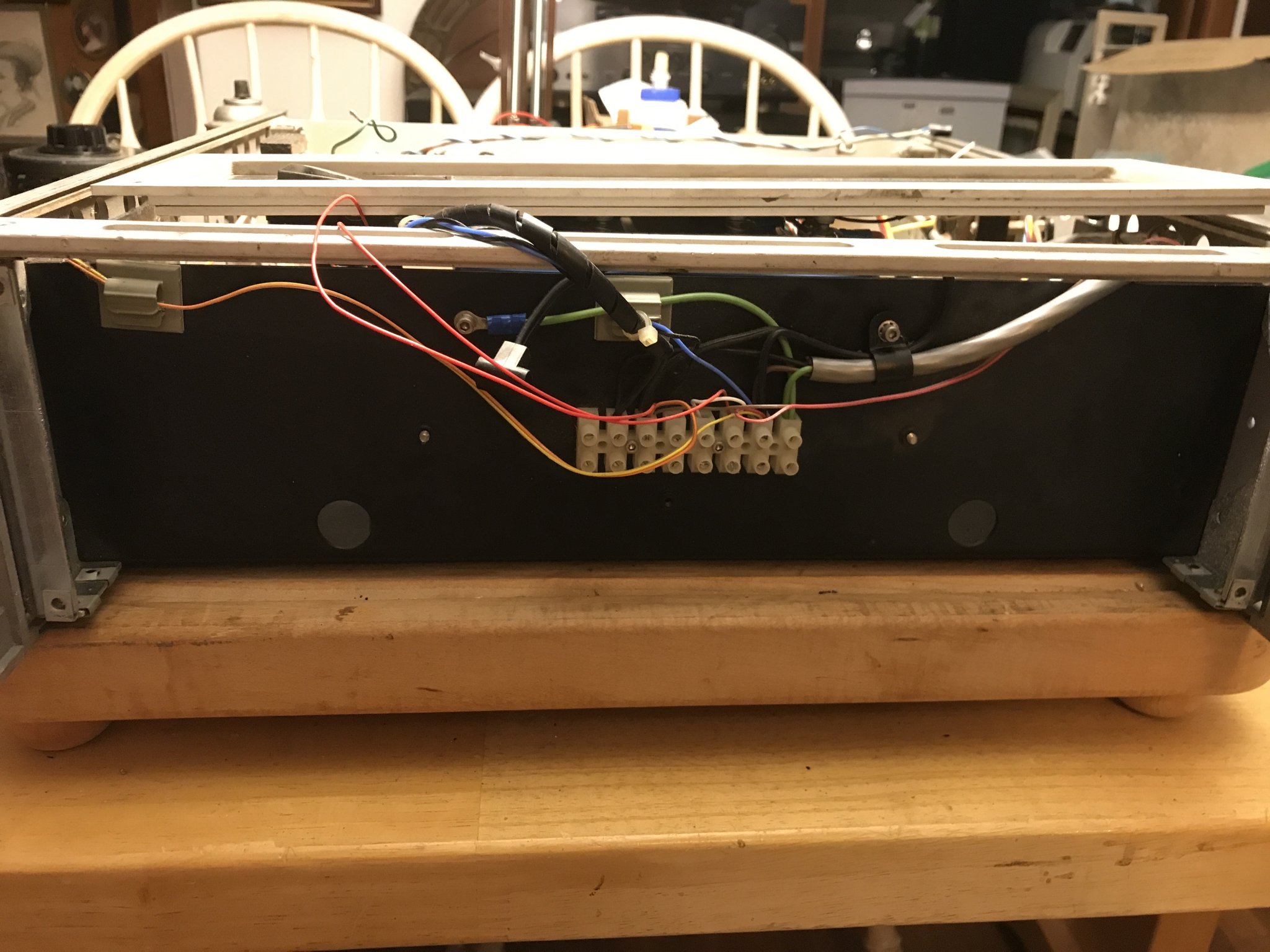

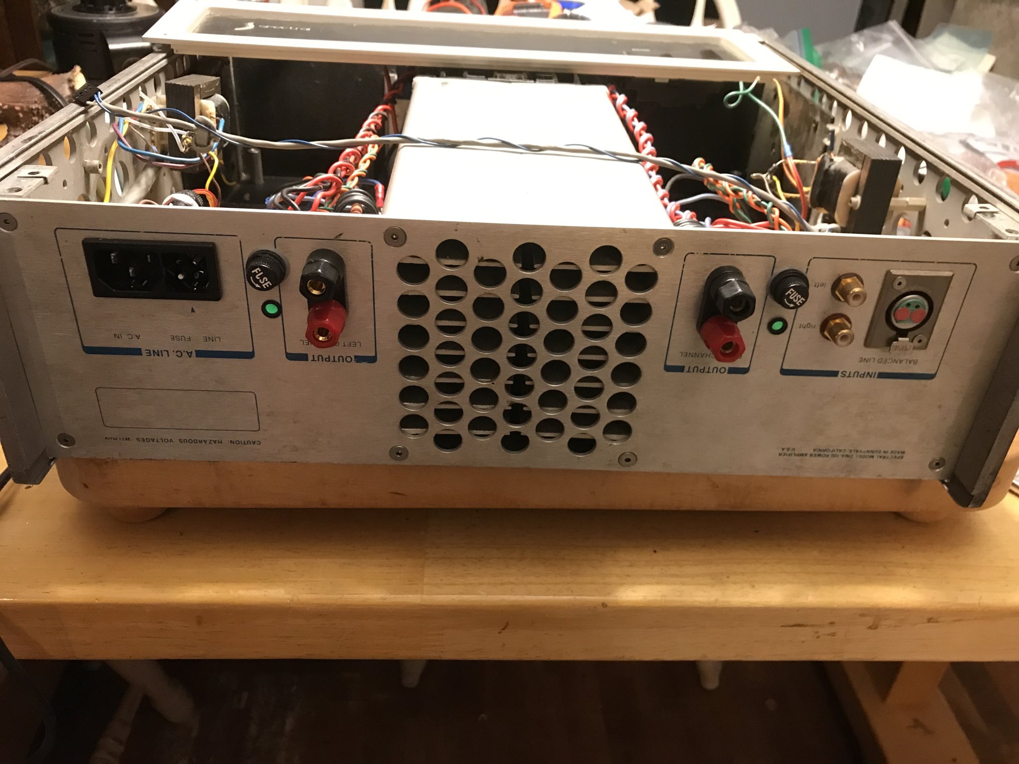

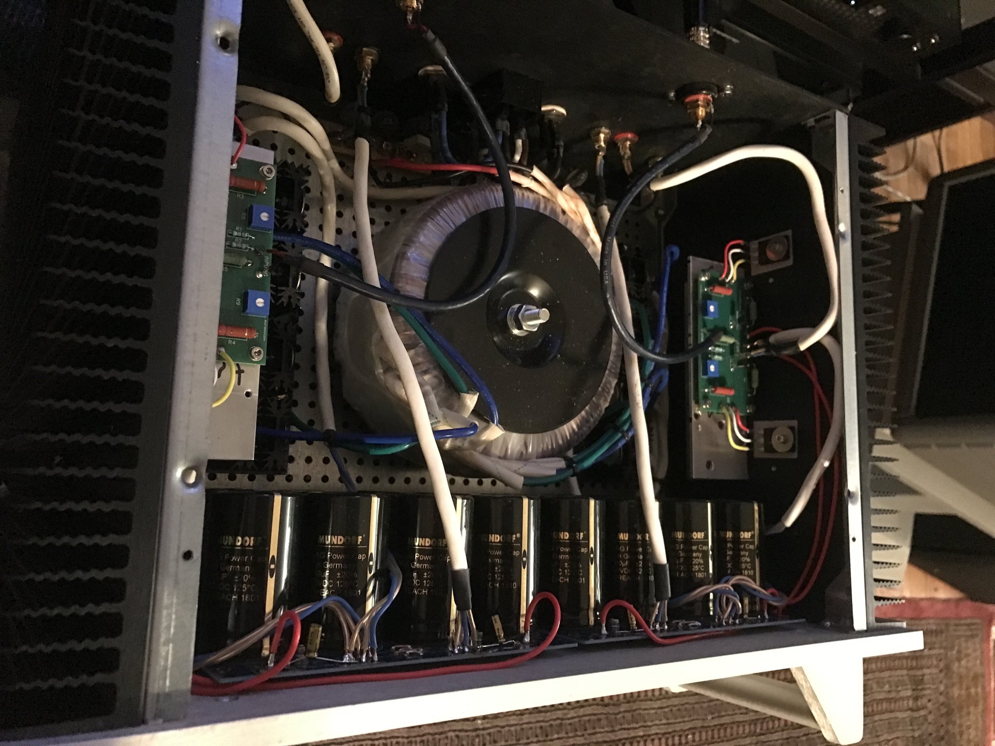

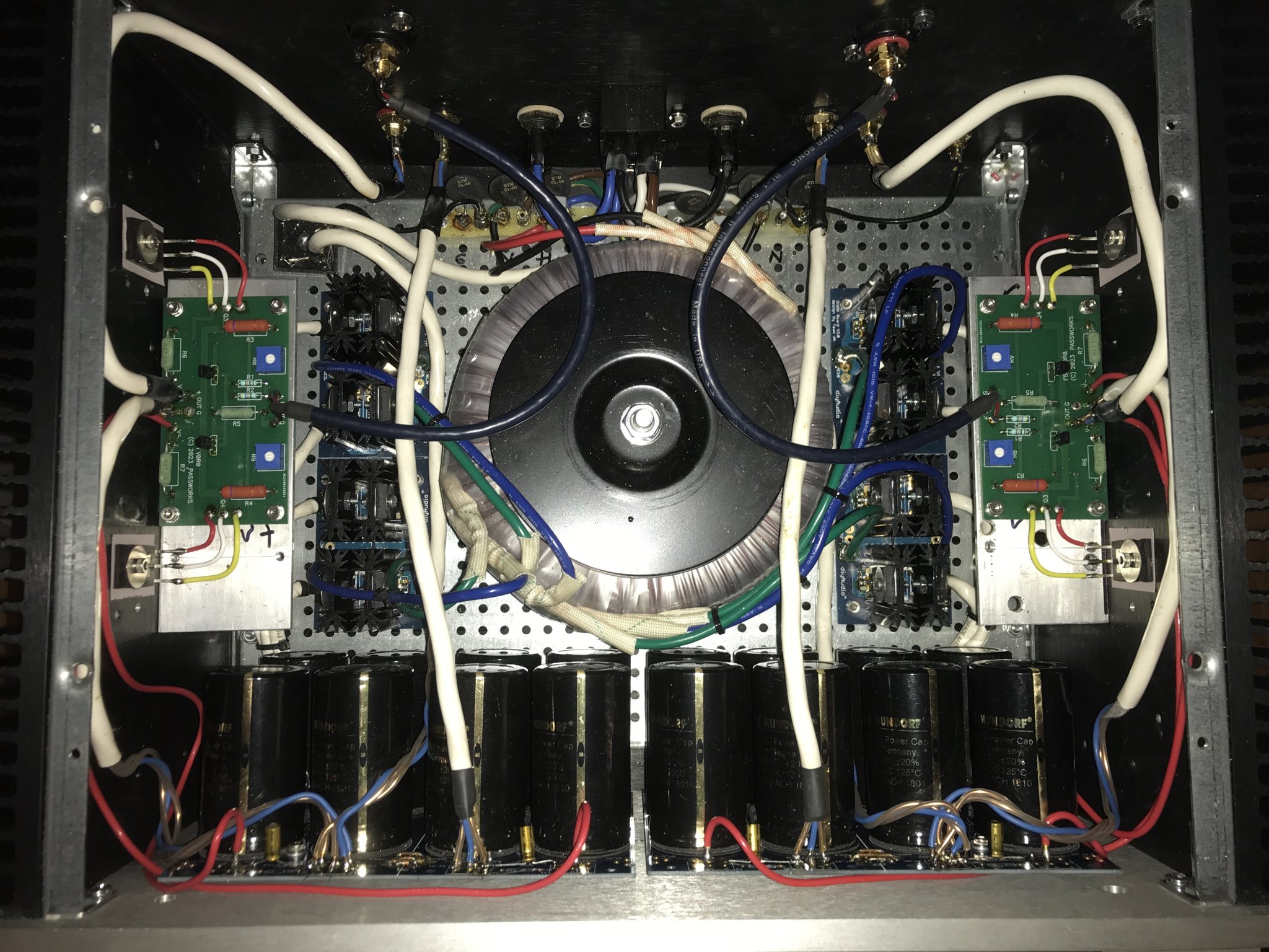

Hi,working on building up the spectral DMA power supply,do you have a figure for the max voltage to the output section….

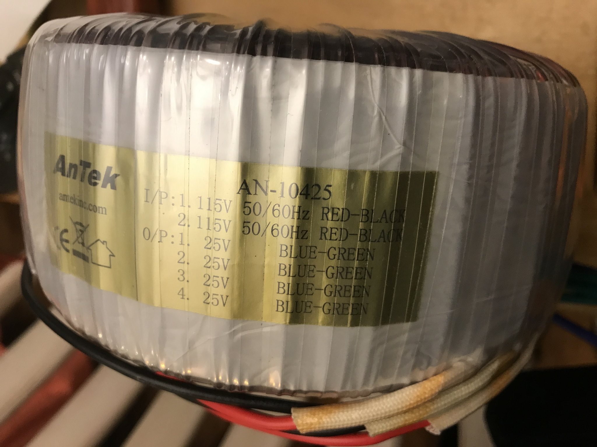

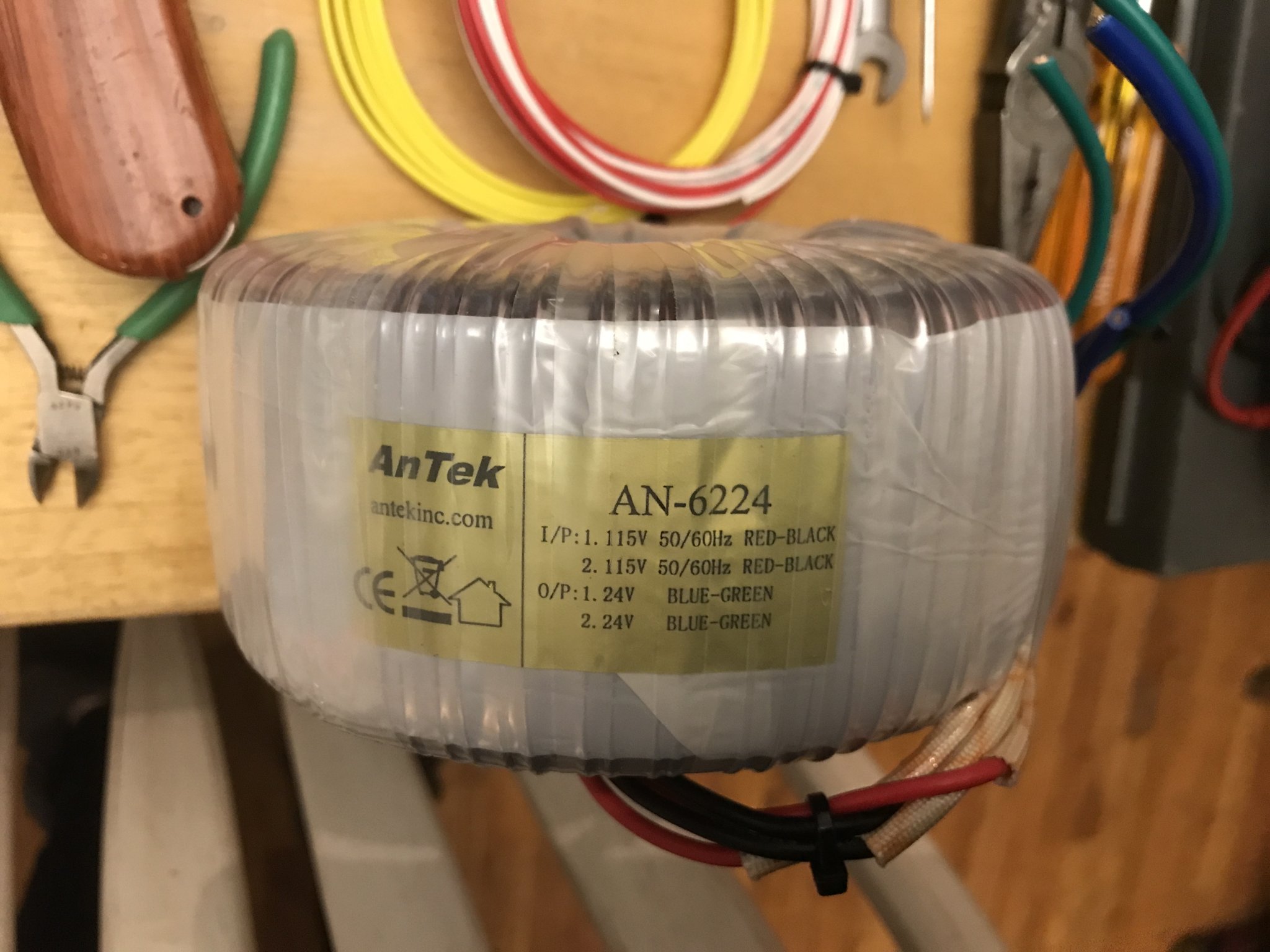

Currently running 48 vdc +/- …I have a pair of 1000va 25volt transformers,want to use them since it’s no money out,can the output section handle the increase….25 volt in series,50 volt,so,would be 68.7….you had referenced to 50 vdc for full output,48 vdc works fine though,but present supply is a single 500va transformer feeding both boards……
Hi,just finished finals on Spectral DMA 100….dual mono 300va’s at 62 vdc on drivers, dual mono on outputs,800 va’s at 50vdc,yowza great…..much better slam and definition,dead quiet still,much greater detail….im a happy camper!,
