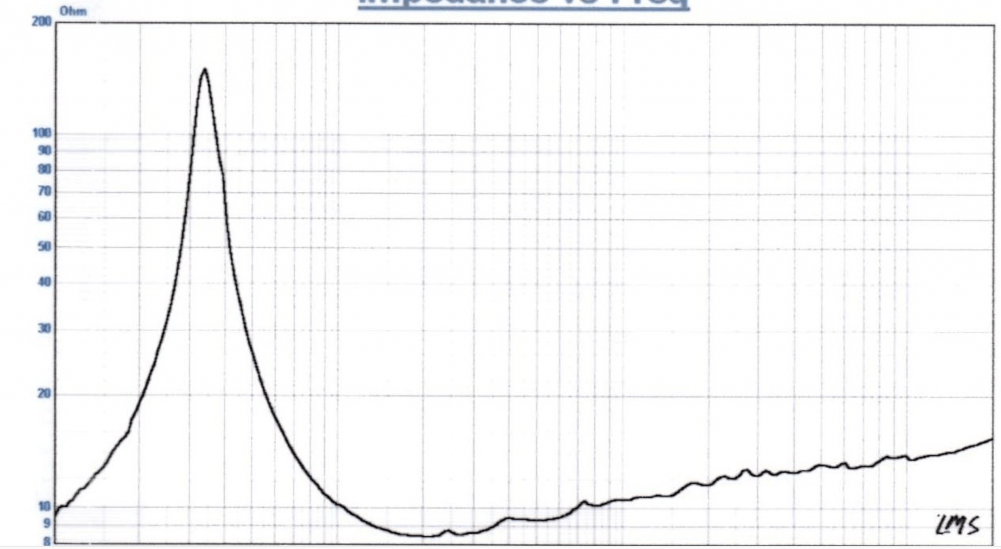

That is all that counts. Here is the factory impedance curve Ithe ones i made are more dramatic), but you will notice all the bumps in the curve above primary resonance. Each one of those is a cone resonance, and they drive my ear/brain crazy. I have measured thousands of drivers and most have a smooth curve above resonance, with only the piston to chaotic radiation, and an occasional one if the driver has a HF resonance (common amoung FRs)
