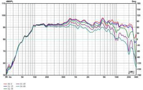

The lowest notes on a typical small church organ are at 32 Hz. Larger ones can go lower to 16 Hz. I am not naive about the fact that a full-range driver probably will not have response down that low, but where do these cabinets for the various MarkAudio or Seas cabinets tune. Sometimes the cabinets show the tuned frequency but sometimes not. For example, the Super and standard Pensil.
I did some quick bass-reflex calculations for the Seas driver, and with a flat alignment SBB4 I got roughly 46 Hz tuning in about 2.6 cu ft. That certainly will cover the top part of the lowest octave so I know that I cannot really get all the way there without another radiator.
However, most music doesn't go that low. Are these loaded cabinets with the 10p or 12p, or Seas capable of sufficient bass. For example the lowest note on an electric quitar is E1 approx 41.2 Hz. I can just use other speakers/headphone for my full-range music if needed.
I have calculated a QB3 alignment and the bass-reflex tuning would be several Hz higher.
So, the choice is to just plan on a low sub and use the full-range for everything else, or make sure the full range cabinet goes as low as possible with a given driver and live with it.
Thoughts?

Except for the smaller standmounts, yes. FHXL (A10p) wil get you into the low-mid 30s, i expect Joan (A12pw/CHN110 is similar. Woden TLwith A12pw gets closer to the mid 20s.
I don’t know about reflex loading the FA22. If i can get away with sealed (rarely) i like doing that.
If you want to ge to under 20 hz, it will take dedicated woofers. It is typically not cheap.
