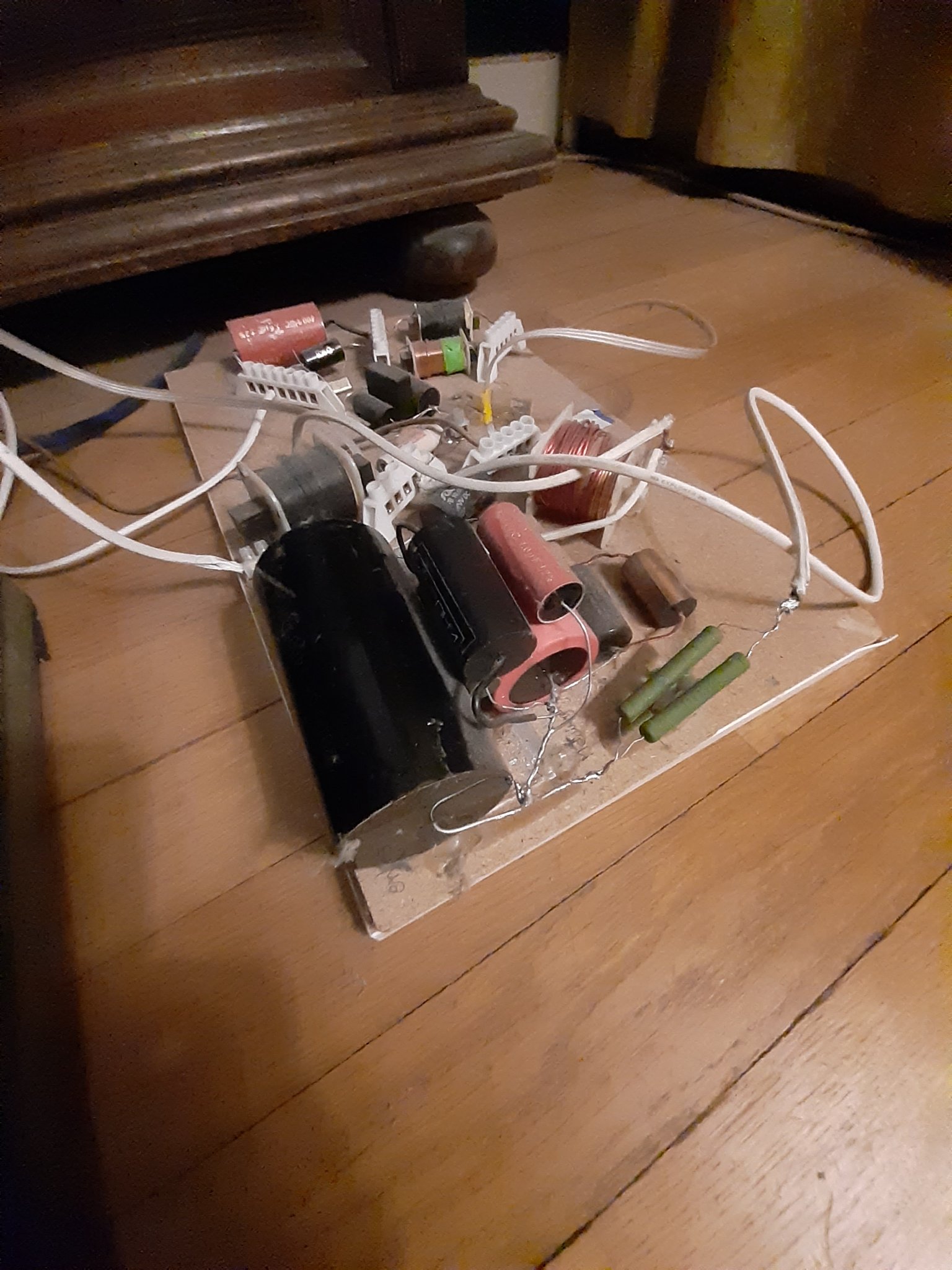

Exactly. Clip leads, especially the cheap chinese ones, have a considerably high resistance, and if you´re using quite a handful of them in a quick XO mock-up, they can quickly screw up what you´re doing.
Of course it´s more work, but despite the fact that I have plenty of them, I try to avoid use of clip leads whenever possible.
