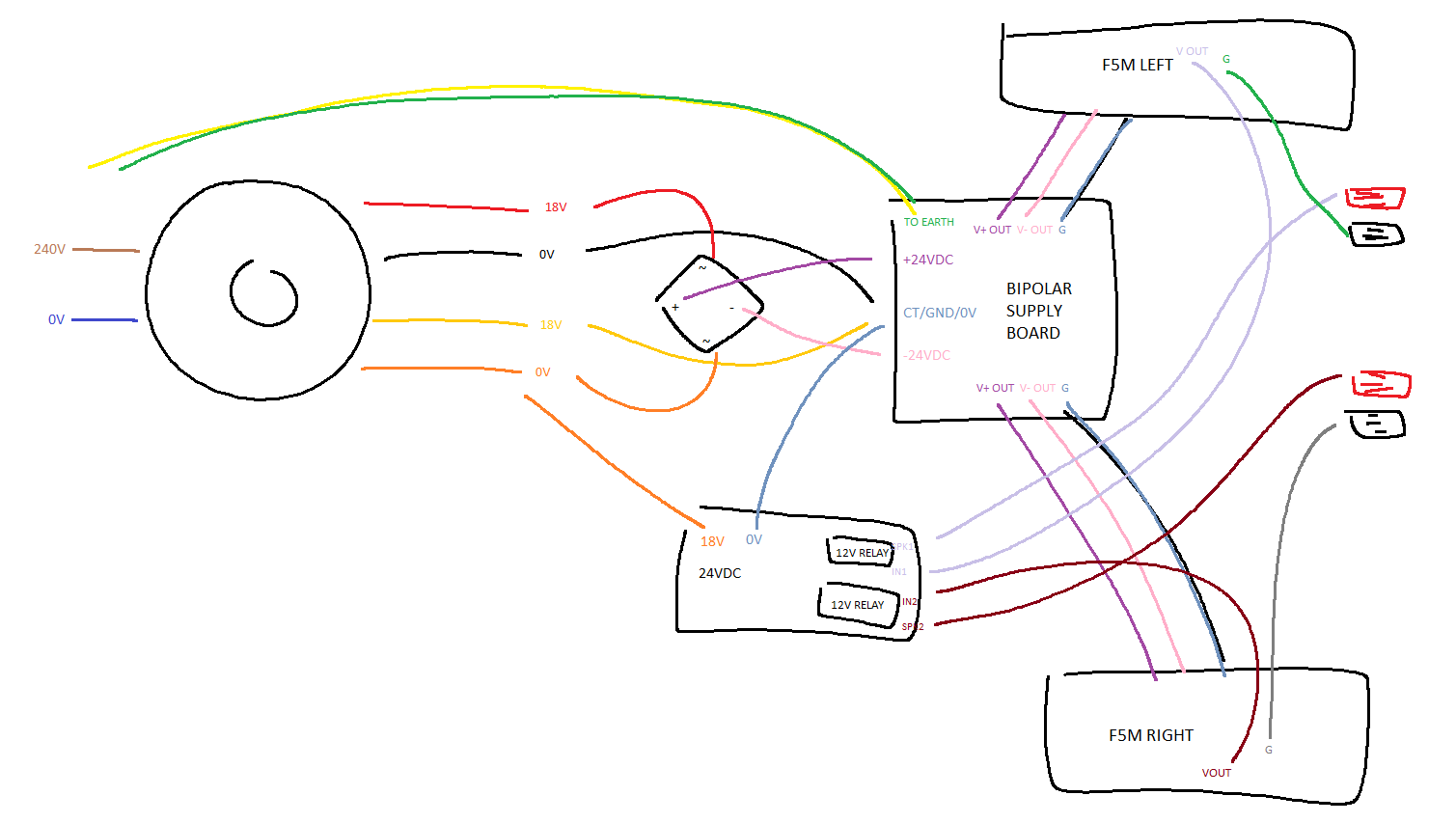

After messing around in MS Paint to get it all straight in my head, I think I get what you're saying.
It doesn't seem like there's a compelling reason to do the dual bridge rectifier thing, and I should just wire the dual primaries in series and treat is exactly like a centre tap. The F5M Bipolar Supply board seems to do this for me, as it has two through holes labelled CT. I imagine I can just power the DC protect board by using this centre tap (DC Protect 'G' wire soldered into the supply board in the same hole as one of the two CT secondaries) and either of the other secondary wires for V+ as long as it's taken before the supply board (could even do a piggyback faston off the bridge AC in?). Shouldn't matter which wire because either one is 18VAC away from the CT. Am I close? I feel like I am?
That looks fine 👍 I can't spot anything amiss there 🙂

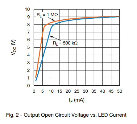

I have an opportunity to add a small speaker protection board to a finished project. The Store's version is too large but Prasi's version (which is the same circuit as the Store's other than his use of VOM1271T-1 instead of mechanical relays; see post #708) will just fit. My question: will the board work reliably when the input voltage is 20 VAC? It doesn't seem to be a problem for the rest of the circuit, but I can't figure out the VOM1271T-1 data sheet to see if that part would be an issue.
I should note the amp will soon be returned to my daughter living in Brooklyn, NY, where one might expect interesting variances in the AC voltage. My reading of 20 VAC was taken when the line voltage was 120 VAC; at what point will dips in the line voltage affect the speaker protection board?

470 ohm is OK even if your supply goes up a bit to say 22 volts but you are running the photo diodes in the couplers at the very upper end of their range (50ma max) I would say something like a 560 or 680 ohm would just bring that down a bit with no ill effects.
The data sheet shows little gain from currents over 15ma. 680 ohm would give (20-2.8)/680 which is still 25ma. The 2.8 volt is the combined drop of the two series photo diodes. Even your supply fell to say 18 volts you still have 22ma flowing which is still more than enough. I would imagine the total supply voltage could go down as low as 12 volts or less before any issue with the photo relay part was an issue even with 680 ohm. The rest of the circuit might not work as expected at that value but the relay part would.

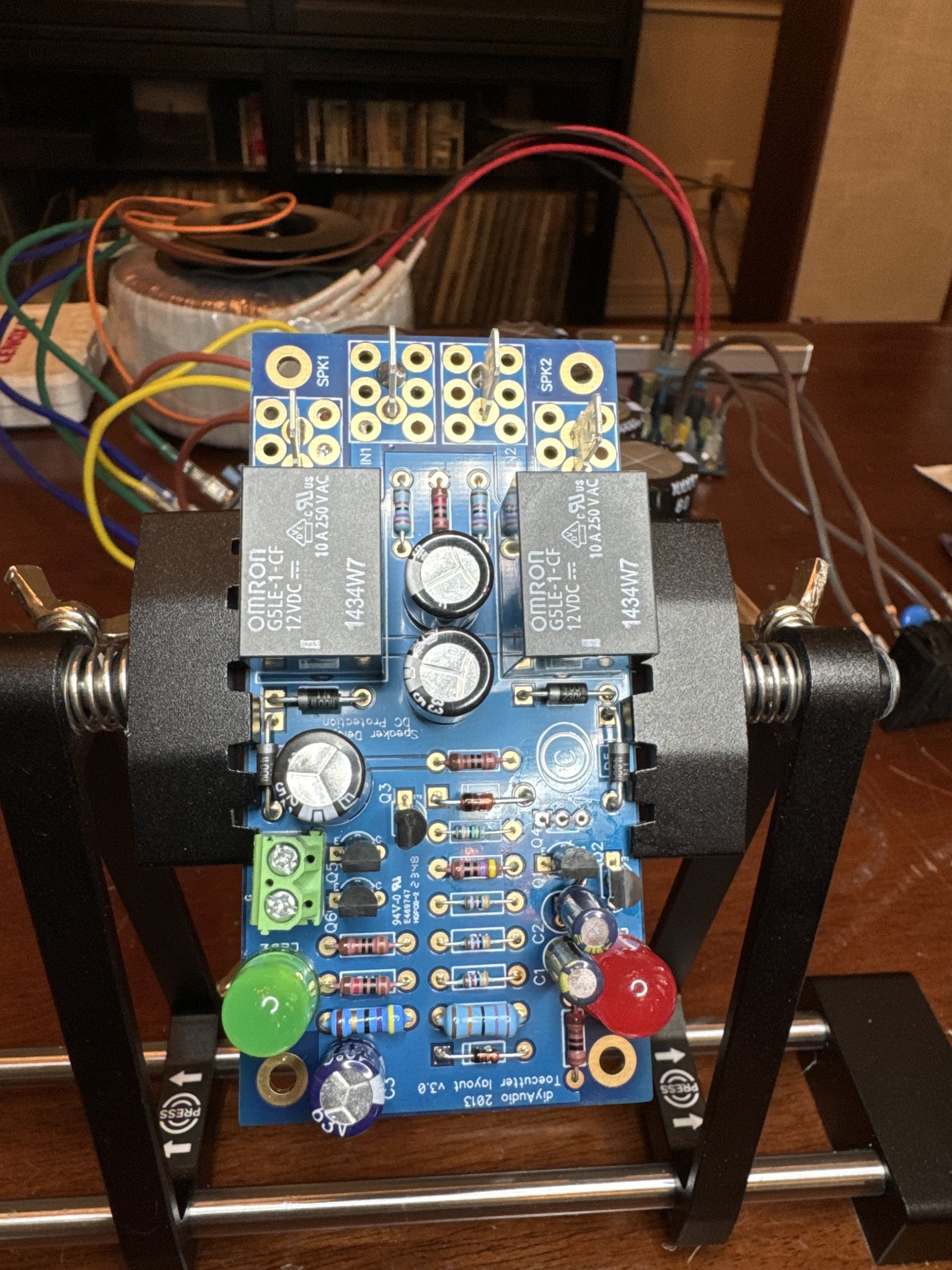

I am at a loss here and wonder if someone may see something glaring in my build. I have used an 18vac tap from amplifier toroid, I have also used a stand alone 24vac transformer hooked to the speaker delay and dc protection board. The first time powered up w 18vac it smoked Q4. I compared the MPSA06 transistor to my mouser order and confirmed it is EBC. I replaced it, checked for bridges, and brought it up on a variac and smoked it again. I replaced it with 2n3904 with same result. Led 2 comes on with even 1/4 power on variac, led 1 starts to oscillate and then the relay start buzzing before Q4 dies. Thank you in advance. Ps Despite the odd sizes all resistors are 1/2 w or greater.
I am at a loss here..........

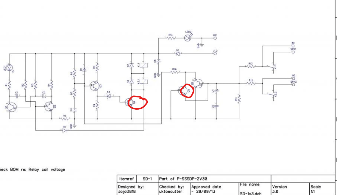

You probably have a short from the collector of Q4 to the positive rail and that could only be caused by the two diodes fitted back to front or some issue with the relay connections. Can they be fitted incorrectly.
There is no high current path into Q4 other than those routes. Any issue with 'just' a faulty Q4 or incorrect fitting etc etc would not damage anything. All that would happen is the relays would either operate all the time or never operate. Nothing would burn.
Can someone who has built this confirm which of these is correct. V2 and V3 diagrams have different transistor location numbers. T4 in V2 becomes Q5 in V3. All other references seem the same apart from switching from T to Q designators.
I puzzled over this for a moment as in the post above as T4 would have no obvious means of burning but Q4 in V3 does.

Mooly, thank you for looking at this. My work (the one that pays the bills) has kept me from diving in to this more. I will also admit I am good at following schematics and understanding the function of discrete components but can get lost easily enough taking the schematic and applying it to the PCB and seeing a fault at PCB level. I will see if I can find a reason for Q4 to let the magic out with the schematics you posted, last I checked the schematic was behind a broken link so thank you again.
