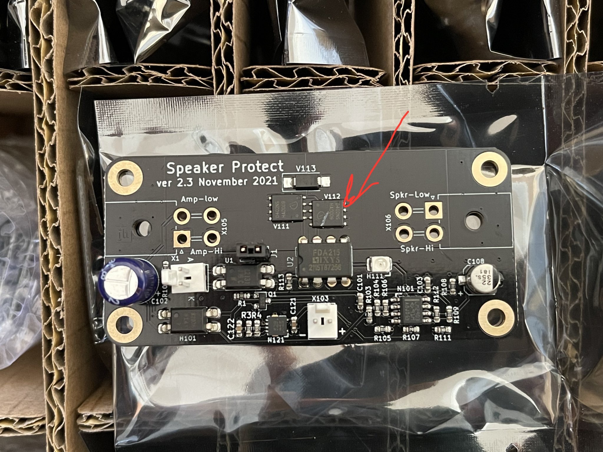

I have to say I've seen the Neurochrome unit before, and while I'm sure it's very good, I'm not a fan of just plugging in a pre-populated SMD board - just feels like I've cheated.
The MOSFETs I use don't have pins. That's one of the ways they get their extremely low (few mΩ) on-resistance. Good luck soldering those by hand...

I've been unclear. I should say I have this feeling about all pre-populated boards, simply because what I find enjoyable about DIY is doing everything, as much as possible, myself. Even if it's not the best implementation. I know you're aware of this kind of thing because you've said yourself the LM3886 Done Right is, and always will be, through hole. That market exists.
I have no doubt the component you've chosen is the best performing, and a pre-populated board is the best way of providing that performance to the customer. No doubt at all. I'm not intending to insult your work.
I just prefer soldering all the bits where I can. Personally.
I didn't perceive any insult so no worries there. I do understand that some enjoy the build process from start to finish while others are, frankly, tired of soldering everything. It's just unfortunate that those who wish to complete every solder joint themselves will likely have to give up some performance in exchange for that. I plan to cater to both segments for as long as it's practical.

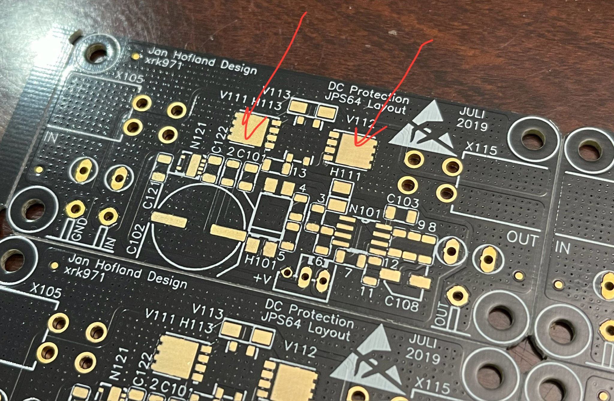

The ones I use have tiny little exposed legs and I suppose could be hand soldered but a hot plate and solder paste would be needed for the wide drain electrode. I never thought about offering the PCBs as bare before because I assumed people just wanted these to work as a piece of gear.I've been unclear. I should say I have this feeling about all pre-populated boards, simply because what I find enjoyable about DIY is doing everything, as much as possible, myself. Even if it's not the best implementation. I know you're aware of this kind of thing because you've said yourself the LM3886 Done Right is, and always will be, through hole. That market exists.

The above is the latest version but the MOSFET footprint has a large pad underneath the 4 “pins” on one side. This is needed for thermal conduction for cooling.
Here is the PCB for v1 (which works fine as long as amp is not bridged).

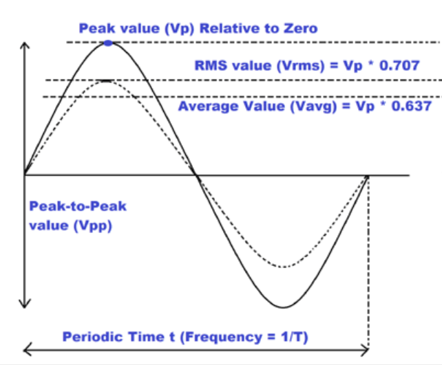

You need to understand the relationship between an AC voltage from a transformer and a DC supply voltage. The DC value is what it says on the tin, so 24 volts DC is just that. An AC value is an RMS value...
So a transformer that is '18 volts AC' has a voltage output that is a sine wave in shape and that starts at zero, goes up to a positive peak value, then falls back through zero and toward a negative peak value.
The '18 volts AC' is the rms value. The peak is 18 multiplied by root 2 (1.414) which gives 25.4 volts. That is the voltage at tip of the positive and negative point of the sine and that is the voltage that rectifying the AC voltage will produce as a DC value. The rectifier conducts and charges the reservoir cap after the diode to the peak value of the AC.
https://circuitdigest.com/tutorial/ac-circuit-theory-peak-average-and-rms-values

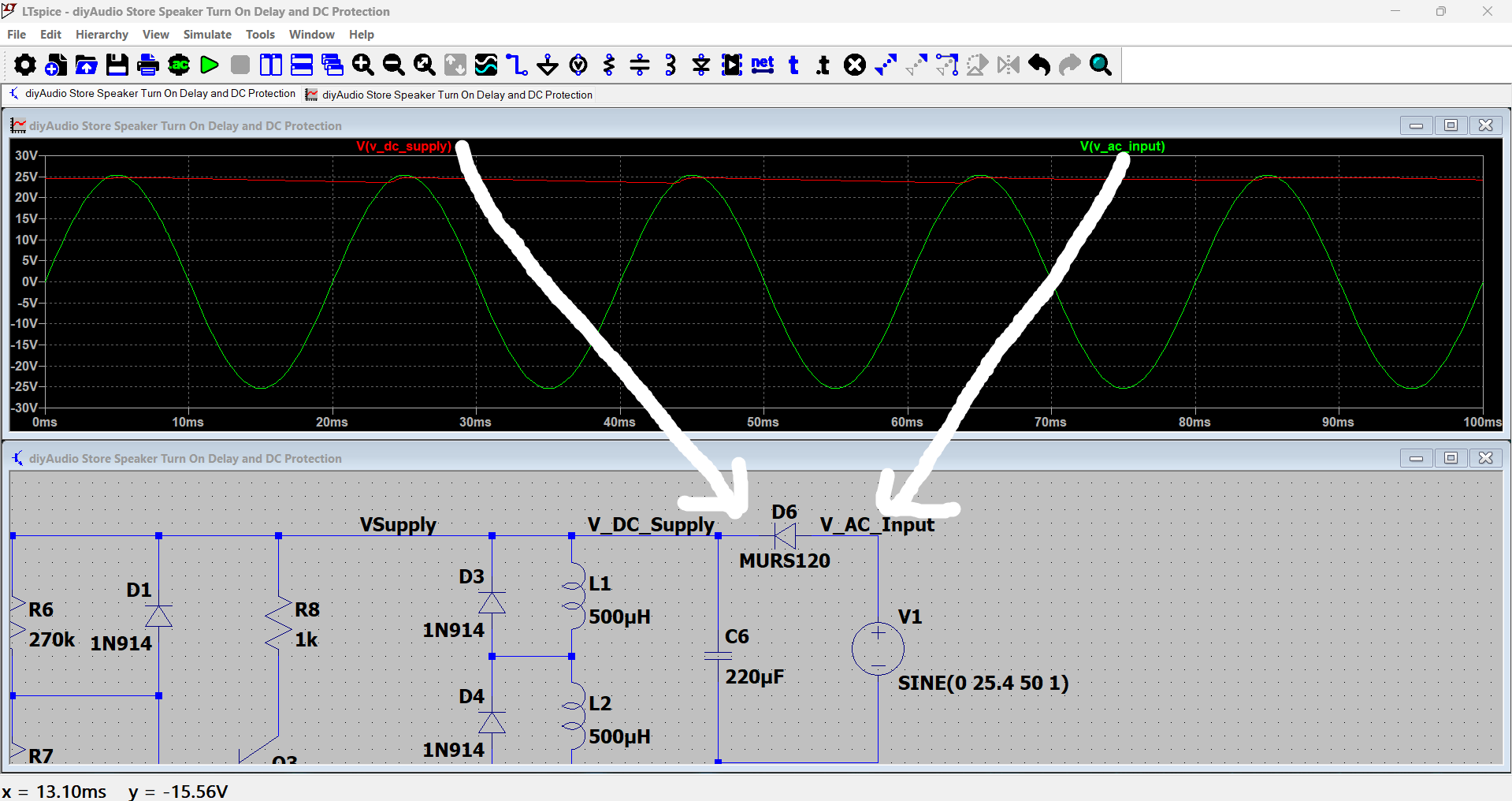

This might explain it better.
The input voltage is 18 volts rms. Look how the AC voltage rises to a value of 18*1.414 and also falls to below zero to that value. So 18 volts rms is 25.45 volts peak and so 50.90 volts peak to peak (top to bottom).
The rectifier diode only allows the AC part of the voltage that rises above zero to pass and the reservoir cap (C6) charges to the peak voltage which is 25.45 volts. In practice the diode drops around 0.6 volts but we can ignore that.
The DC voltage has 'ripple' on it and that is because when the AC voltage falls away the circuit gets its power from the cap and the voltage on the cap falls. Notice how the red voltage line isn't straight but falls a a little between each peak.
When the next positive half cycle comes along the diode tops up the cap again once the incoming voltage exceeds the voltage remaining on the cap. That happens every 20ms for 50 Hz mains.

The original BOM specs C6 as 220uF - 470uF. Does going larger improve the ripple any? Truth is I'm probably going to supply DC to the board from the F5M cap board (if that's doable), but it would be good to know about the AC option if I go that direction.

A bigger cap will reduce ripple but that isn't always a great idea in every case.

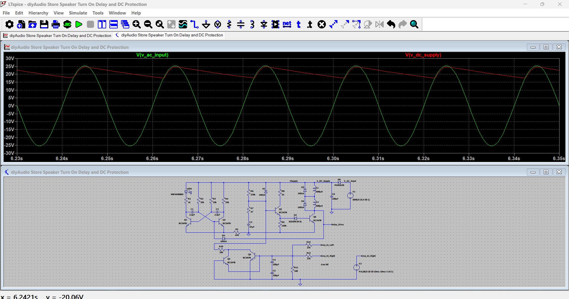

Using AC and a 'small' cap means that as soon as the mains is disconnected the current draw of the circuit will collapse very quickly and that is exactly what you want here to ensure the relays drop out 'instantly'.
The screenshot above showed the ripple during the time the relay was not powered. This shows the ripple when the relays are drawing current.

That's really very helpful. Thank you.
So, powering it from the massive amplifier DC supply is a bad idea because that'll take forever for the board to lose power? The AC option is starting to sound like the way to go.
