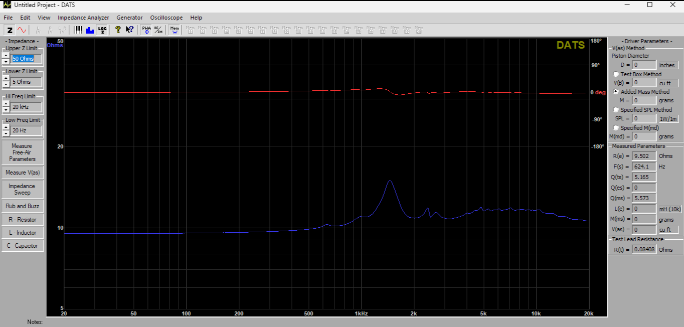

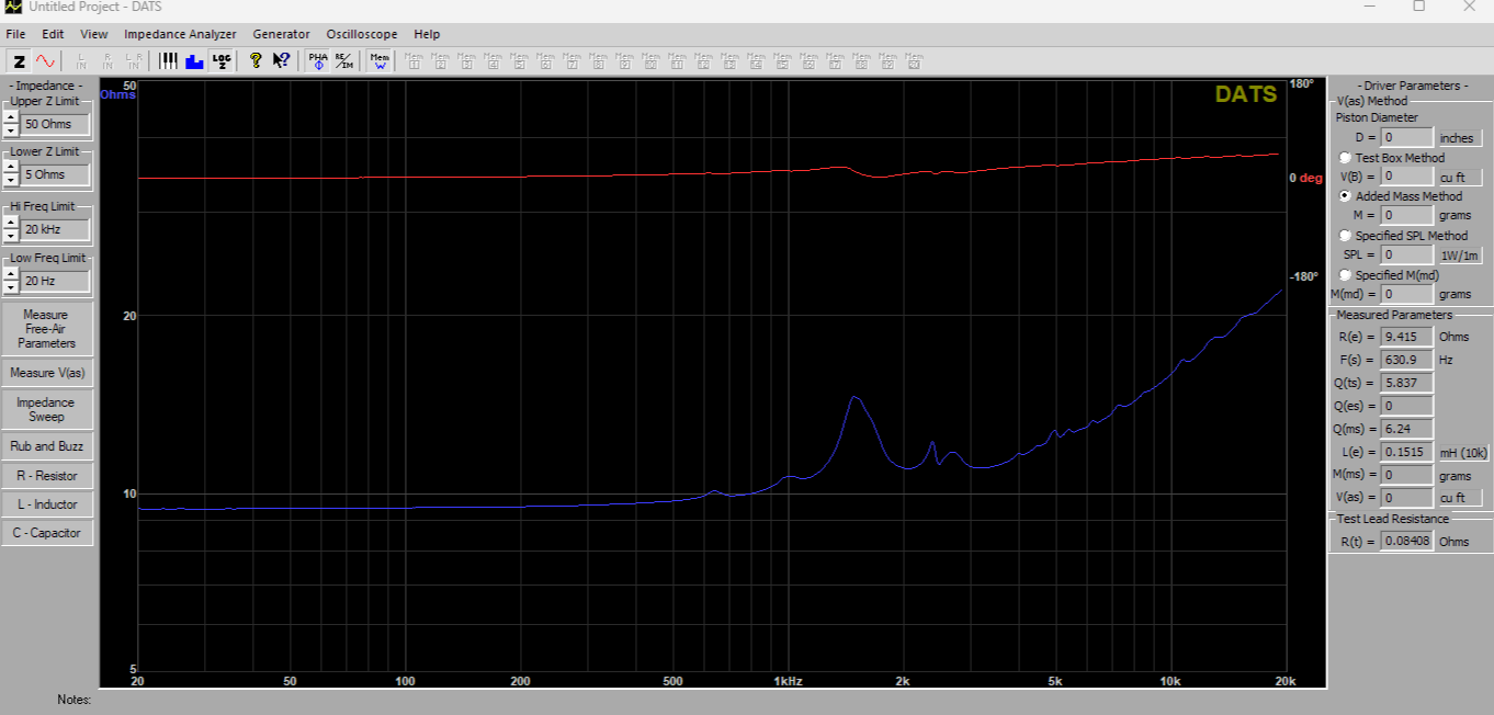

Here's the graph with the zobel connected. 1.1uF 12 ohms
To make it easier to compare here's the graph without the zobel again.
Looking at the graphs, if I did things right it looks like maybe only a 1-2 ohm difference between using the zobel and not using the zobel. Only way to know if that difference is audible is to try it tomorrow at work.

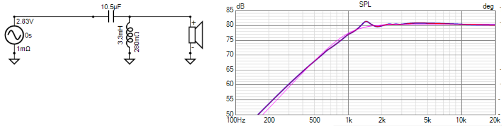

RC will not linearise the impedance with regard to the amplifier if it is behind certain other components. It may change the impedance as a load for the filter, thereby changing the response.

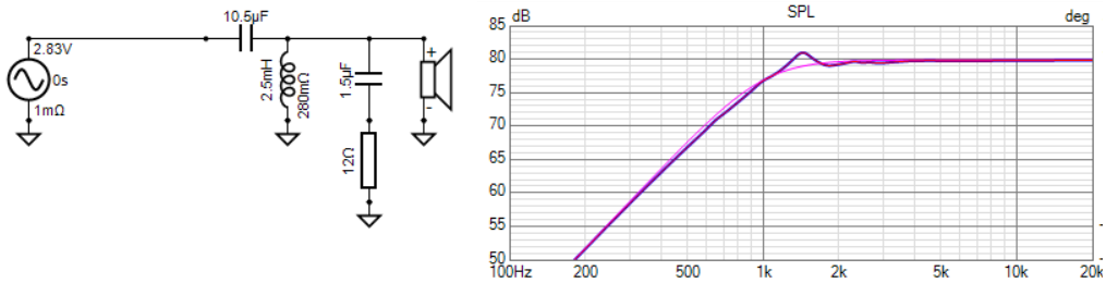

Some examples using your impedance plot. First, a generic 1kHz 2nd order high pass for 8 ohms.
Now optimising the values to get closer to the target.

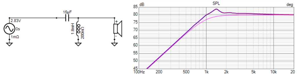

Now doing the same with the RC in place.

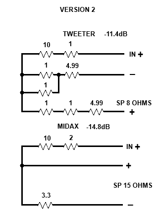

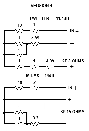

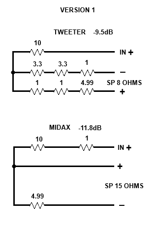

So I tried this version of the l-pads. It sounded better but I felt the tweeter was too loud.
I then decided to reduce the tweeter level, however before I could make the changes I listened more and decided the midax was a little low.
So I'm going to try this as it requires only adding one resistor.
Now all this is being done by ear.

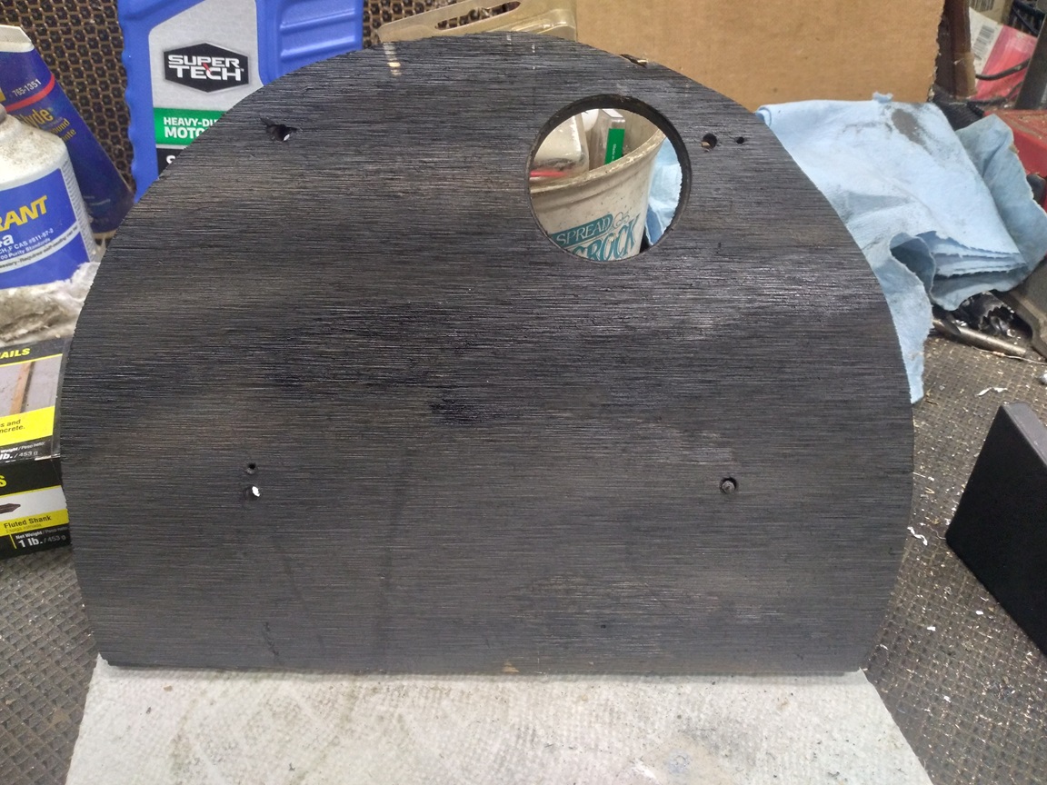

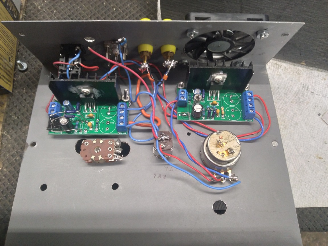

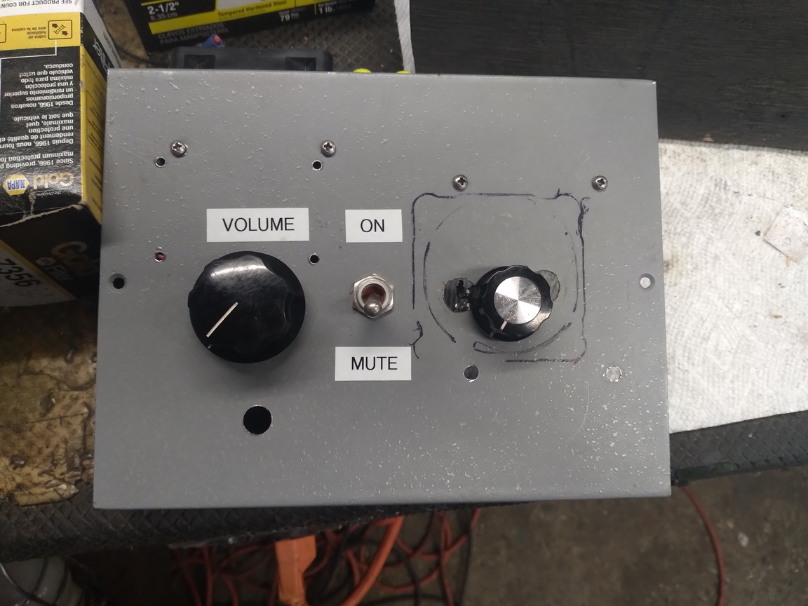

Here's some photos of the board and modified amp chassis.
Cut a hole in the board to match the one I cut in the chassis. Plus I drilled four holes in the chassis bottom and wood so that the amp can be secured in place. Next time I order something from Amazon I may order a metal fan grill to put on the bottom of the board.

Top of the chassis with the level control mounted in its new location.
Inside the chassis. I tried to find a 50k pot, but all I could easily find were 10k pots, however I did find a 100k dual gang pot which will be wired in parallel for 50k. I'll also rewire the pots so that the 10k volume control is first, whereas now it is where the volume control is last. I haven't found the banana jacks I have.
Hole was put where it is so that air would flow over the other heatsink. Plus it gives the fan a proper air intake instead of just relying on the small holes in the chassis.
