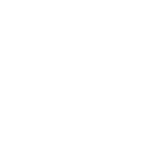

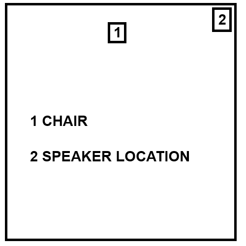

Yep the screen looks just like the screen used for windows only it's copper.

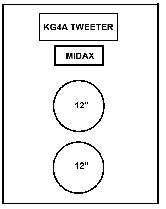

Now would a 4' X 2' baffle be ok for two 12" woofers and the midax and tweeter or will it at least make the bass better than the cardboard box does?
The wall the chair is near is against a raceway. The other wall that meets the one wall has a wood panel on the outside that goes from the bottom to a little over 2' high with the door in the middle of that wall. The wall and raceway will reduce the sound leaving the screen room out to the main aisle. The way the speaker is pointed will make the sound come out more down the aisle my desk is on.
OK, I've now digested your latest design plan, of which the above sentence provides a simplified statement.
Open baffle bass response is highly dependent on baffle positioning in relation to reflecting surfaces like the walls of the room.
The results are also heavily dependent on the characteristics of the woofer, and I believe your woofers are actually full range drivers.
The woofer would ideally have good linear excursion, high Qts (> 0.77), and relatively high resonance frequency Fs (40-60 Hz).

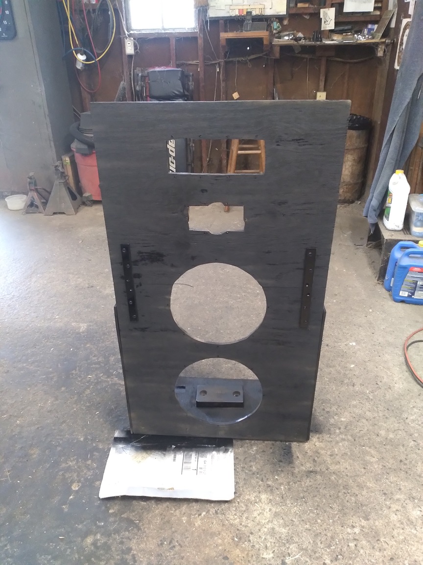

The drivers will mount from the front and the crossover will mount on the base. There's a metal weight seen in two of these photos.
That's there as it is front heavy and can will tip over without drivers installed.
I should have used the same thickness wood for the side and bottom though, but it was expensive enough as is.

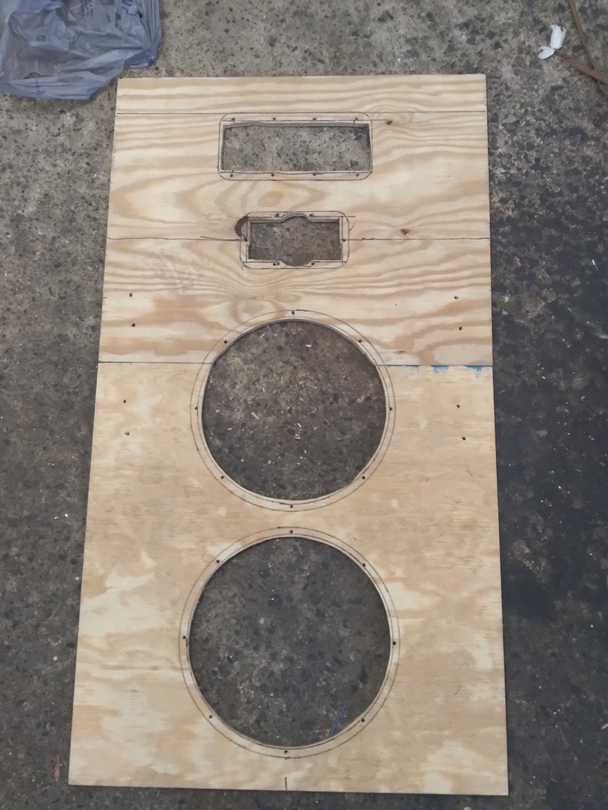

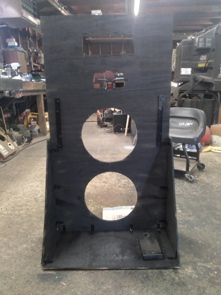

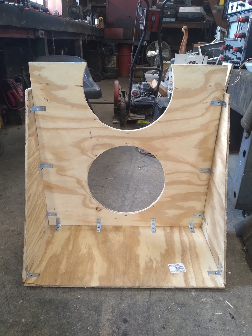

Got the cuts done.
Partially assembled
Front
Rear
I'm thinking of permanently attaching that weight as it will keep the speaker more stable.
I'll use some screws with washers and lock nuts. I like the lock nuts as I don't have to rely on how tight the nut is against the surface to keep the nut tight which is better for the wood as I don't have to worry about damaging it especially with how close some of the screw holes are to the cut out portions.
Will that baffle be good enough for open baffle? Not looking for 20Hz bass response as I'm sure the woofers cannot play that low.
