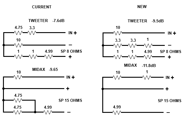

What I need to do is measure the resistance of the drivers and draw a schematic with the added l-pad components for the midax and tweeter and the zobel for the woofer. That way I can calculate what the attenuation is and calculate what resistors I need. I'll start with 1db lower on the midax and tweeter.
Only issue with measuring the driver impedance is the other KG-4 tweeter I have one of the terminals broke off and trying to solder to the wire didn't work so I cannot measure the impedance of that driver. For the l-pad on that driver I used a combination of a typical l-pad with a series and parallel resistor then a series resistor to bring the impedance up to 15 ohms. The KG-4 tweeter is sensitive enough to where even after the series resistor an l-pad was still needed to bring its level down.

Here's the l-pad. Gonna try the new values and see if it works. The zobel did make me have to reduce the level of the midax and because it was well balanced with the tweeter I reduced both by close to the same amount.

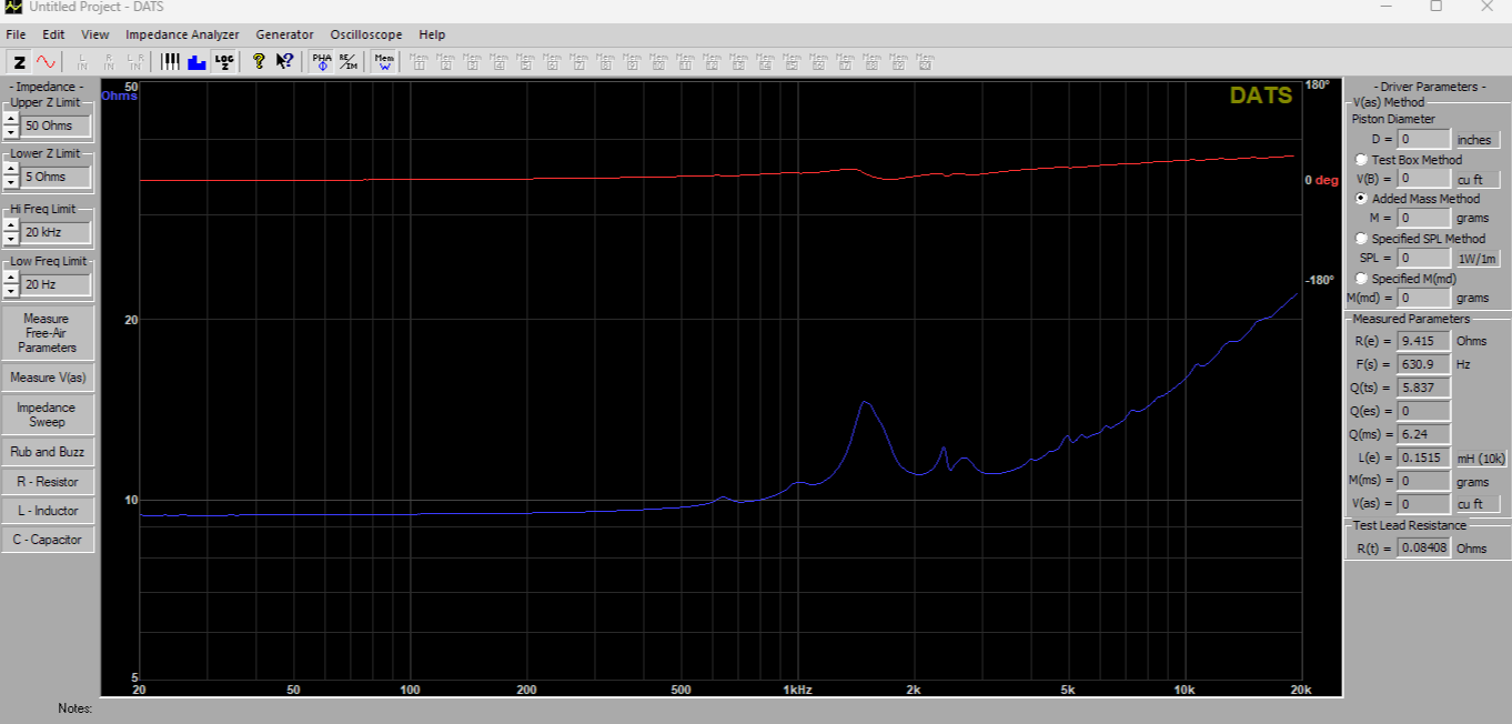

The impedance peak is relatively small so I'm not worried about RLC compensation.
Would I need a zobel for the rising impedance as the frequency increases or would the impedance stay low enough to where there's no audible effect of adding one?
That won't do. If there's a difference in response then of course that could be audible, but what's the point of settling for an arbitrary response? (even if it's not yet known what it should be).
To make a fair comparison you need to find a way to cross with and without the RC which gives you the same response, and when you do you'll find they sound the same.
