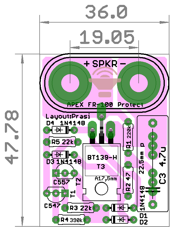

Prasi,you know the next step!😉
I hope this is the expected next step😉.
edit: slightly edited the silk (credits)

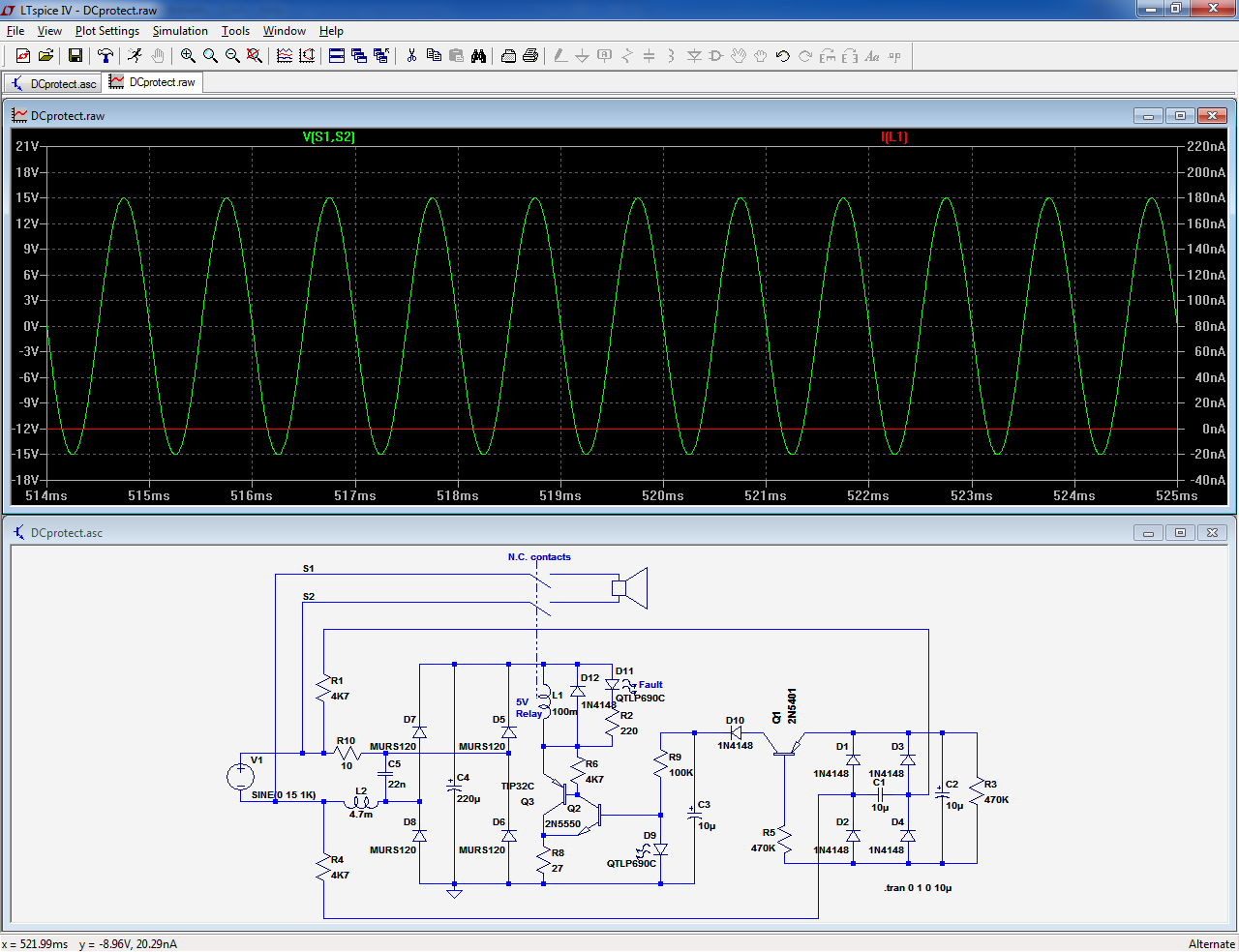

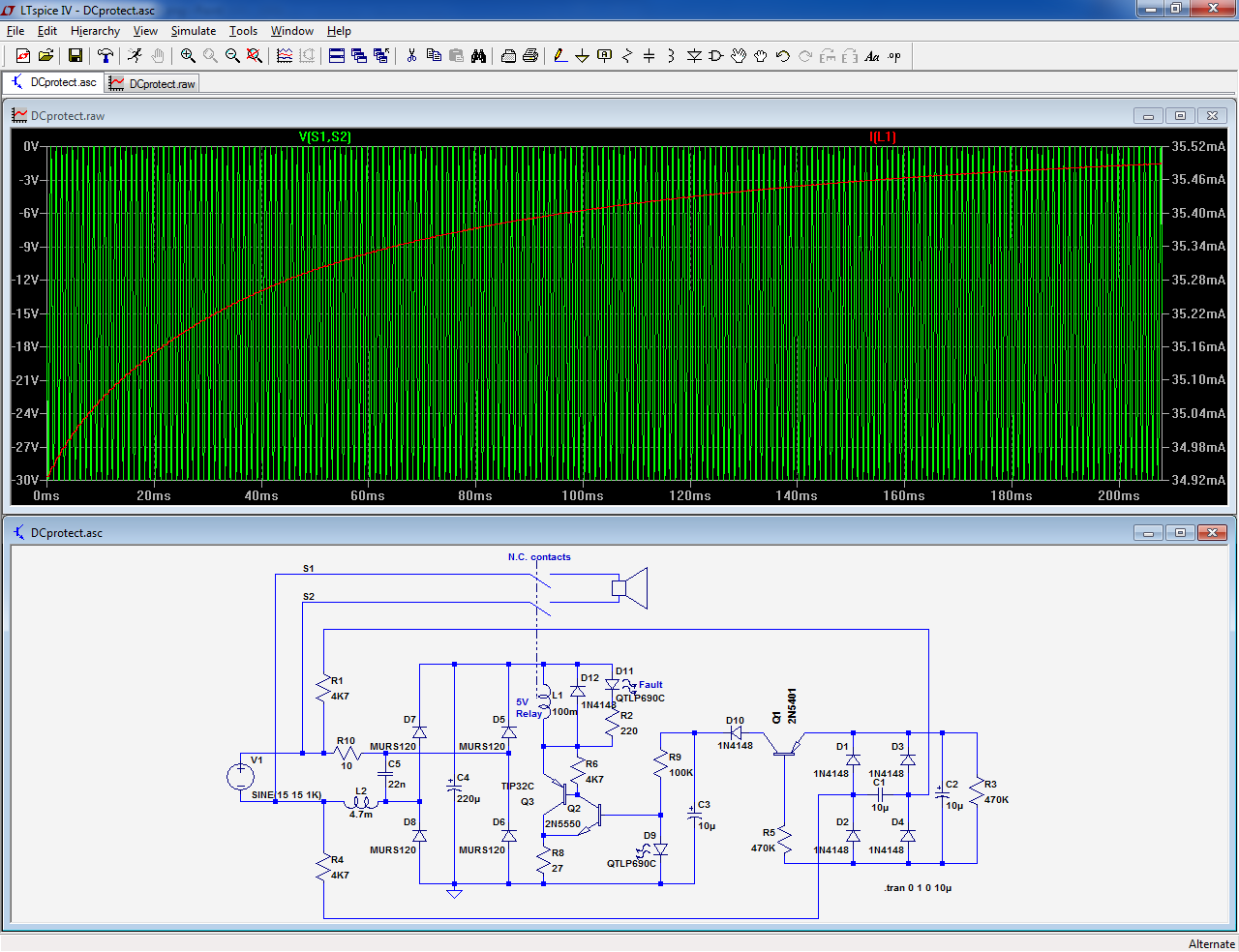

Here is an idea of passive circuit, based on a normally-closed relay avoiding further damages to the amplifier in the event of a fault:
Under normal conditions (no DC), the relay remains unenergized:
When DC is present, the relay is activated, opening its contacts:
Good,very clever design! but in this case you need another mute circuit elsewhere ,maybe in the amplifier input.Here is an idea of passive circuit, based on a normally-closed relay avoiding further damages to the amplifier in the event of a fault:
Is it a pcb available?
Why? This might be required for the previous examples, the ones shorting the output (although it risks being ineffective, if the amp's problem is such that it is completely unresponsive), but this ones opens the speaker's circuit all the time the voltage is present. In fact, the fault voltage serves to power the circuit.Good,very clever design! but in this case you need another mute circuit elsewhere ,maybe in the amplifier input.
No, I just cooked it now, it's still hot from the oven and hasn't been tested.Is it a pcb available?
Another possibility would be to drive a bistable relay, but the rearming problem would need to be solved.
An elegant method would be to use a purely electromechanical residual current circuit breaker: there is a manual resetting lever that could be accessible on the rear of the speaker

As a normally-closed relay used how the start-up noise will be avoided?Why? This might be required for the previous examples, the ones shorting the output (although it risks being ineffective, if the amp's problem is such that it is completely unresponsive), but this ones opens the speaker's circuit all the time the voltage is present. In fact, the fault voltage serves to power the circuit.

Indeed: this thread is about speaker protection, not anti-thump circuits, and anyway, how would the circuit know what is a power-on thump and what is part of the program, like violent percussions, explosion noise, etc?Let the amp builder handle that. A passive speaker protect has value by itself.
Continuous DC for more than ~100ms is clearly pathological, but other than that....?

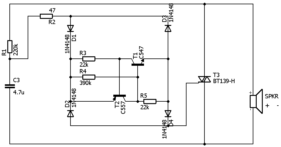

The circuit could be made remarkably simple and elegant:

A small pcb could be very popular. Why not wait a bit and the eBay folks in China will have one ready at very low prices ?

I like schematic from Elvee, i m not so experienced but i think something similar..
Loudspeaker Peak Indicator Circuit
but instead of led to put relay for 5v (it consuption something about 60ma) and to change R9 maybe also to correct value of C1
