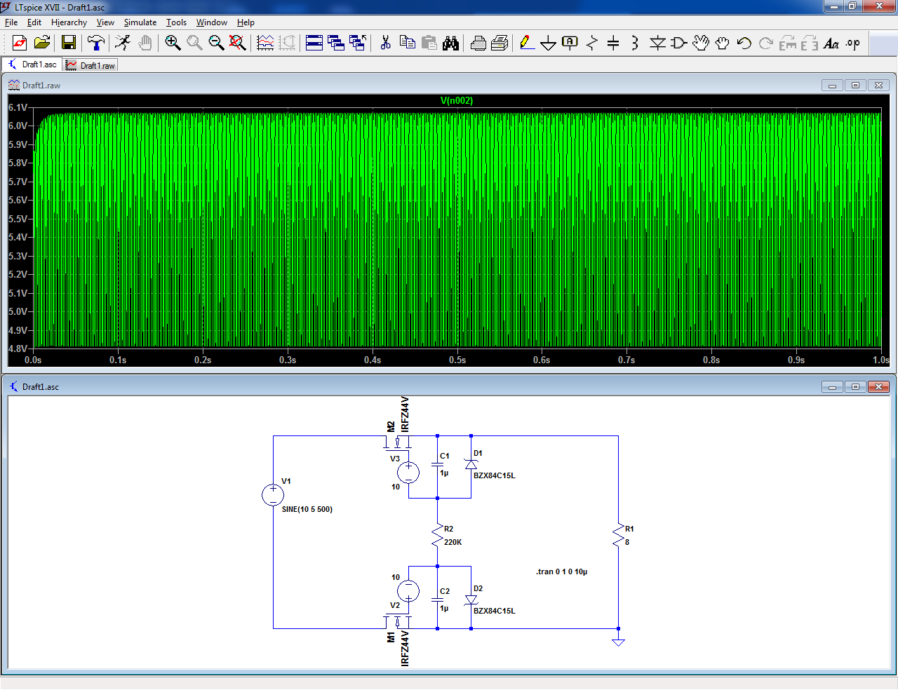

Elvee, can you elaborate on this? A practical schematic perhaps?
This seems like easiest and cheapest speaker protection that
I can build into speakers, instead of adding new protection circuits
into each amp I build..
Either regular fet with batteries, or power depletion fet.
Perhaps this fet would do (without batteries):
IXTH10N100D2
It's expensive, but if it's gonna solve the problem once and for all....
It seems easier than your ASPv2...

If you do, please include as many cases/outlines as possible: oranges are not the only fruit, and the CPC's are not the only depletion MOSFet around.
Another option that might also be desirable (perhaps a different PCB) is a "false" depletion FET: a regular, dirt-cheap enhancement FET having permanently connected 3 lithium button cells directly in series with the gate.
OK, not a true depletion device, but will behave so for the next 20 or 40 yrs: just the shelf life of the cells
Sorry, I now realize that I was over-enthusiastic: the circuit cannot possibly work as intended, because of the body diodes of the FETs.
If the input and output are reversed, it could act as a current-limiter, because the depletion FETs will combine with the load resistance to form a CCS, but current will still flow and will be determined by the pinch-off voltage of the FETs.
I do not see a simple way to remedy the problem, unfortunately
What if each FET is replaced by 2 FETs in sequence in opposite directions?Sorry, I now realize that I was over-enthusiastic: the circuit cannot possibly work as intended, because of the body diodes of the FETs.
I bent and twisted the circuit in every possible way, and the least worst configuration I found was the one I posted.
When something looks too good to be true, it probably is.
There are bright people on this forum, and maybe someone else will see the light and come up with an acceptable solution......
