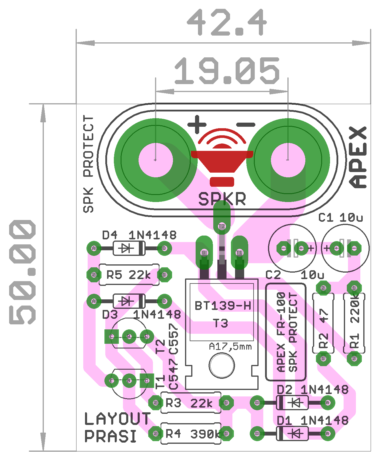

Hi thimios,
its shared here, http://www.diyaudio.com/forums/solid-state/173462-studio-reference-amplifier-222.html#post4837066
its an Apex design, I havent tested, just designed. he says, activated with DC >+/-10V.
here is the sch.

Thanks,so this is suitable for any amplifier that operate at any power supply from +\-10v
The dc offset that activate the triac is another thing.
This circuit haven't any reference to GND, no isolation needed.

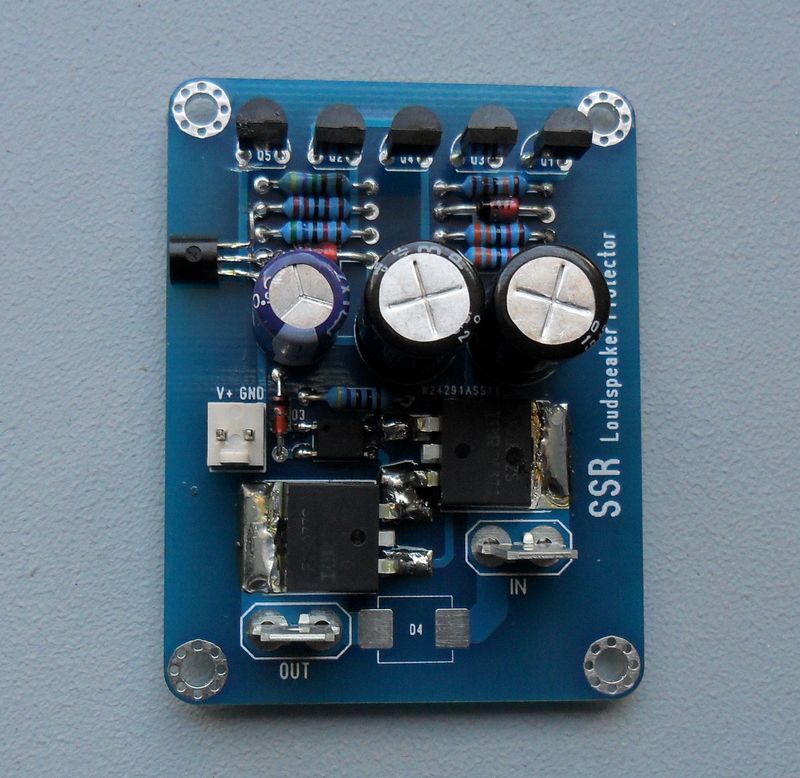

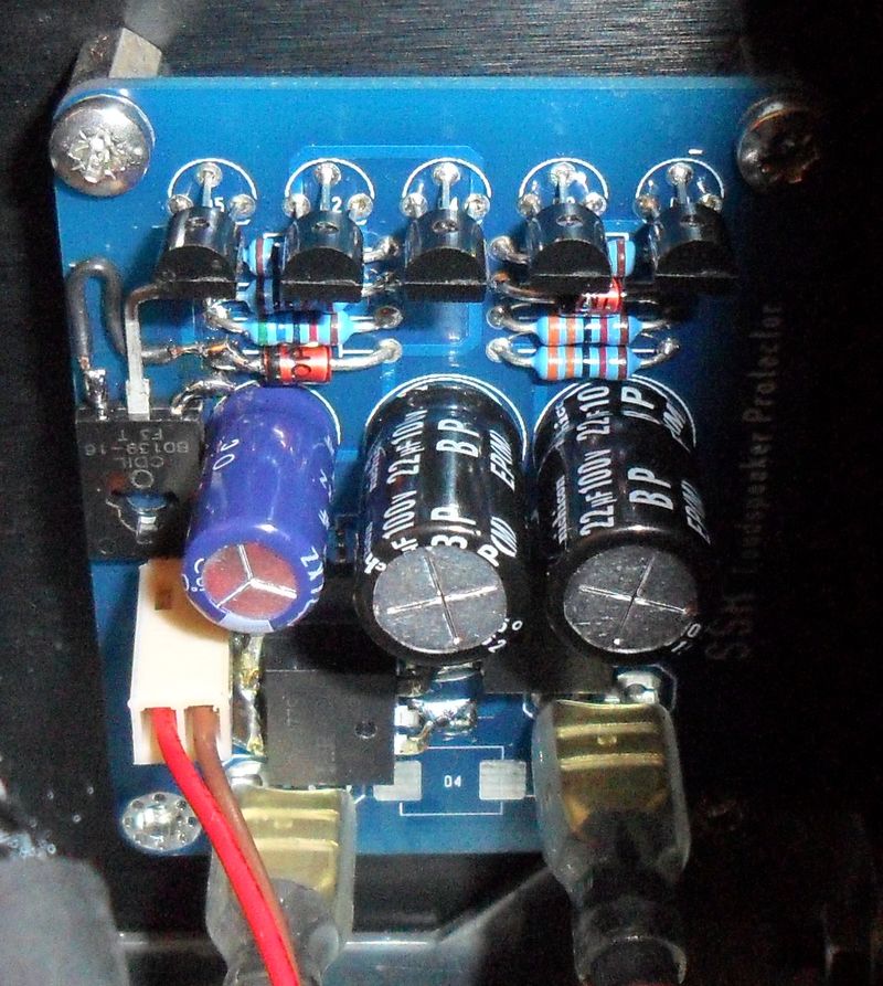

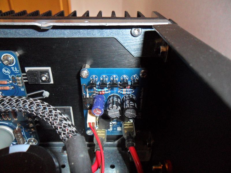

Hello everyone
Here is the prototype under test of my SSR protection.
Normally when fully optimized it can be powered from 12V to 50V without matching component values (just a small current setting on a trimmer). The DC detection can be selected from +/- 0.6V to a higher value if desired.
Currently I have a small problem to solve on the start-up delay.
Here is a picture of the protype that works without any worries on my amplifier class A (USSA-5 by Fab).
Regard's 😉

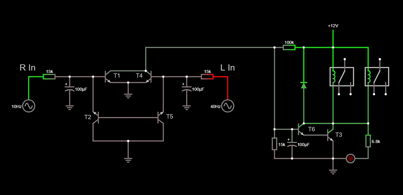

I have used these XY boards in various amplifiers. I had one in a TPA3116 amp and found that at a reasonable volume level (not mega loud) there was a noise which is hard to describe. It was like there was poor connection in the signal line, a sort of electrical interference. If I backed off the volume slightly it disappeared. I put this down to the 3116 perhaps getting too much signal or it was not happy in some way.
I have just put together another Class D amp (TK2050) form a board I have had lying around for a few years and added the XY protection board. I had tested the amp without the protection board and it was fine, it played to silly levels without distortion. After I added the protection board it did the same as with the 3116 board. Anyone have any ideas what is going on?
Poor contact in relay switches perhaps? - I am not convinced of the quality of these china brand relays used on a $5 protection board..
Try and fit an Omron relay instead, and see if it solves the problem.
it may be something like that https://cdn.shopify.com/s/files/1/1006/5046/files/Speaker_Protection_Board_Schematic.jpg
