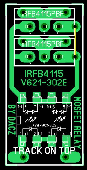

Yes, Bonsai and others have implemented SS relays.Does this look like a viable solution after the smoothing caps ?

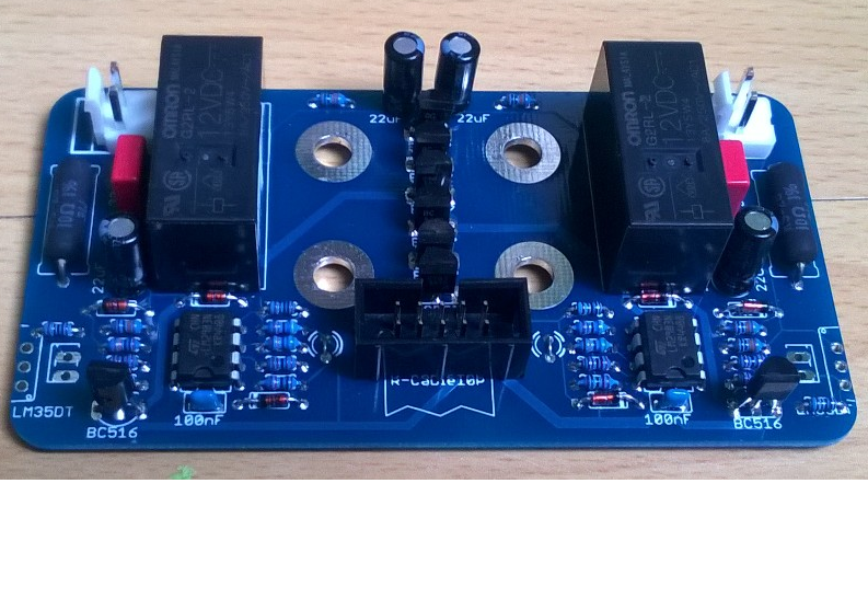

I have the PCB kit as being discussed in this Thread. It is potentially slow because it does not have loss of AC detection.
If it were powered from the Main PSU to avoid the cost of a separate low voltage transformer, then it becomes far too slow.
Sajti's post34 sch with a separate transformer and low charge PSU can be made acceptably quick for a power amp isolation. But may still be too slow for a fast reacting source that shuts down very quickly. I know I have tried it and used it.
Andrew, I have build the SS relay circuit and it switches via a UPC 1237 IC. The circuit is driven from AC. Startup takes about 7s for mosfets to switch on and on power down it is immediately. Works very good.
I bought 5 from Ebay. Two of them work as expected and the other three works, but are slow to switch off. I suppose they are rejects but they were so cheap so I took a chance.
Interesting: could you show the schematics?
Thanks,
Jacques

I have modified a little PCB (not posted here) to accept larger inductor.
So what id your opinion about relay response time, DC detection time and Power-Off detection circuit?

Jacques, I have used the same schematic which you have posted from Build amps and I have modified the board to take opto isolators and the mosfets.
Hi Jan,
Which opto isolator did you use? "TLP591" or "ASSR-V622-302E" ?
And which mosfets?
Thanks,
Jacques
