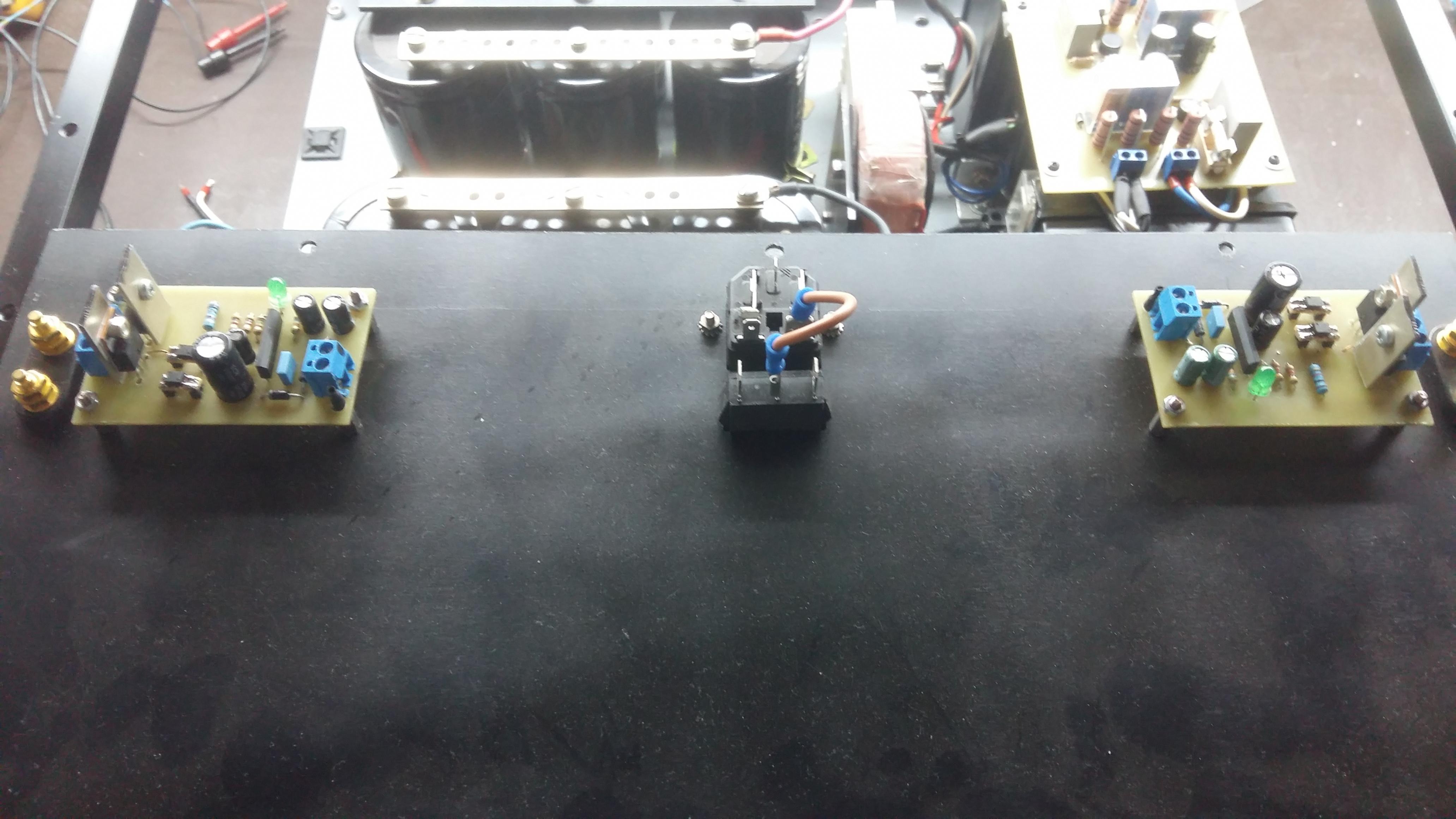

Dacz, the turn off circuit is just to switch opto off faster, If you remove the power from the 3906 then they switch off immediately and are extremely cheap. 0.3 ms seems ok to me.
Why put them on dissipators, are they heating ?

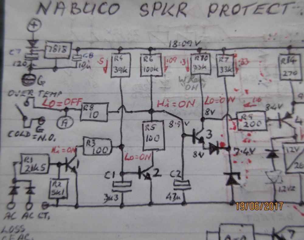

is this what you are looking for?I've designed a circuit by myself because it seems extremely difficult to detect defects in the AC.
When the stormy weather is here, there are some erratic small and fast series of power cuts, and all boards that i've buyed (including mainstream market amplifiers) or designed are in trouble.
How can you differtiate small cutted and distorded sinewaves of the regular distorded and dephased sinewaves please ?
The two diodes lower left each allow halfwave pulses to pass to the resistor attenuator R1&R2
Q1 pulses and discharges C1 repeatedly as long as AC is present.
Loss of AC turns on Q2 and that discharges C2 turning off the relay.
Q1 & Q2 is the D.Self loss of AC detector.
On a bad day I can suffer half a dozen complete power loss that restarts about 30seconds to 2minutes later, or stays off.
And suffers brown outs where voltage drops to less than 50% of nominal voltage.
Thanks,
Have you tried this schematic with erratic on/off switch cycles (like a child playing very fast with the switch room light) ?
It seems to work only if there are complete sinusoids on the AC, but how many sinusoids did it need to trigg the relay ?
