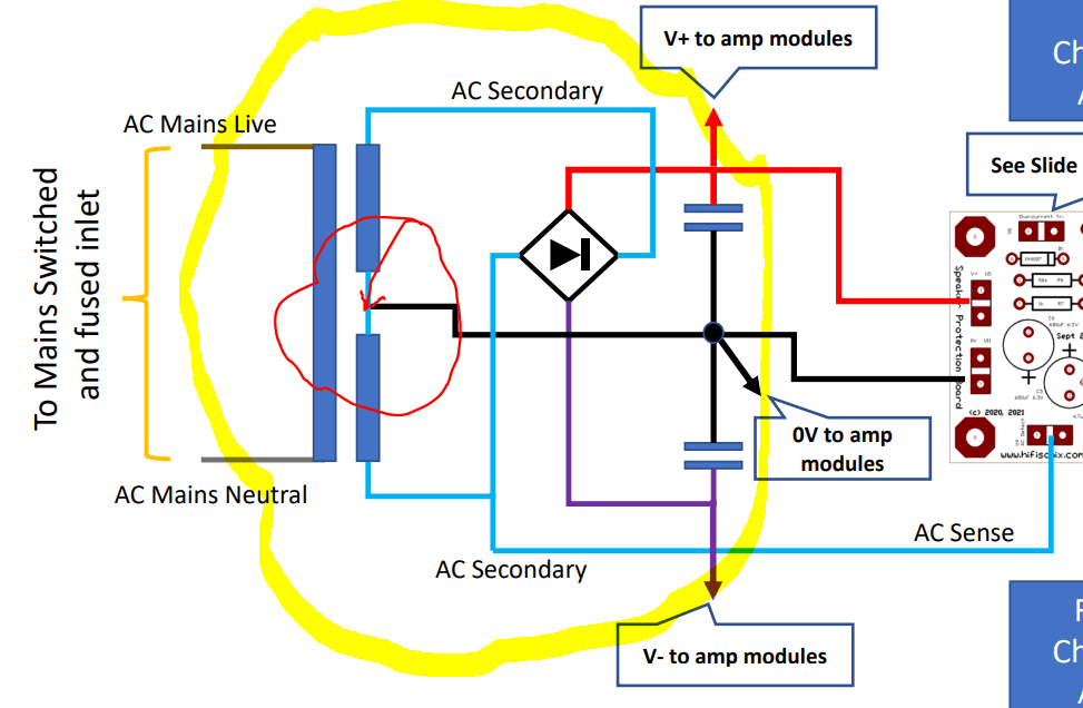

@Bonsai Can you explain how to figure the value of R9 and R10 for the Current Overload Detection Circuit using an opticoupler? I have 72 volt rails, so I'm gathering R11 would be increased to about 36k. If I was to use a 5V source in the amp of course it would be lower. Would TLP241B(d4,F work for the 72 volt rails? If I use the 5 volt source I would find a different opticoupler. I'm building Wolverine mono blocks, it should have 240 watts continuous into 8 ohms and 430 watts continuous into 4 ohms, it mentions 6 amp fuse per rail is minimum. It is using .21 ohm resistors for the emitter degeneration resistors.

If you look at the scematic of the power supply in #105, you see it is a split one. Split secondairies. How do I connect the AC lines, plus, minus and ground, to the board? And the AC sense?
Should I just use the lines of ONE of the two channels?
It is not allowed to tie both secondairies together.....
It is still not very clear to me.
Thanks, Ed.

Hi Andrew!
I did read the presentation. It shows one channel . My two channel amp (#105) has two separated and isolated secondary windings.
My Q is: Can I just use the connections of one channel to make things work?
And do I need the AC sense connection? I only want speaker protection.
Thank you, Ed

ed,
you only need one AC detect signal, so its ok to take it off just one of the secondaries. All the protector board is doing is looking to see if AC is present - it gives a long speaker switch-on delay when AC is applied but a quick one when the AC is removed. The AC detection is used to prevent speaker ON/OFF thumps when you power your amp up or down. I will add a short note about this in the presentation when I next do a site update.
If you are using completely separate +- supplies for each amplifier (i.e. monobloc construction) you can also just take the +- supply to the protection board off 1 amplifier power supply provided the two amplifiers share the same 0V. This will typically be the case if the amplifier 0V are connected to the chassis for safety, or, if the input signal grounds are joined together at the input socket and the amplifier main 0V goes to the chassis via a ground lifter. If the two amplifier channels 0V's are not joined in any way, you will need to use a separate Speaker Protection board for each channel
Hi Andrew, again!
My amp has a common 0.
So what I did is as you advised.
Plus and minus of one channel. AC detect from that same channel and the null.
And gess what? The thing works perfectly!
Thanks for your help, regards,
Ed
PS: I can read a book with the light of the Led! Hahaha.
