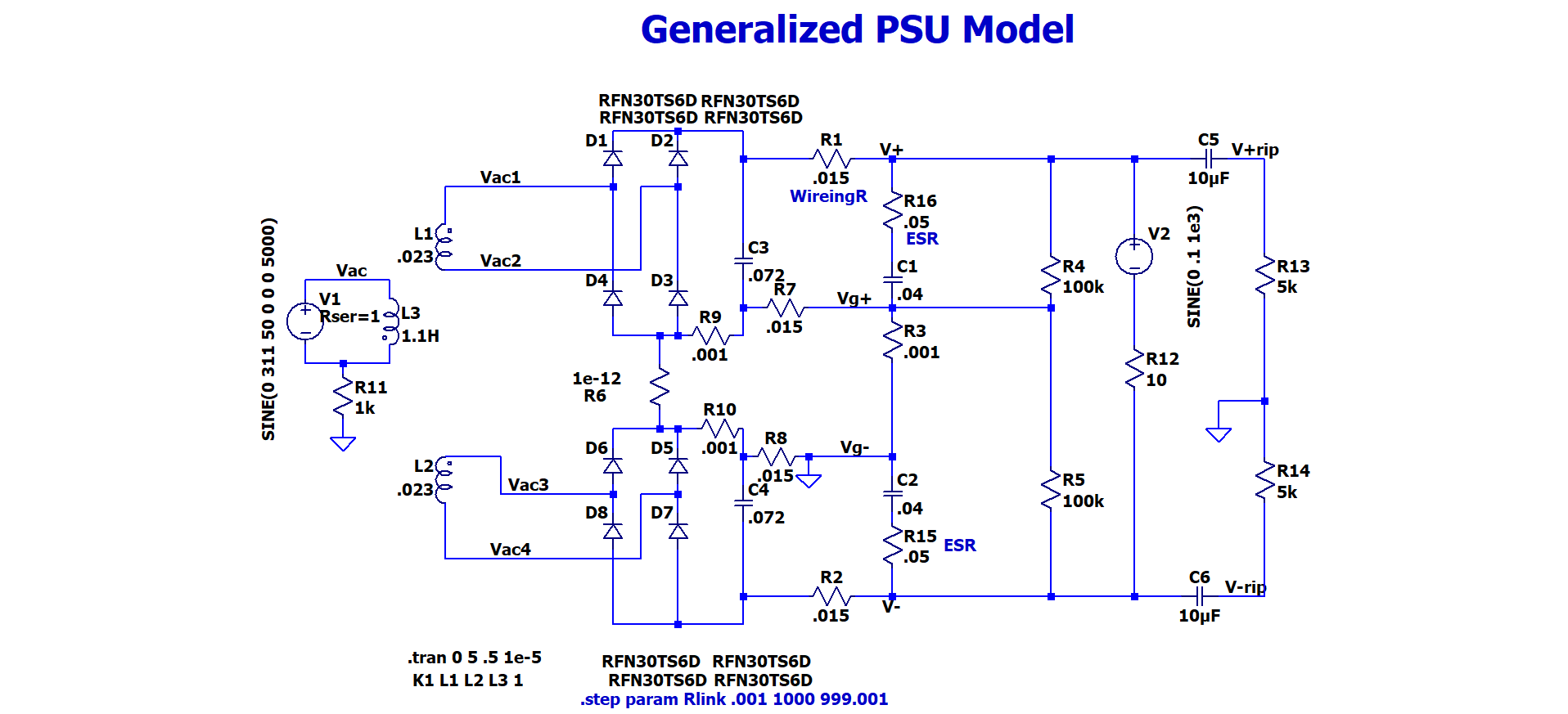

One of the builders has had a problem with his board in which he could not get the AC detect to work. We even suspected the UPC1237 to be at fault. However, he discovered it worked when he moved the AC detect input to a different secondary winding. I did a quick sim to look at the secondary AC voltages wrt his issue and have identified the problem - I should have seen this earlier, and as a result of his experience will have to add some additional notes to the build instructions.
Here is the test circuit - note the voltages Vac1 through Vac4

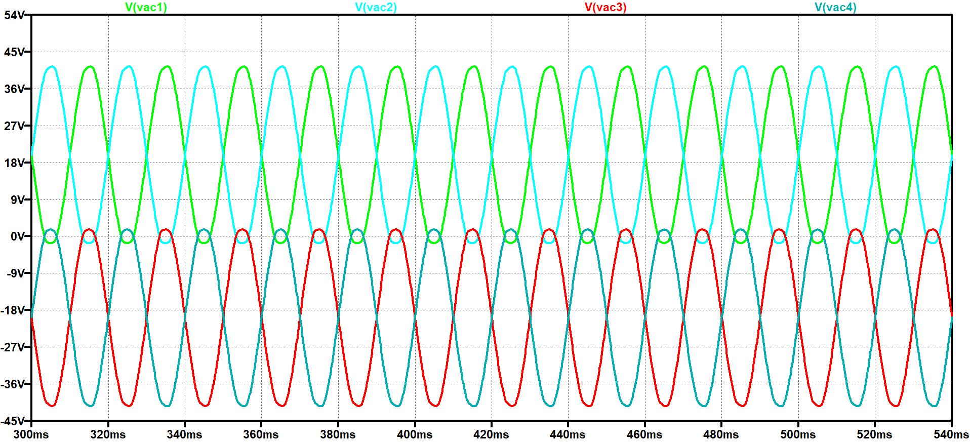

Here are the voltages Vac1 through Vac4 wrt 0V
What you can see is that Vac3 and Vac4 are effectively pushed down so they swing from ~0V all the way down to -40 V peaks. So, he was connecting to Vac3 or Vac4 on his build and that's why it did not work.
You can only link to Vac1 or Vac2 in split secondary power supplies like this that first rectify and smooth each rail before combining them otherwise the Speaker Protection Board AC detect won't work. Alternatively, you can wire a 2.2uF film capacitor in series with the AC detect and that will also work on any of the windings, but I think the best solution is to just stick to picking up connections Vac1 or Vac2 as shown here

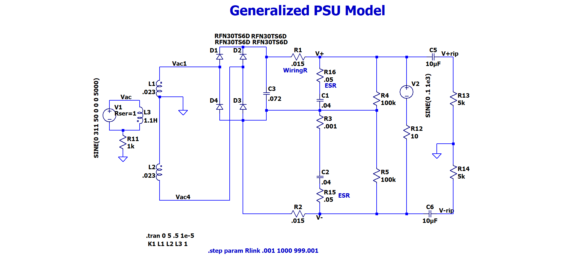

For split rail power supplies that use a single bridge rectifier like that shown below you can take the AC detect off either Vac1 or Vac4 :-

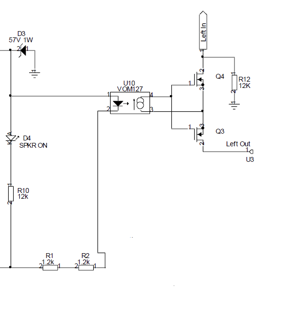

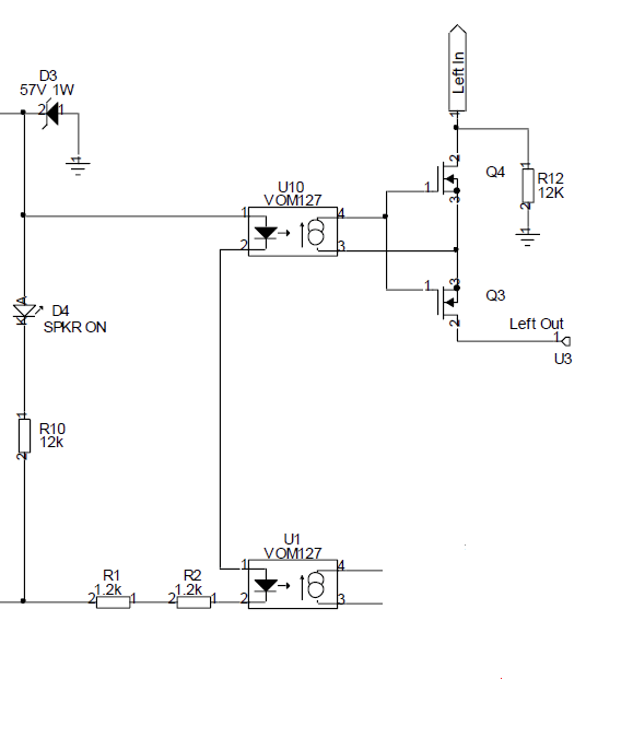

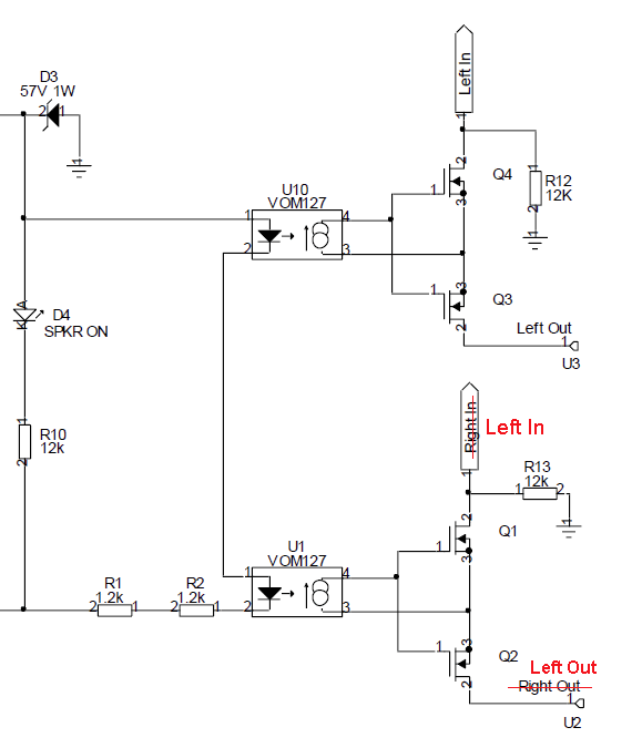

Hi Bonsai,
For my mono block amplifiers I will be using one PCB for each channel, what do you recommend:
  • use both DC protections in parallel for one channel
  • remove one optocoupler and its mosfets and use only one
