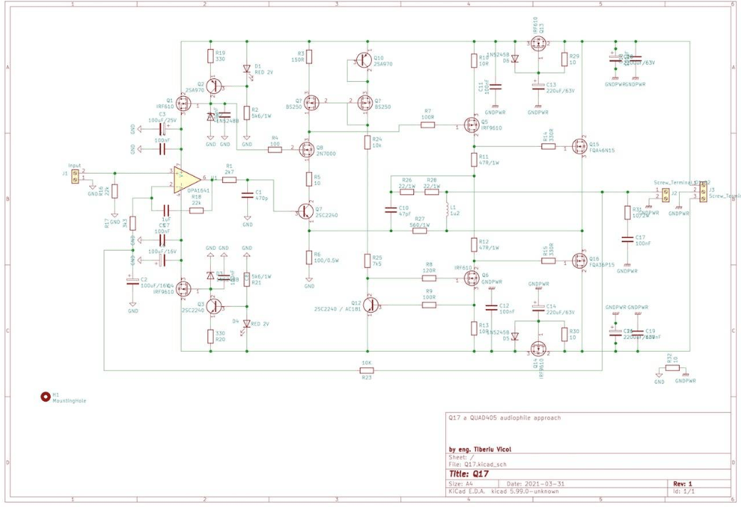

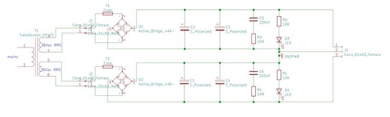

Hi Bonsai!
Do you think your board will work on this/my amp?
Thanks,
Ed

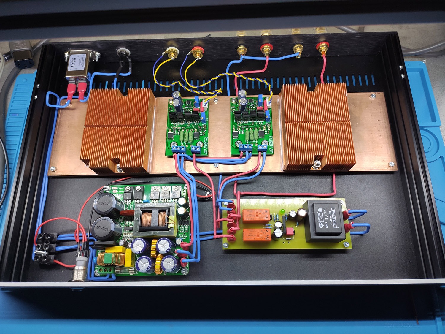

I Pmed you the board came in immaculately in short time.
I garthered all the parts needed for the L.S.protection board.
Left is the optocoupler VOM1271/TLP191. Cannot find it in stock anywhere within reasonable time. Can you suggest a suitable replacement maybe?
Is it safe to try Ebay?
Is TLP3906, 3910 a candidate?
Hope you have some hints for me...
Ed

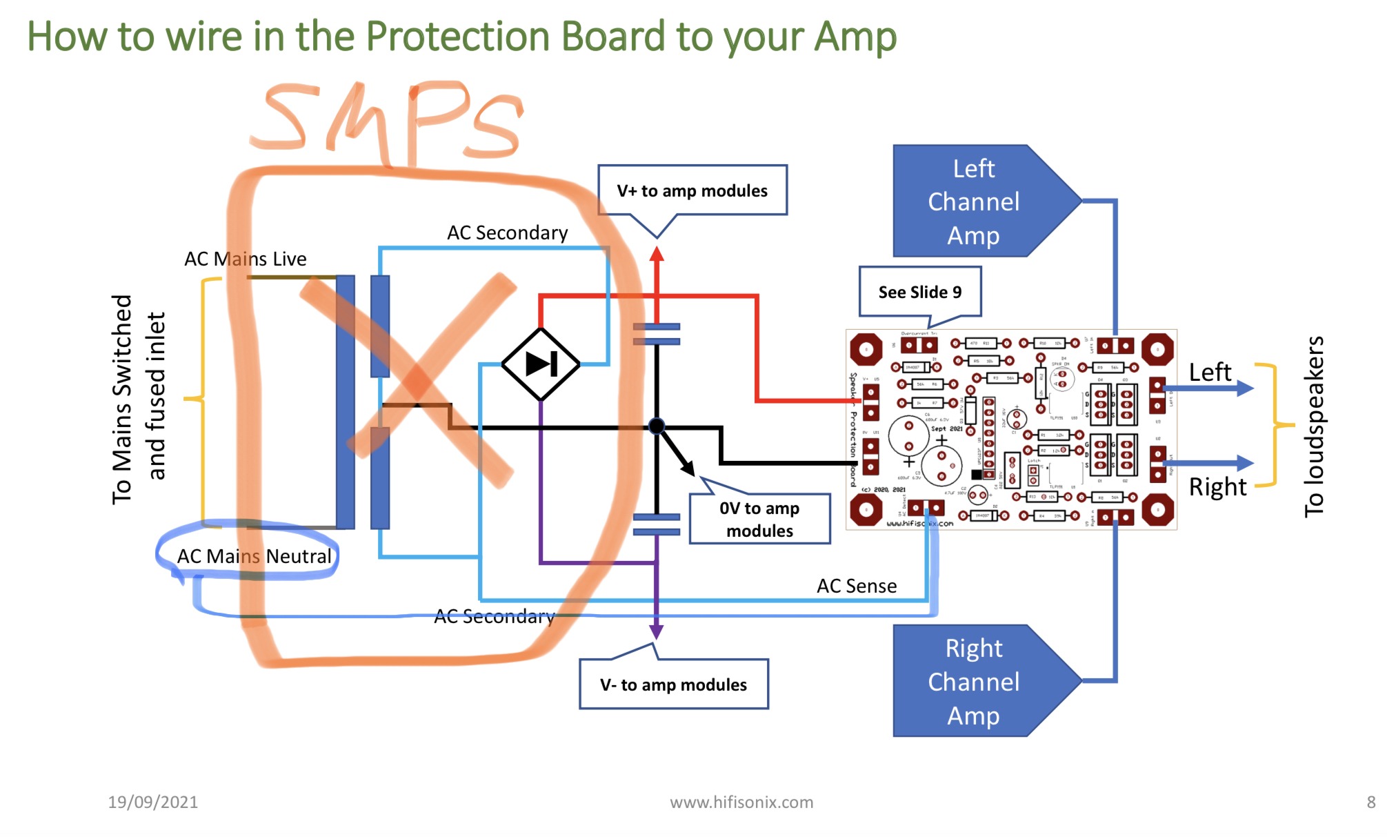

Bonsai, does your protection board require a linear power supply to work with an amplifier? Would SMPS-powered designs not be feasible (no accessible secondary AC)
Hello von Ah
Apolgies I only saw this now. The speaker protection board needs a line frequency source in order to function correctly. When it senses mains power has been removed, it disconnects the speakers within a few 100’s of milluseconds.
No worries. Thanks!
For another perspective on my question, regarding your block diagram of connecting the protection board in an amplifier:
Could the AC sense on the board come from the AC mains inlet when using an SMPS instead of a linear power supply? If the transformer and rectifier are replaced by an SMPS, would the AC sense still work? See attached markup (mains neutral or live connected to AC sense).
I appreciate your help.
