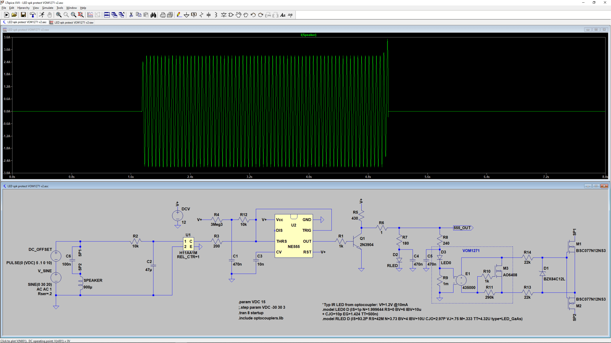

After one day of reading various sources:
It seems to work perfectly, in ltspice at least, since I don't have opto parts at hand to test it (it will take approx one month for them to arrive here). The circuit needs external power to run, everything from 5 to 15V (Vcc range of NE555). Resistors R5, R6, R7 and R8 shall be adjusted in case of different supply voltage and different diodes.
D2 is status LED, it is on when the speaker is on, but if one want to make it show the opposite, simply move it together with R7 to OUT pin of NE555.
I used C4 and C5 to remove switching spikes on LED, but they are probably not necessary.
C6 is paralleled with MOSFETs, as shown on ESP page. The simulation runs very slow without it, so it is probably needed in real life, too, although I didn't see it on other similar designs. D1 is also from that page.
Hifisonix also has 12k resistors from speaker leads to ground for some reason.
So, if anyone is interested, you are free to comment or try the circuit. I will build it once the parts arrive. Please find all the ltspice files in an attachment, I hope I didn't forget to include all needed for this to run.

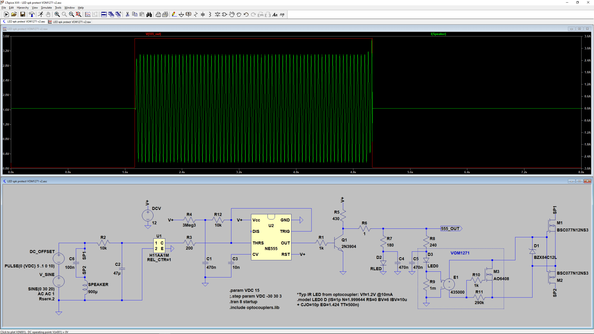

After noticing that there is a big voltage spike between MOSFETs while switching off, I added R13 and R14 and the spike is gone. Probably additionally protecting VOM1271 as well.
However, I see that, whatever I do, this kind of switch produce crossover distortion. No idea why and how to remove it...
It seems that crossover distortion is gone if I use different MOSFET for switching, and it works with both PMOS and NMOS (just have to connect gate to the opposite). IRF540 works really fine in simulation.After noticing that there is a big voltage spike between MOSFETs while switching off, I added R13 and R14 and the spike is gone. Probably additionally protecting VOM1271 as well.
