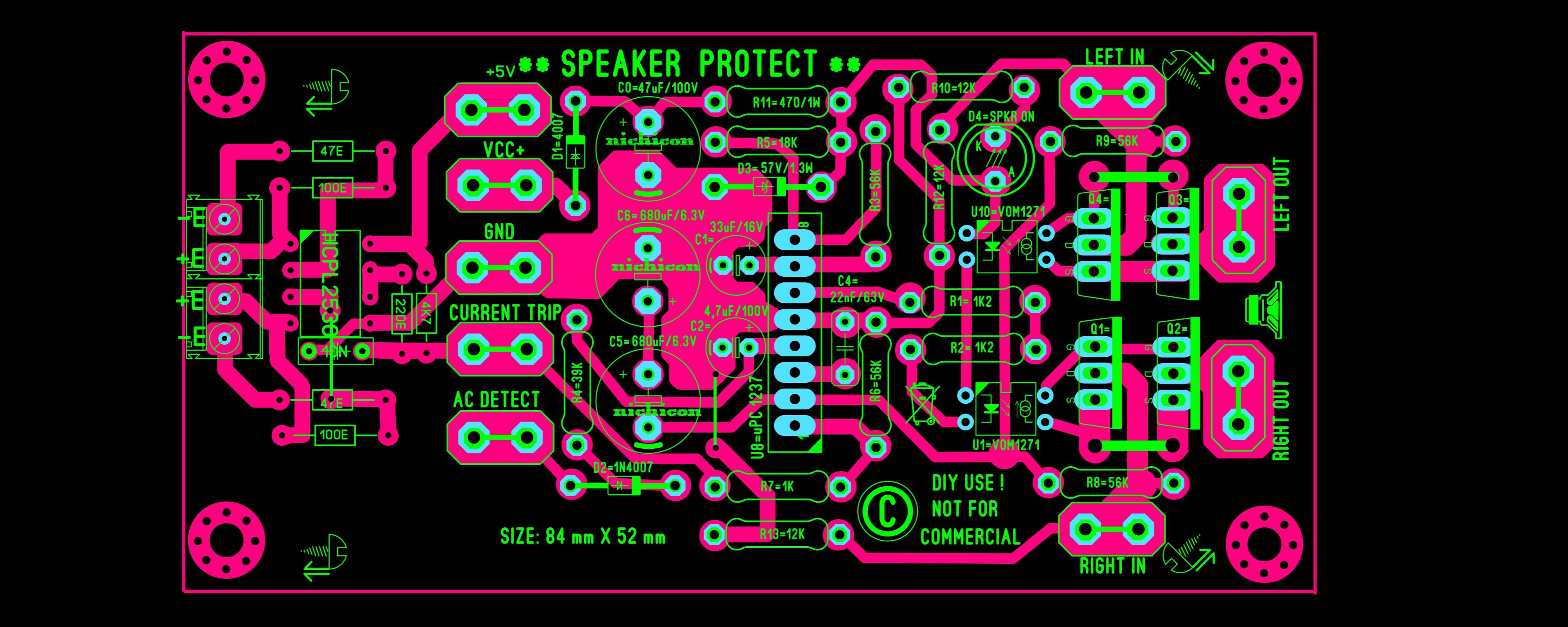

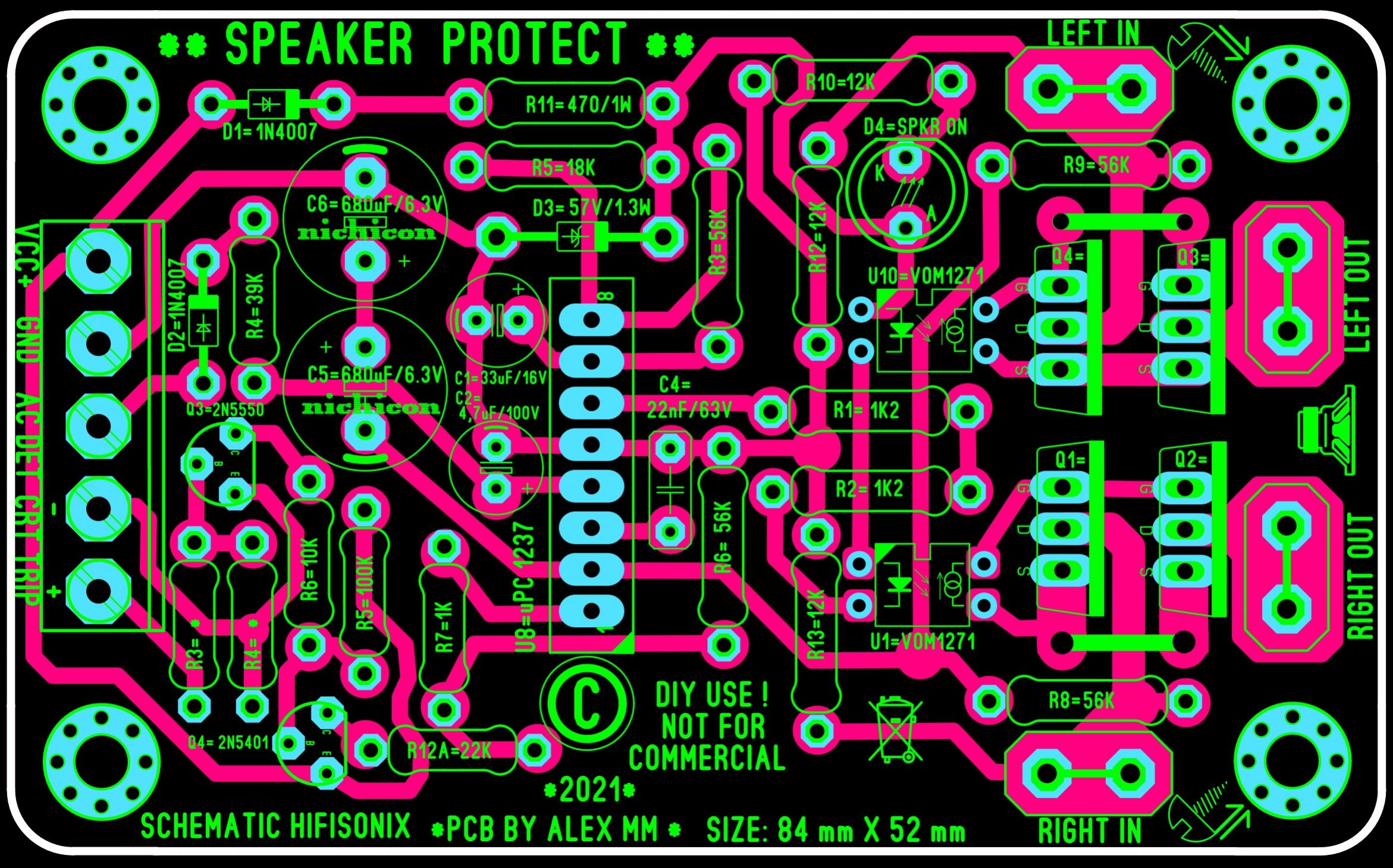

You could have just ordered a board for $9.50 + postage Andrew
Hi Andrew
In my opinion it's a good design that you have put up and it's very well documented on your site.
You must have used some of time to design the circuit and to do the PCB layout.
I'm sad when I see that some are actualy taking a finished design and do their "own" PCB layout and plan to sell it at a few cents lower price.
It seems like Alex MM is the so called PCB "designer"
Does anybody think think that Alex MM will answer any technical questions regarding the design?
No, the plan is to "take the money and run" and leave it to Bonsai to answer all the technical questions even if they bought the boards from Alex MM.
It's too bad
Stein
AlexMM is indeed a very good pcb designer. I tried to buy some boards from him a few years back and he told me he never sells boards and he never shares gerber files.Hi Andrew

Now , I am not sure how Andrew got this board designed by AlexMM. Maybe he wants to explain this .
Bonsai , I am getting this board from you for sure, but I don't have that uPC1237, any trusted sources in US?

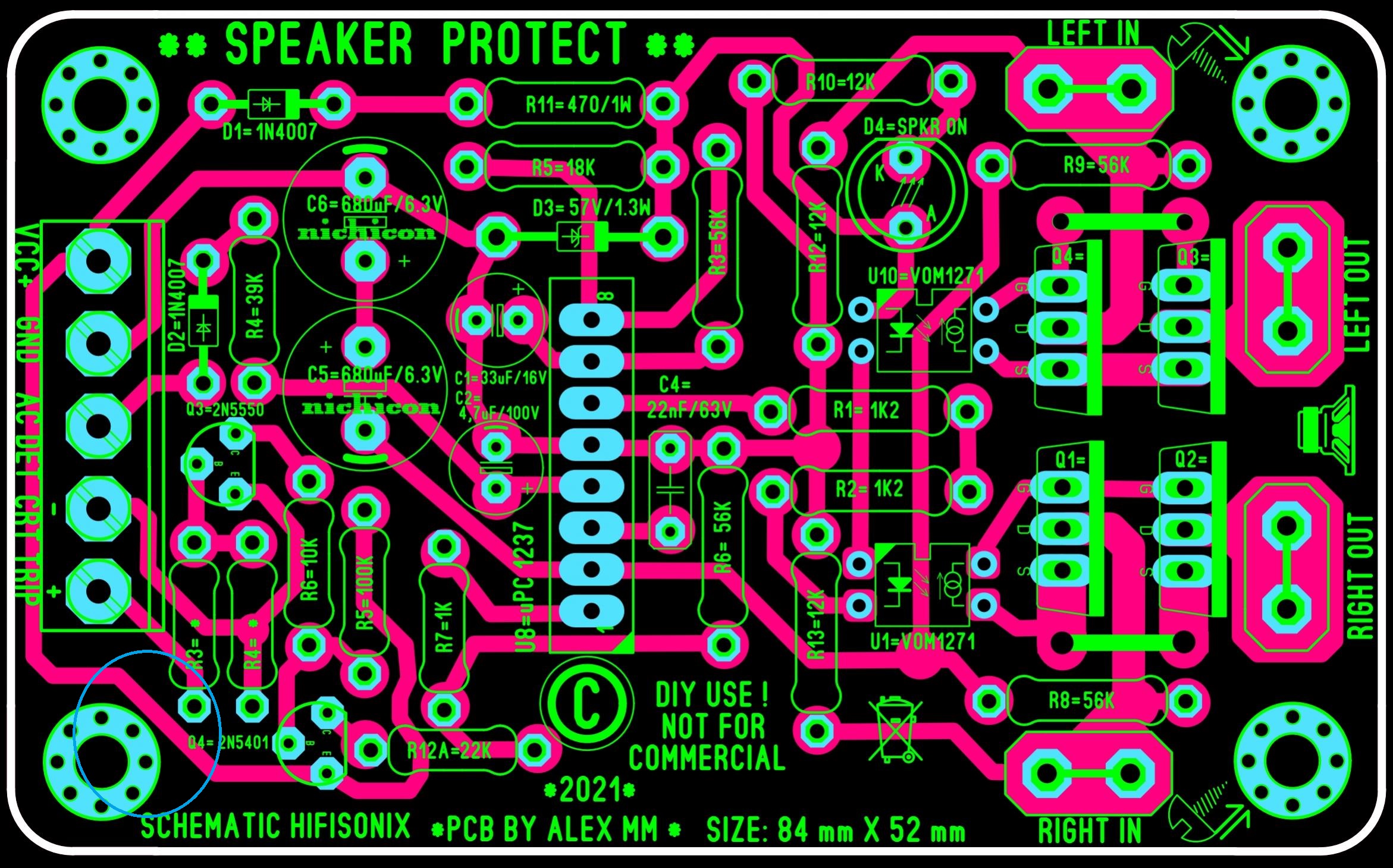

Did you try ASSR-V621-002E , Dual channel photovoltaic Mosfet Driver?
what is the differance between ASSR-V621 and ASSR-V622 photo-voltaic FET drivers?
https://docs.broadcom.com/doc/AV02-0259EN
what does this mean for the connection to g/s of mosfets?
reverse the connections or use p-channel?
THE OUTPUTS (NOT THE INPUTS) ARE REVERSED
Yes you are right, it is the output that's reversed.
You could do either. The output is a self contained floating supply so either device could be used with either P or N channel, just connect accordingly. If you mess up the layout and get them reversed, use the other device instead.
You can also stack the two outputs (ie wire them in series) to get much faster switching times. Since the input to a power mosfet is capacitive, it follows from basic principles it=CV that switching is faster with the higher voltage because the CV product is greater. .
On my commercial,smps, I switch 60A in under 100 us using this technique ( I used 2x VOM127 per channel).
