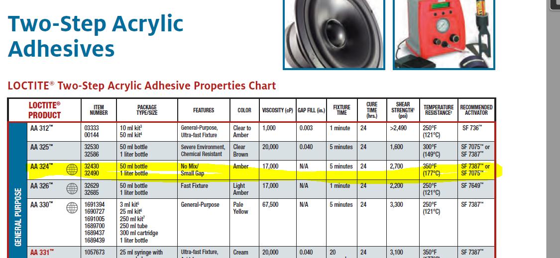

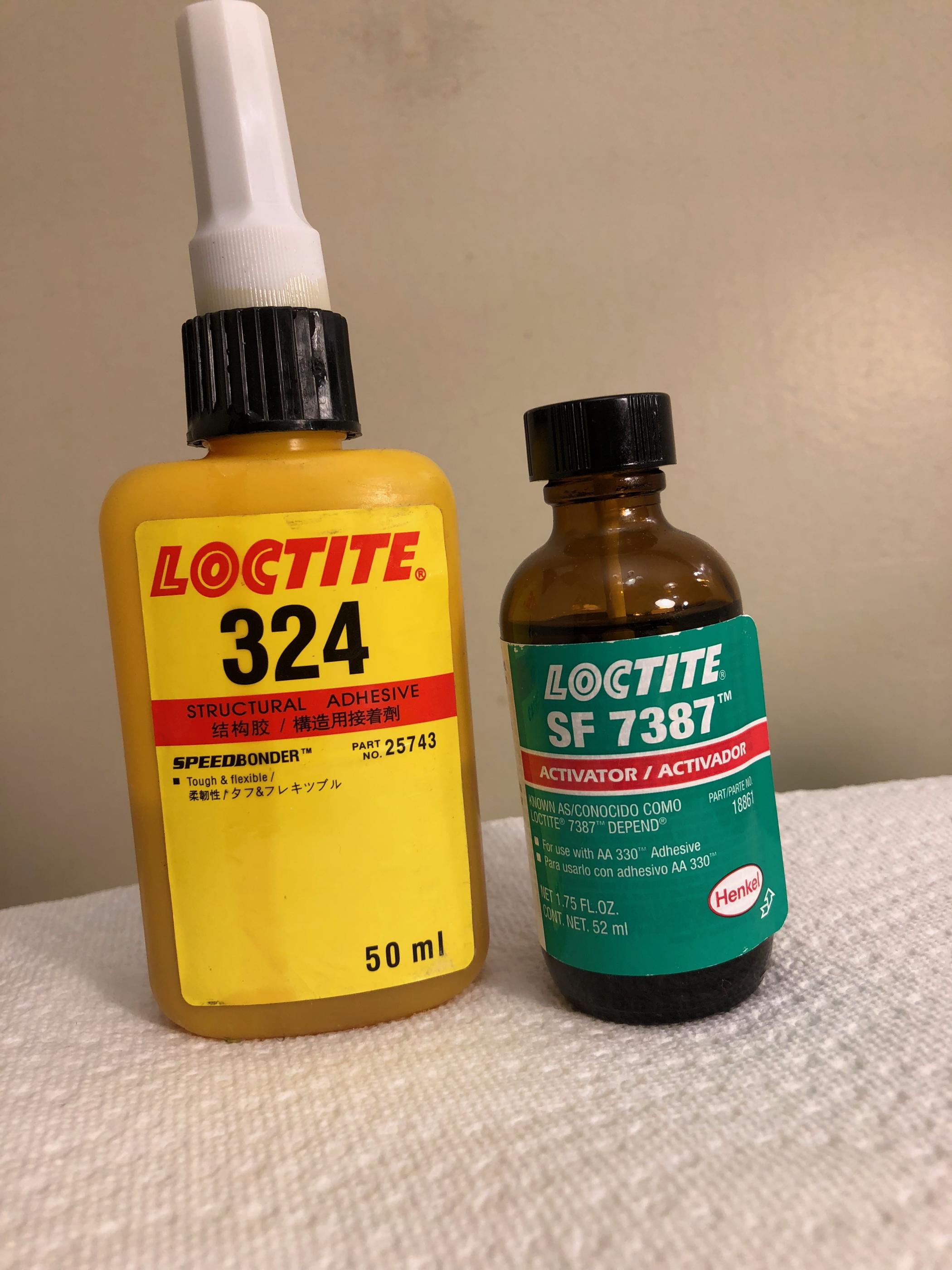

LocTite324 with SF3287 Activator
I used LocTite324 and activator SF3287 with good results on my Kirksaeter Monitor 80 double magnet tweeters which after about 30 years the second magnet fell off both speakers. Ron

Loctite 326 with 7649 accelerator
I've ordered some 326 to re-glue the magnets on a pair of ns-10s', it's cheaper than 324 in my part of the world.
From the datasheet: https://www.farnell.com/datasheets/40157.pdf
"LOCTITE® 326 typical applications include bonding ferrites to
plated materials in electric motors, loudspeaker hardware..."
"Suited to magnet bonding", "Temperature resistant up to +120°C"...

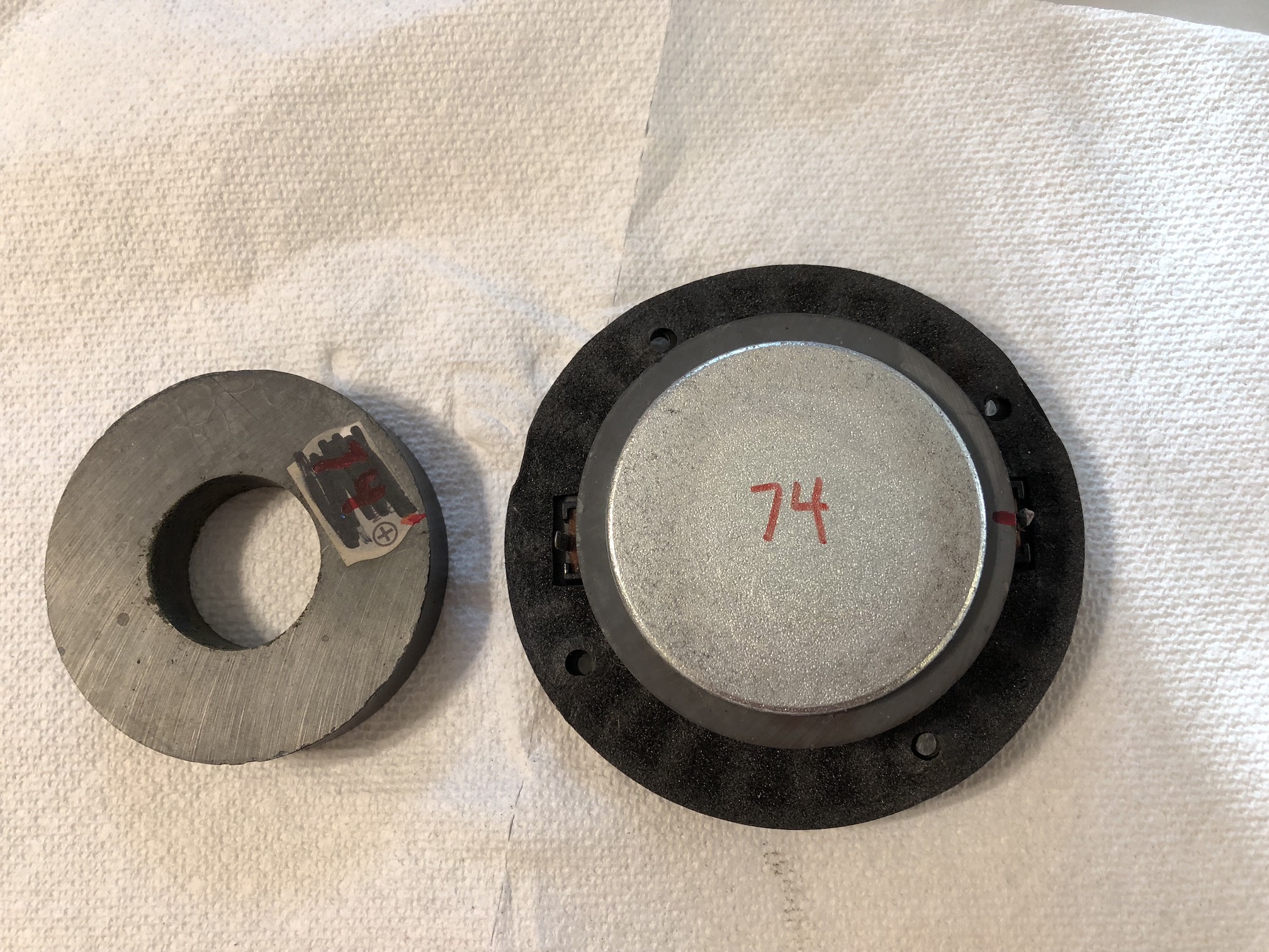

A question for rlj, does the donut magnet that you indicate have to go on in a particular orientation in respect of the magnet it is being reattached to. I ask because I have some old tweeters with a similar setup and in both the bottom magnet has come free. Glenn

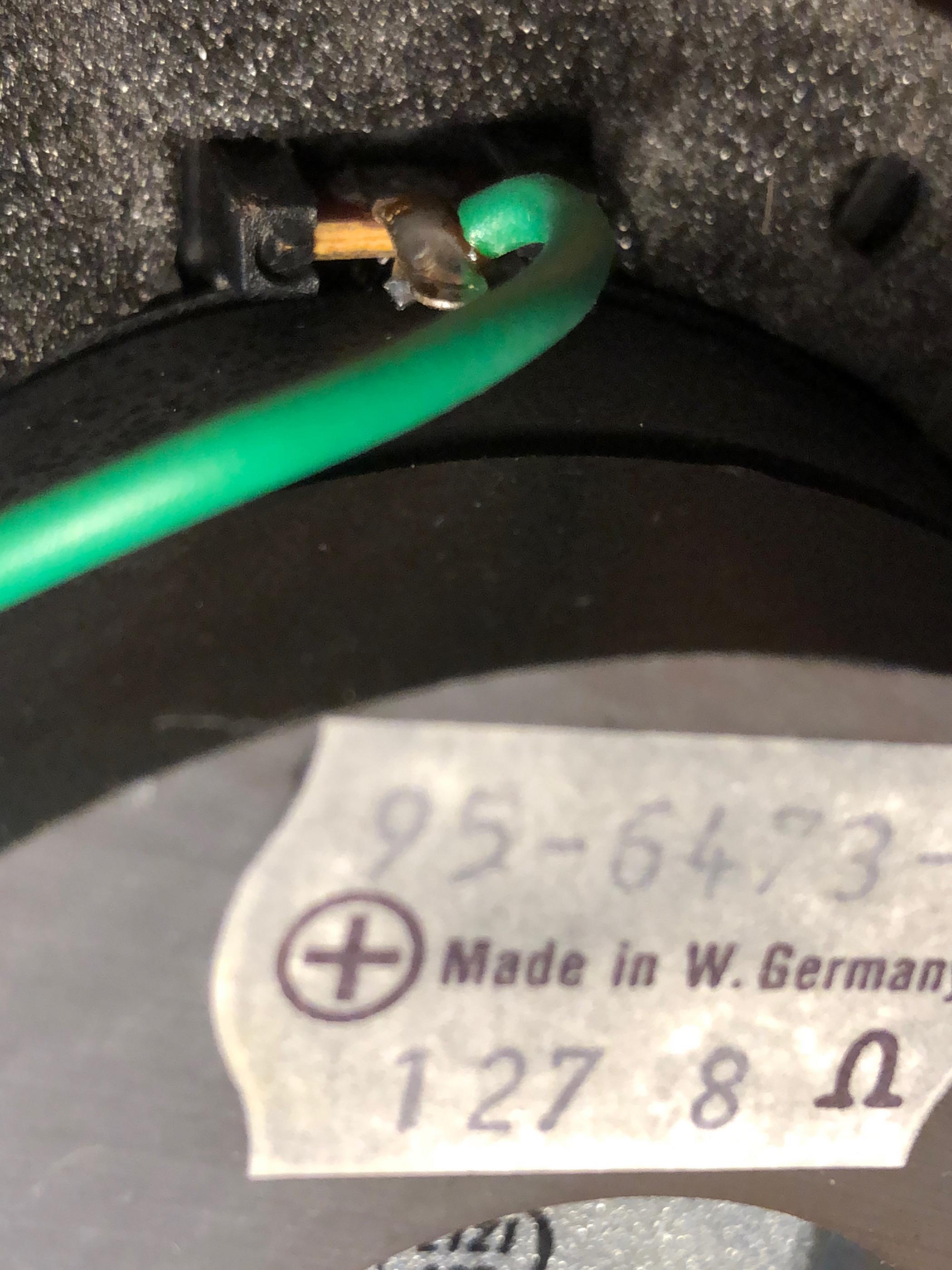

I don't believe so. If I were you and I'd use the epoxy that have proven results. My donut magnet had the + pole marked with a sticker. It would only stay on the base magnet when the + pole was carefully aligned over the - pole of the speaker magnet.

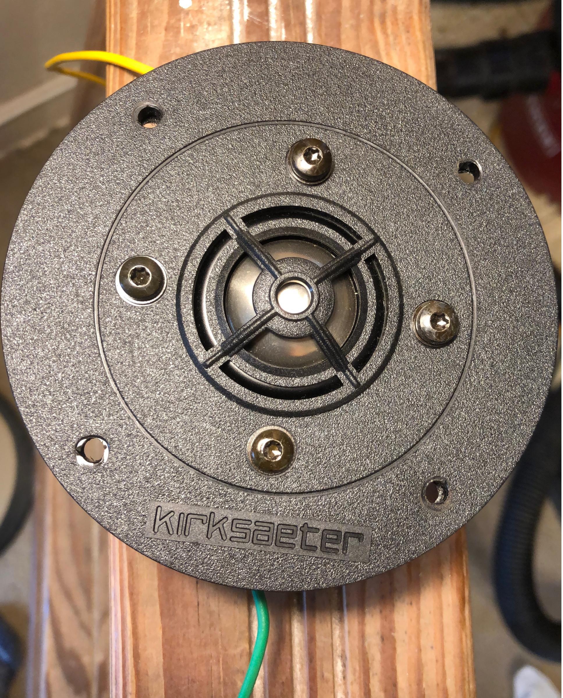

I did not have to set the voice coil. The second magnet simply fell off the speaker and had to be re-glued back onto the first. Attached is the front face of the tweeter. It is a titanium dome tweeter.
