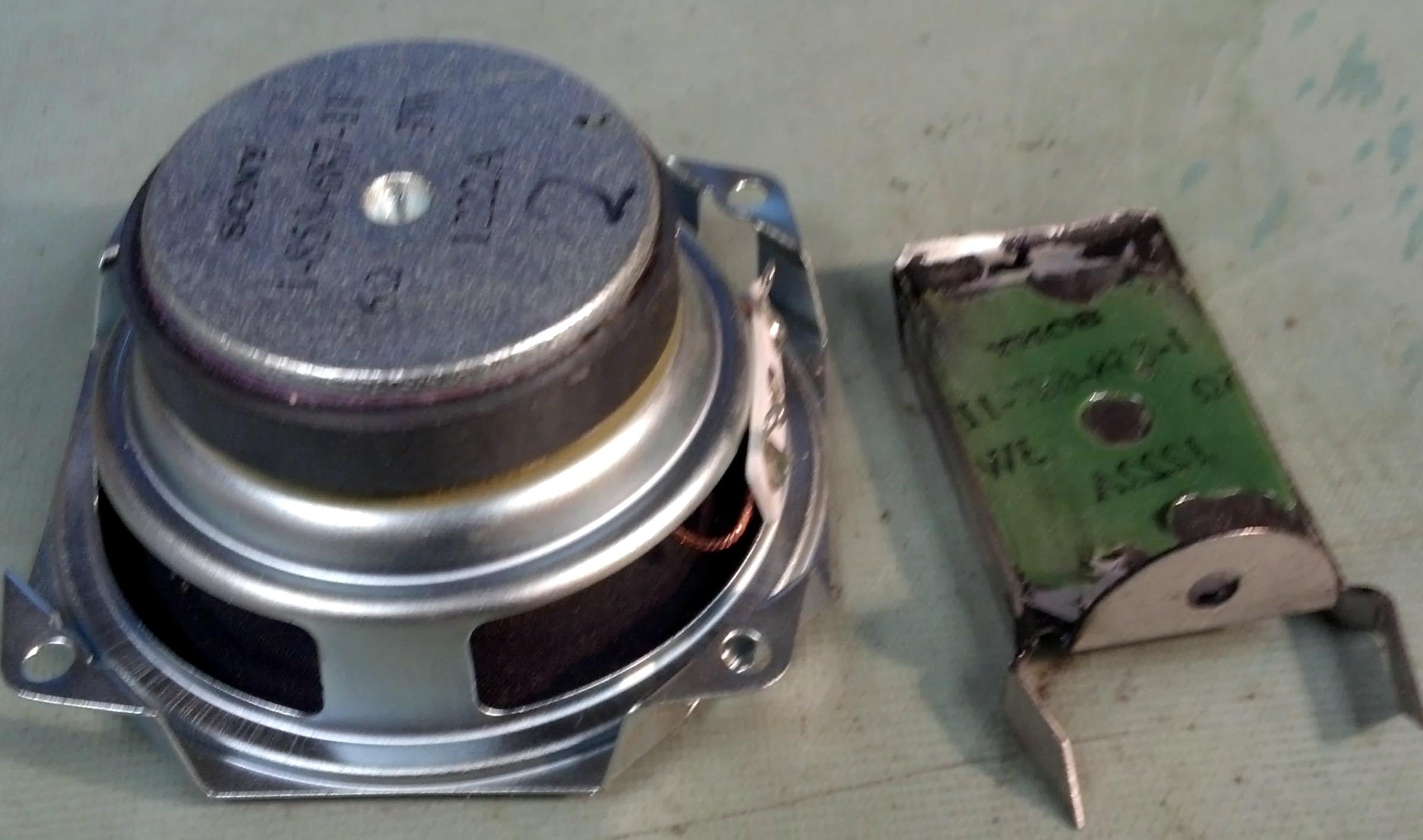

But my first project is as described above. So to test various types of glue. I have a case of these little crappy 3" sony speakers that have now become test mules! I cut some pieces of scrap sheet metal to simulate the speaker basket and planned to glue them to the flat backs of the speaker magnets. this should be a pretty close way to simulate the actual job at hand. I stopped by my local hardware store and picked up 3 types of glue that all said they worked on metal and ceramic that looked like they might be promising.
My past experiences with epoxy have proven to be way too brittle. so I ruled those out to start with.

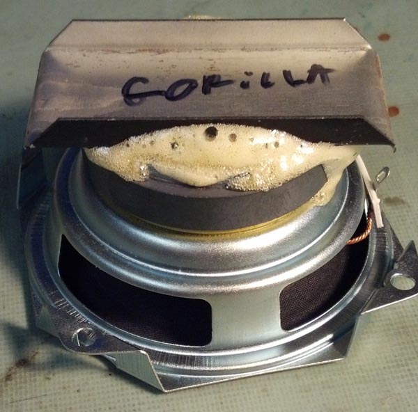

I first tried Gorilla glue. I have never used Gorilla glue but have heard many people say it's great stuff. However i was unaware that it is a foaming type glue! and it is cured by moisture. which makes this a very UN-ideal glue. But out of the 3 glues i tried. it had the strongest bond.
2nd I tried Elmers Probond. consistency of watered down elmers glue. almost no bond and in fact was still wet inside after 24 hours of cure time. don't waste your time with this stuff.

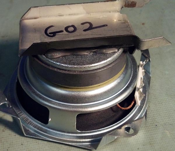

3rd was Loctites GO2 glue. this is interesting stuff. thick, dried clear has a dried consistency somewhere between hot glue and silicone. almost no bond, but I would use this stuff for gluing down crossover parts, connectors etc. I love this stuff for that application but not for gluing metal/ceramic speaker parts.
So it is clear that I am going to need some industrial type product! local hardware store bought stuff just isn't going to cut it.
