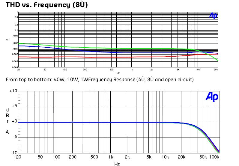

Yep; that's the spec in the UcD180HG datasheet. Might even be enough to pry me off class AB, though I'd like to work through the parts spec on the UcD180 module, HG supply, and HxRs first. Not sure if there's a way of doing that without buying them though and the spec on the ADAU1592's nearly as good for my purposes.Hypex I presume? No wonder the top end is "dull".....![]()
