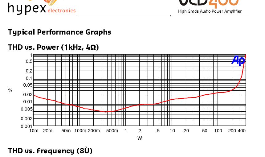

Here the data sheet of the 400W amp. The lowest thd at 500mW perfect in the area where we normaly listen music.
http://www.hypex.nl/docs/UcD400HG_datasheet.pdf
attachment.php

With my horn witch goes up to 30Khz it has extreme low thd (at 105dB around -57dB second and around -80dB third harmonic!). It sounds warm with detailed high tone's but not as fine pin pointing as the vintage VFET amp.
