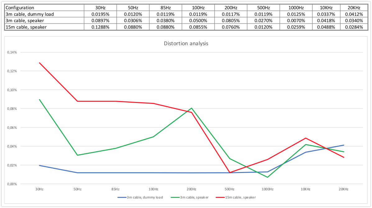

vzaichenko said:
Assuming the amplifier's Zout is low enough, it also improves the speaker's damping and reduces the voltage fluctuations, caused by the speaker's impedance non-linearities (the speaker is driven "harder" with a better cable).
As a result, I expect the total distortion, produced by the speaker with a lower-impedance cable, to be lower than the total distortion, produced by the speaker with a higher-impedance cable.
The distortion in the speaker's acoustic output may be improved or reduced by adding resistance; that depends on exactly what effects are causing the acoustic nonlinearity and how they correlate with impedance nonlinearity. However, you were not measuring acoustic distortion but current distortion. The cable resistance was merely the current sense resistor - this is the point which some people seem unable to grasp, wedded as they are to the tired and unphysical idea that speaker cables are a source of distortion themselves.

This thread is getting increasingly silly. It appears that many contributors are confused by the physics and maths of a simple potential divider.
I was the one who stumbled upon the higher distortion FFTs and alerted Valery to it. I think his data clearly shows that there are effects of the speaker cable on the FFT. It’s not the same as no cable for sure. Whether or not one wants to believe that the cable is the cause of the changes is something that is being argued ad infinitum here.
If you have a sound interface, connect it to your dummy load with and without cable. See what you get. Yes, take all proper precautions to ground properly. You will still see distortion. It’s not the cable that makes the distortion visible - imagine a very short 5cm cable. It won’t be the same as long cable - it will be close to same as no cable. The effect is caused by the cable not that the cable makes it easier to see.
I have seen distortion in an amp change via simple substitution of one brand of thin film resistor vs another (Vishay vs Panasonic) in the feedback or output device source resistor, and I get different harmonic profiles (relative H3 was higher va H2 on one and vice versa). That’s a single 2cm long part. It doesn’t surprise me that a 2m long multi stranded cable with insulation might have something non-linear going on.
I am confident that all here will agree that there is an effect. However, it is not nonlinearities in the cable that are causing the change, it is the cable's impedance which is changing the outcome. With no cables, the amp has the best chance of fighting the non linearities, a resistive cable makes it less possible for the amp to do so. Think of it like a spring...a slinky suspending a golf ball vs a garage door spring. The slinky has less control of where the load goes..yet, both are still linear within the range of operation. (granted, this analogy falls apart terribly fast as springs are typically linear over a range of extensions then become highly non linear prior to plastic deformation).

Probably "minimise" is not a good word in my statement - something like "reduce" would be better. However, my thinking is - a low-impedance cable does not only make the speaker's impedance non-linearity less visible.
What do you think?
Some measurements with a microphone might be the only way to really see the true end result of cabling changes.

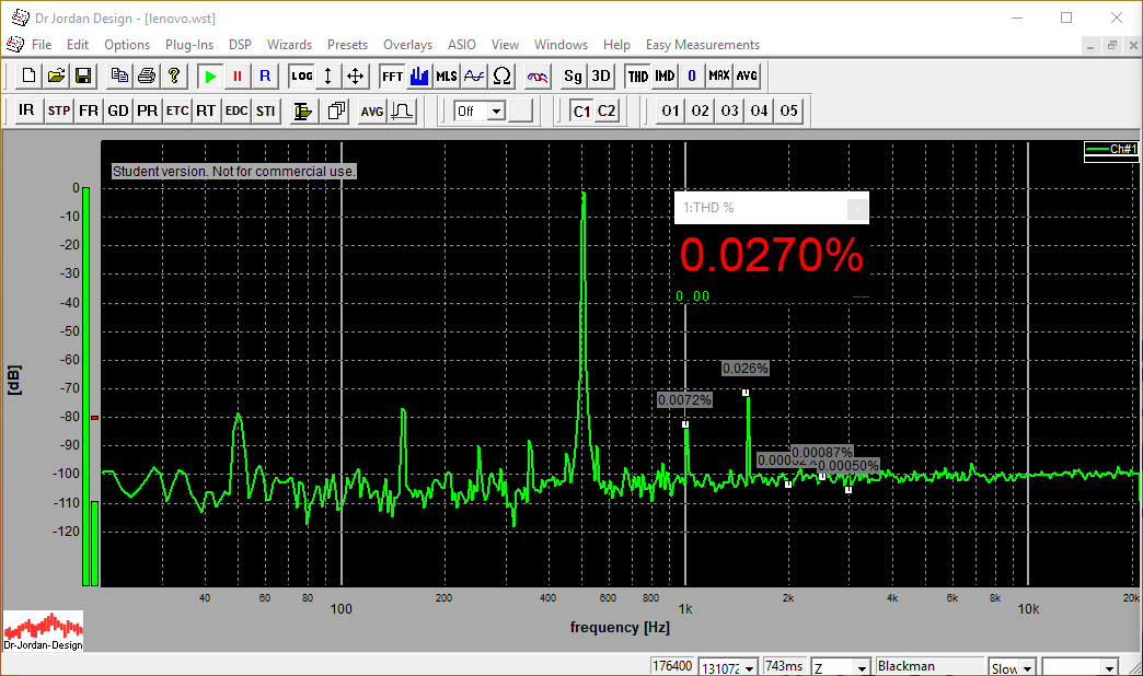

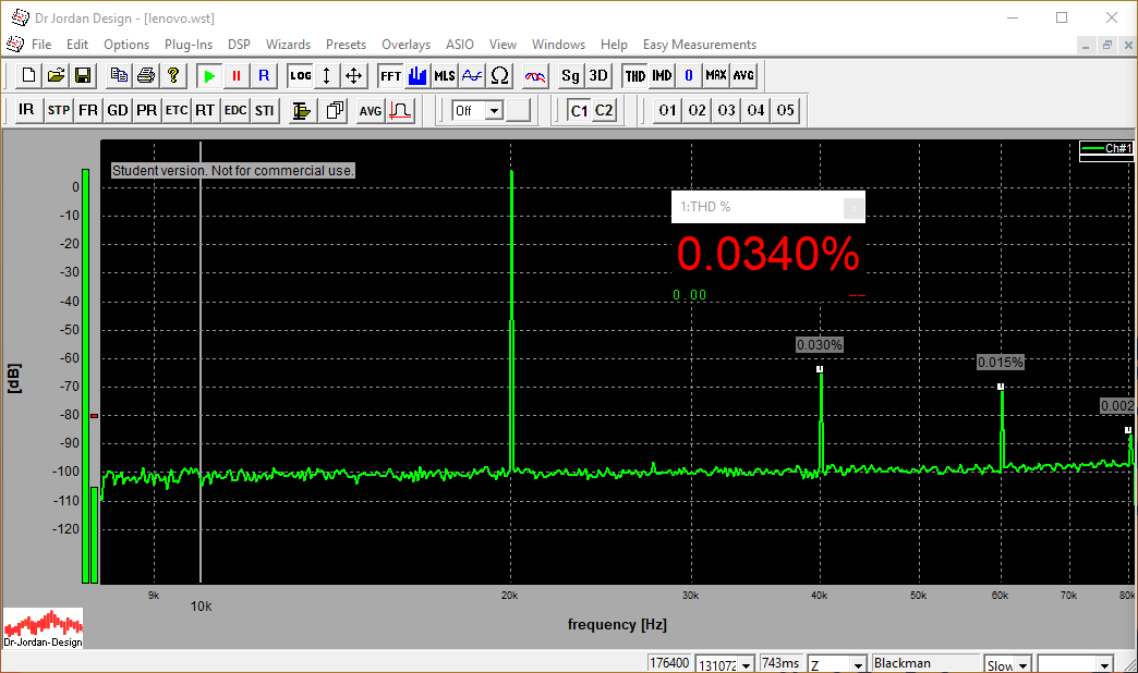

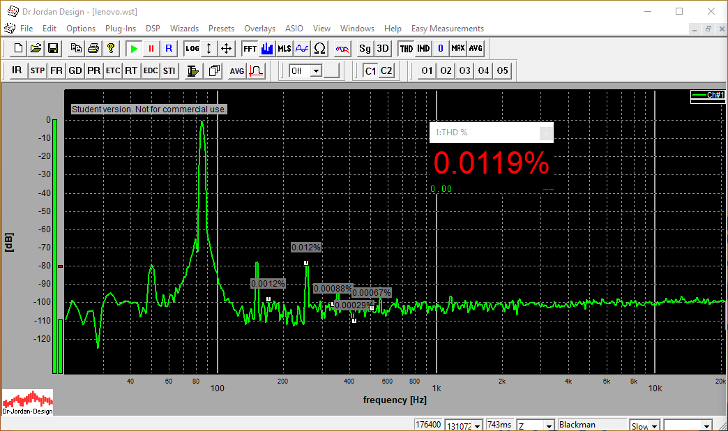

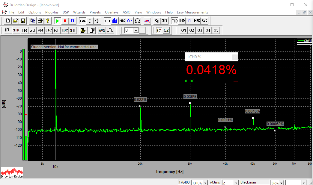

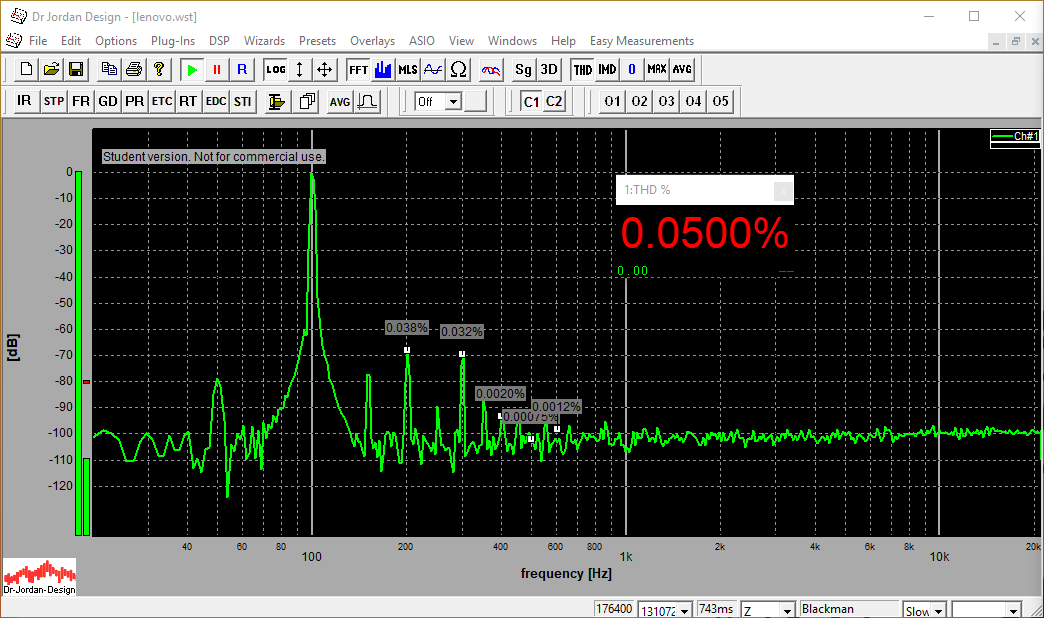

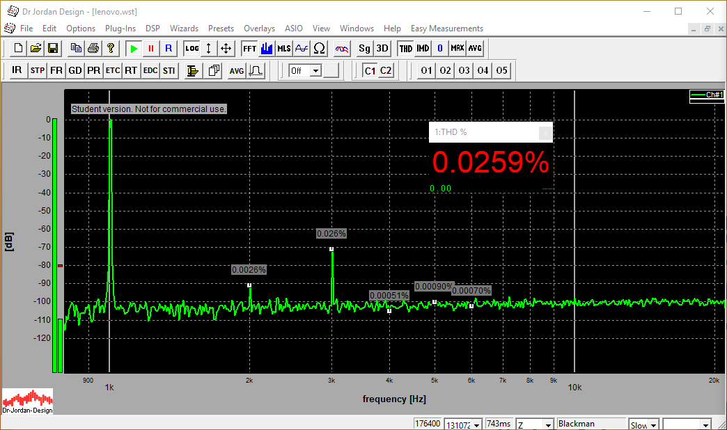

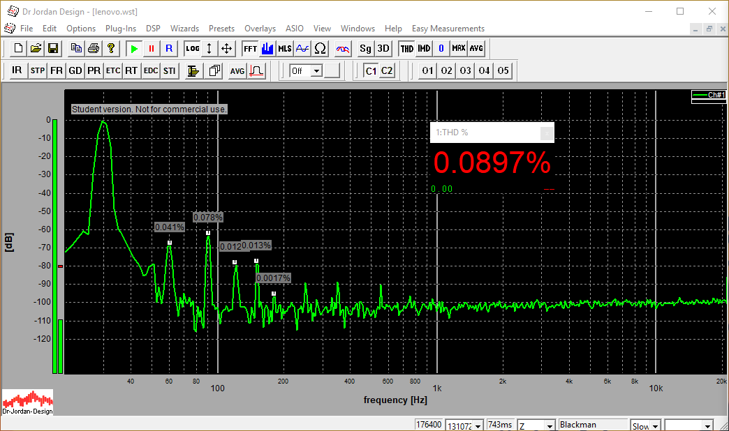

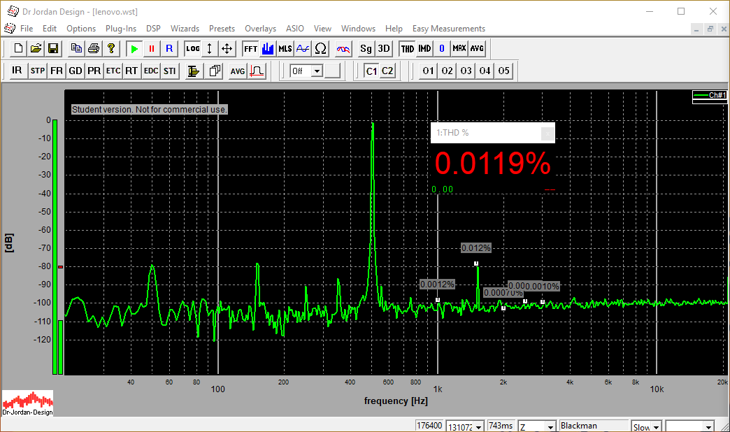

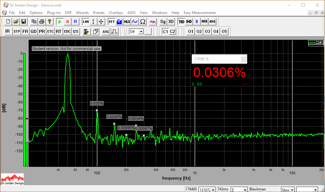

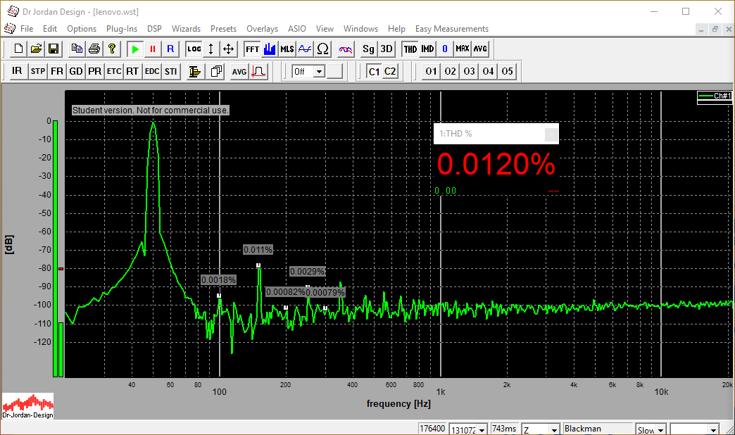

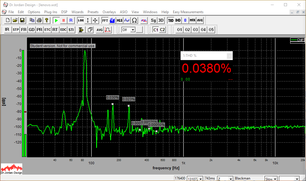

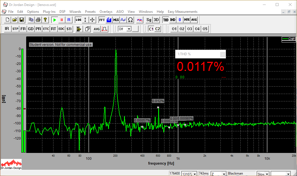

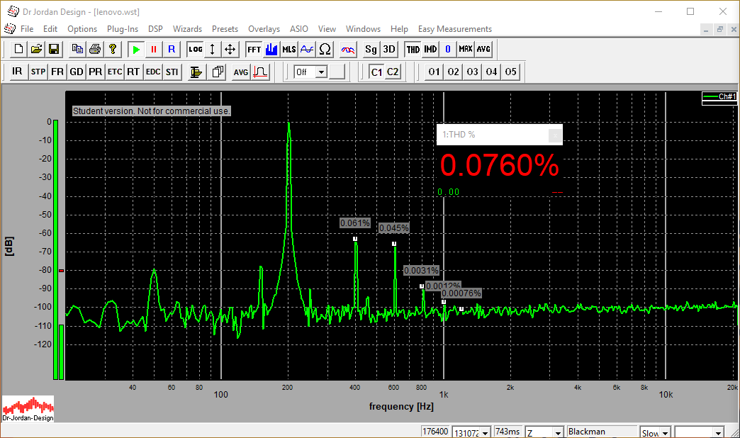

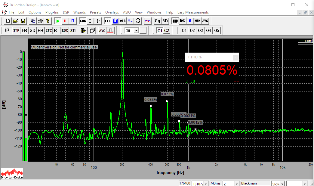

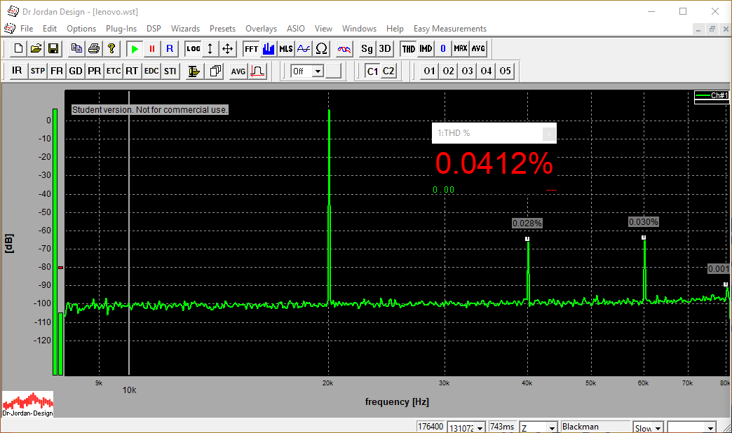

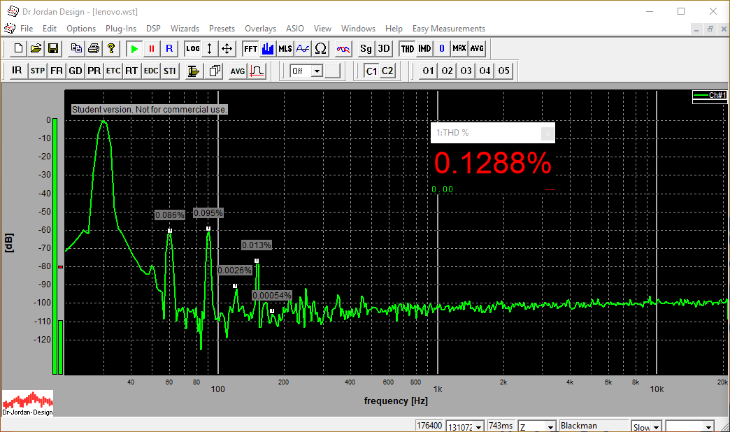

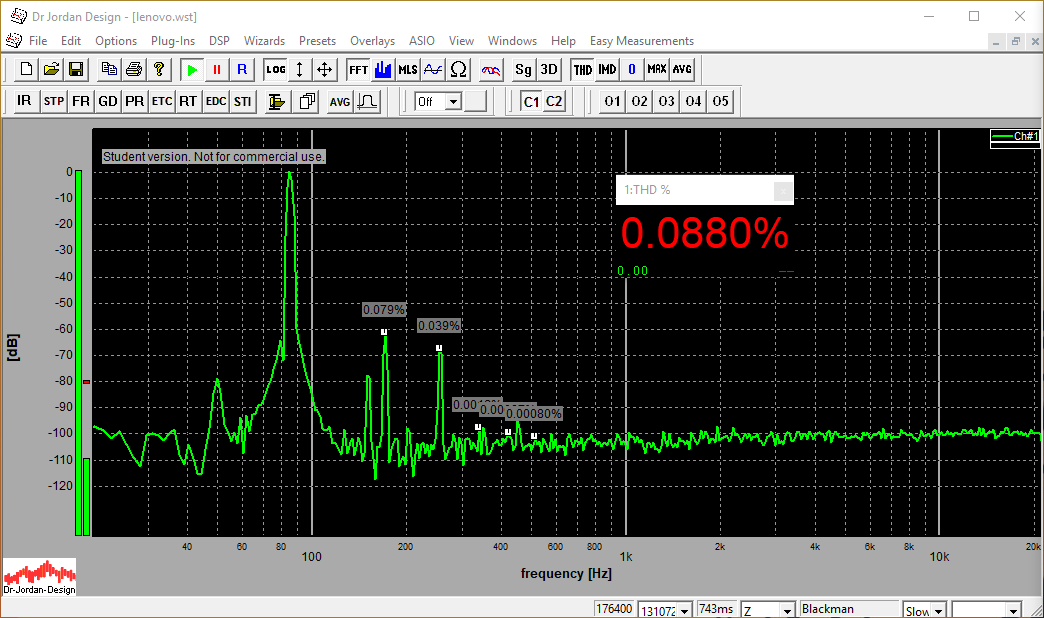

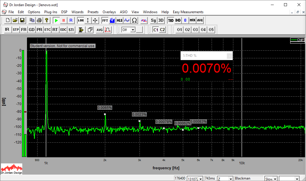

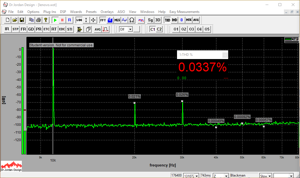

Current in 3m cable with 8R dummy load
OK, here are some more spectrums - measured across the cable wire.
This set if for the dummy load at the end of the shorter cable.

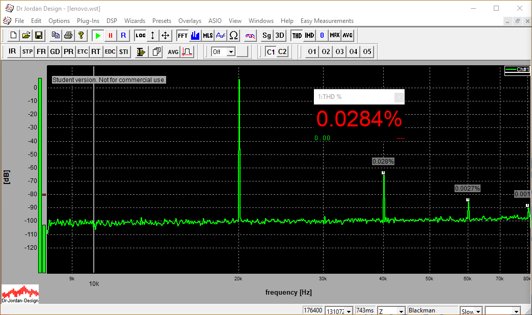

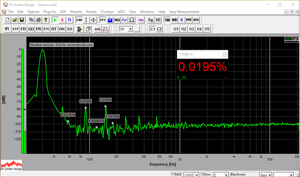

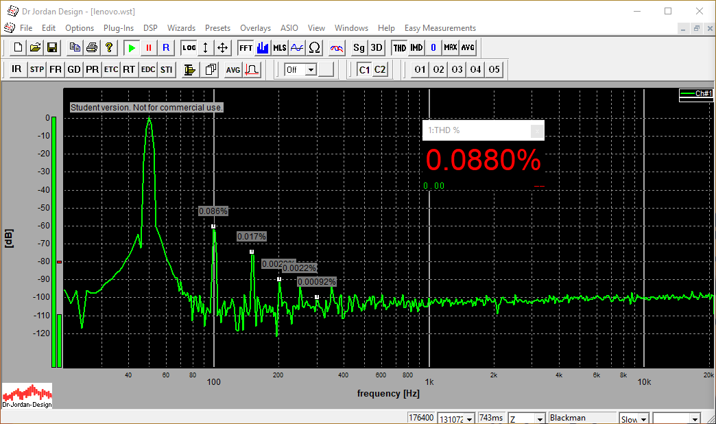

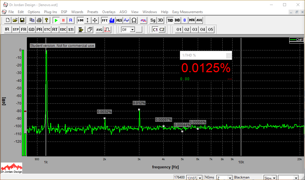

Current in 3m cable with the speaker
Now - short cable with the speaker.

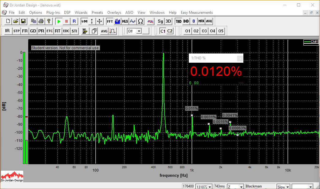

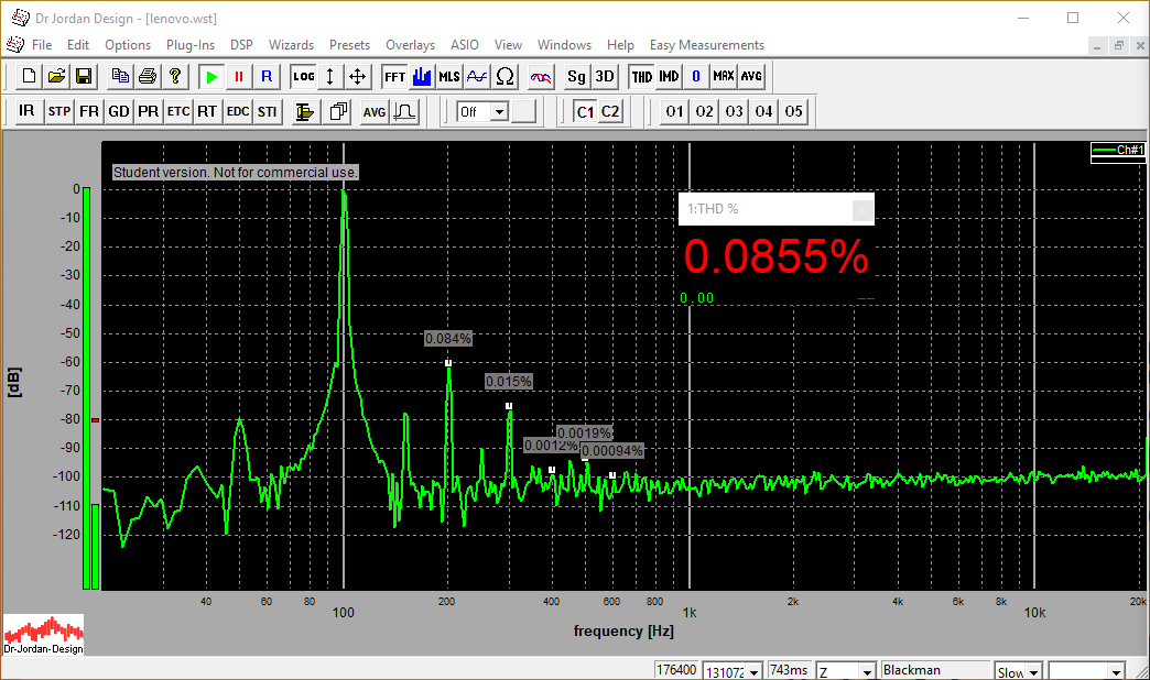

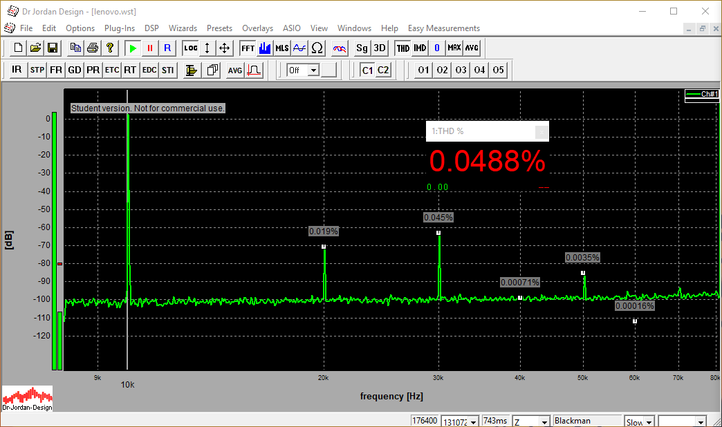

Current in 12m cable with the speaker
Finally - longer cable with the speaker.
