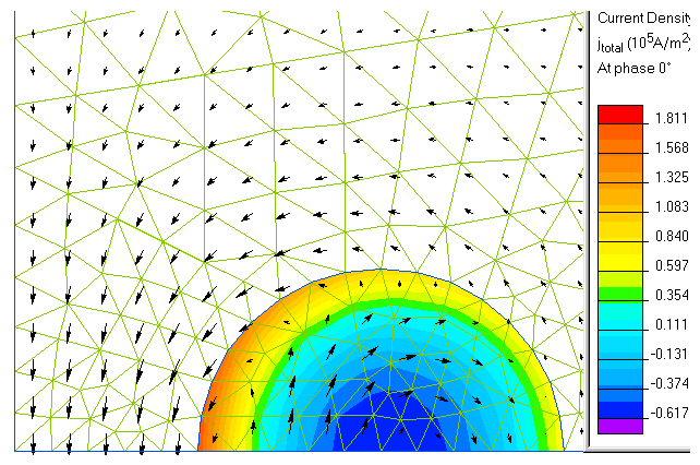

for most cables Proximity Effect is larger than Skin Effect
isolated cylinders aren't too useful as audio cables, the proximity of the return current conductor greatly modifies the current distribution

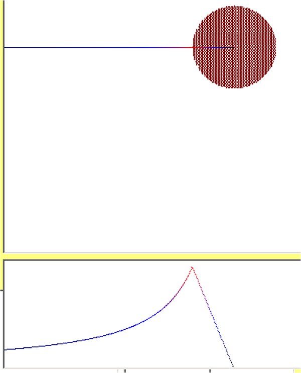

quickfield seems to be fairly complete for 2-d eddy current simulation, "time-harmonic" and "transient magnetics" simulations can vary conductivity and permeability, transient can model nonlinear permeability but both ignore permitivity-displacement current so it isn't a full E-M simulation
the student version is the first free E/M simulation package i've gotten to do anything remotely plausible without crashes and seizures, i was also able to create my own models and run them with only a few hours of playing with the user interface
cool pictures and most numbers you might want are readily available, time series plotting doesn't appear to include integral results, particularly total current over the cross section of the conductor that would be handy for device terminal characterization in transient mode
their "active field" interface does look like a solution to getting device terminal currents from the transient analysis, examples are given to define problems, control simulations, export and plot with visual basic/word macros - the bored or motivated could probably program a cable simulation to give the current from a sine burst in a transient analysis in a few days, and then explore the effect of magnetic vs non magnetic conductors in minutes
...I’ve learned more about how to control meshing (shown) and exploit symmetry, same 2mm cu wire 4mm cntr, 20 KHz current at phase = 0 from harmonic analysis and B field vector plot:

At DC, there is a uniform current density flowing within the wire. At DC, the magnetic flux is a linear function of the radius of the conductor within the conductor, and has a 1/r relationship outside the wire.
When the current within the wire is changing, the eddy currents within the wire cause the current to shift outward. At infinite frequency, all of the current will be at the surface of the conductor, and also there will be no magnetic field inside the conductor.
Mathematically, the equation for the inductance within a cylindrical conductor carrying DC current is L = mu / (8 * pi).
Outside, the inductance is calculated by adding up all the magnetic energy that is outside the wire. This involves integrating the field to infinity, and the result is infinite energy. This of course is not what happens. The return current has an opposite field, so cancellation occurs, and one does not have to go to infinity to get an answer out to 10 digits precision.
The equations that have been presented in the links given assume the return current is somewhere, but it is not defined within the text of the links. DB mentions that their form is consistent with a large wire loop with return current "somewhere", but again, what parameters? Historically speaking, that "somewhere" was sufficient for the needs of the time (1908). But one must use those equations with the caveat that the equations may not be consistent with what was needed in this time.
To change the current within an inductor, one has to place a voltage across it's terminals. That voltage charges the inductor at a specific rate of change of the current. The reactance you mention is simply a relationship between the inductance and the current resulting from an ac voltage..
Why would DC be a strange choice for me?? It is the normal method of powering a superconducting magnet..😕
ps..I have attached an analysis scan showing the magnetic field intensity of a cylindrical conductor. The top is the wire, the bottom is the field magnitude plot. Note that on the far right the field magnitude is zero, this at the center of the wire. It increases linearly as you head to the wire surface. At the surface, it changes into the 1/r function. It never reaches zero, as this is a plot of a wire without a return conductor.
