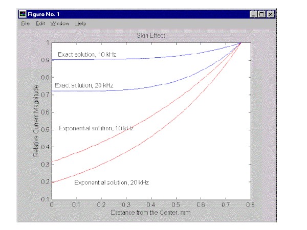

My double Lincoln...
The internal inductance of a cylindrical conductor is 15 nH per foot, given uniform current density profile. As frequency goes up, this inductance begins to lower as a result of skinning.
Skinning requires interstrand conductivity..without that conductivity, the Lenz effect does not happen (like litz), there will be diminished magnetic field exclusion. If this conductivity is non linear, bad things can happen at frequency.
Skin effect at audio frequencies is a myth.
I love those blanket assertions...
Cheers, John
18 Gauge wire skin effect starts in theory at 17khz. (American Wire Gauge table and AWG Electrical Current Load Limits with skin depth frequencies) As I would like my amplifier to have less than 5 degrees of phase shift at 20khz with a back voltage from the tweeter of 10% and a damping factor of say 20 then I would like to see 32 gauge wire used. (Twisted to make say 10 gauge.) I settled on 28 gauge as that is easier to make. See http://www.westpenn-wpw.com/pdfs/cm_PDF/25210.pdf
John we just cross posted on the same thing!
