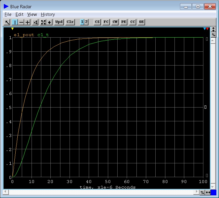

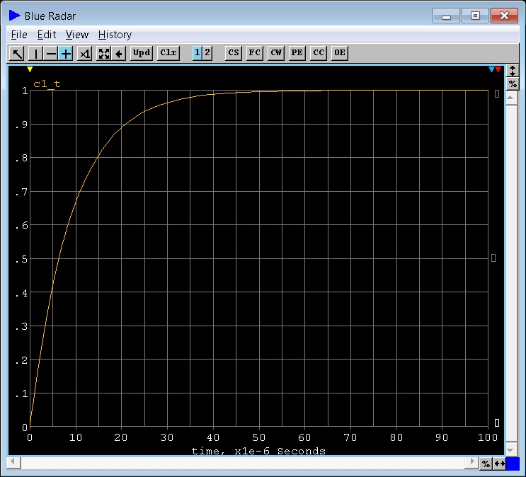

So, Let's talk about a cable of characteristic impedance of 200 ohms. That cable has an inductance of 454 nH/ft, and 11.3 pF per foot (assumption is standard zip cable.
What is the settling time of a lumped element model with L =454 nH and R = 1 ohm? what is it at R = 10 ohms, at 100?
Now, a cable of 50 ohms with an L of 113 nH per foot and 45 pf/ft with R of 1, 10, 100.
Next, a cable of 10 ohms with an L of 22 nH/ft and C of 227 pF/ft. Again, with R =1, 10, and 100.

It will however, show that even a 20 foot long 100 ohm cable cannot bring a 1 ohm load up to 95% value within 5 or even 10 microseconds...something you called "geological").
I await your numbers. I've already done so, and presented the resultant plots.

Come on guys RLC only EE101 style, jn's numbers for 200 Ohms and 20 feet in to 1 Ohm.
20*11.3pF and 20*454nH and 1 ohm with 1ns rise voltage source = 1V, 1/2 power point seems to be 11usec
I'm not going to re-enter my 201 segment T-line but there were little ~40ns steps crawling right up the same line.
No, I copied Bateman's stuff exactly (good thing SPICE has a copy and paste).
Oh, ok..For some reason, I thought it was 10. My bad.
Thanks scott. That's why I posted the numbers.Come on guys RLC only EE101 style, jn's numbers for 200 Ohms and 20 feet in to 1 Ohm.
11 uSec with only 20 feet is rather consistent with my TL spreadsheets.
It's also interesting that Cyril mentions a factor of 3 or more at audio frequencies, which tosses the Z up into 400 plus ohms. But I suspect what you've done here with my numbers should be sufficient.

Super, seems plausible. But 1nS rise time renders it irrelevant to audio. Need to examine 25uS rise time, and examine latency at say 1/2 power point so as to conserve a time reference.20*11.3pF and 20*454nH and 1 ohm with 1ns rise voltage source = 1V, 1/2 power point seems to be 11usec
No, you still do not understand. No matter how slow the slew rate is, the system cannot follow the input any faster than it's step response.
This is a standard control system tenet.

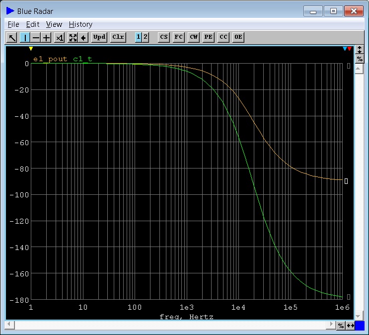

No, that's 3us group delay at 1kHz and 22us at 20kHz. You bandwidth limit the input and still get it, easier to see in the phase plot. Input top (~-45 at 20k), output bottom.
