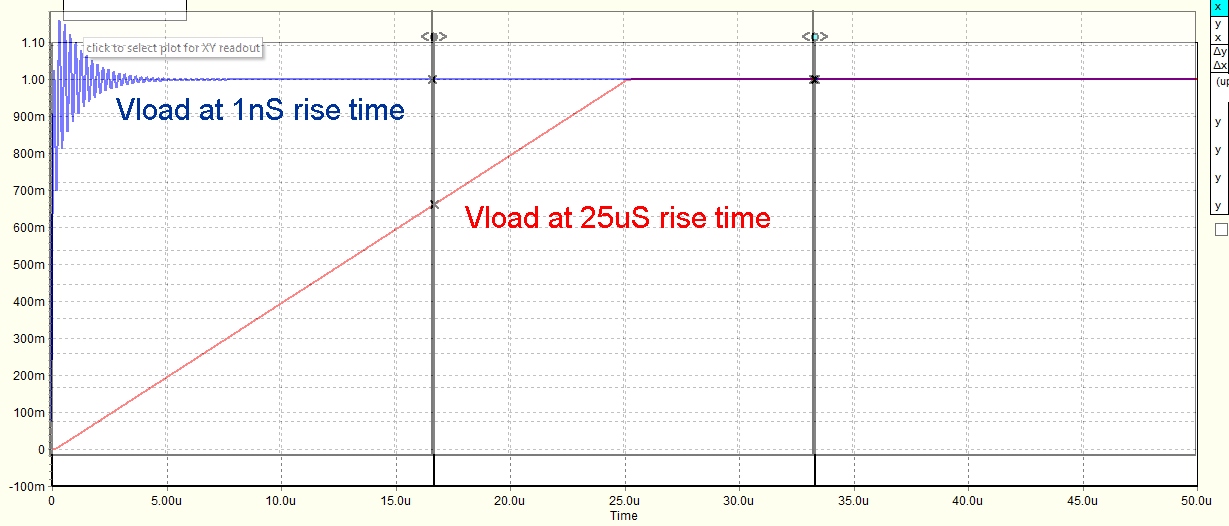

Here's result of a simulation which illustrates game-changing effect rise time has when considering cable behaviour in TL terms in response to a step change. Model is as Scott described, except load is 8R. Vertical is voltage at load, horizontal is time. Blue is for a 1ns rise time, red is for an audio bandwidth restricted risetime of 25uS.
For audioband risetimes, TL effects are obviously negligible.
OK, now run the sim with an inductance in series with the load resistance (representative of the rising impedance that most speakers have from Lvc of the tweeter).

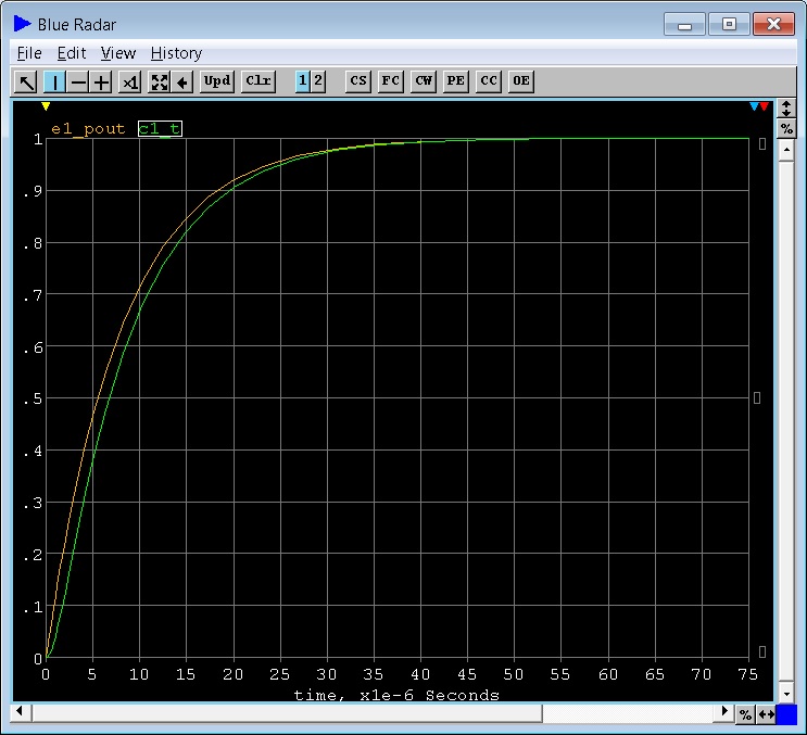

I think you missed some of the background on this. It started with some studies that interchannel delays of as little as 5 usec are audible. I don't necessarily subscribe to any of that in free field listening (maybe head in vice listening). I just like the consistency of the math and physics, Zo, L, C, and speed of propagation are all linked and either way works the same.
BTW your plot maximally obfuscates the issue, 8 Ohms just gives 1/8th the pulse delay maybe inconsequential so what. Audio BW (20kHz) pulse at 8 Ohms.

What's going on in these audioband risetime models is everso simply just the parasitic inductance of the cable in series with the load, forming a low pass filter......... with audioband constrained risetimes there's no TL effect in play for all the reasons already set out. By choosing 1R for the load, you've arranged the filter to have debatable artefacts in the audioband. By choosing 8R for the load I arranged for them to be negligible........either way such effects will be thoroughly swamped by series inductance/complex impedance of real speakers in most cases - but the principle that TL effects are negligible is true no matter what the load impedance.I just like the consistency of the math and physics, Zo, L, C, and speed of propagation are all linked and either way works the same.
For audioband constrained risetimes, simulation shows no difference (versus R load)) to the simulated voltage waveform on the speaker terminals because the dominant extra inductance is within the speaker. Looking back into the cable, the speaker see a low impedance voltage source providing an audioband risetime signal, and this is what pretty much any load sees across the speaker terminals. Obviously internal to the speaker there is a LP filter which has a complex impedance and so current in the line lags applied ramp waveform, no surprises and no audioband interaction with the cable parasitics that simulation shows.OK, now run the sim with an inductance in series with the load resistance (representative of the rising impedance that most speakers have from Lvc of the tweeter).
For rf risetimes, simulation shows a significant differences (versus R load), such as extension of settle time, as TL effects apply and impedance increases with frequency.
