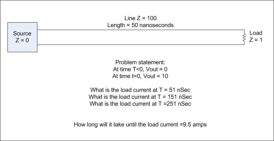

This is meaningless when the line trip is short versus rise time as it is here. There is no such concept as 'matching' in that event. Bateman in that article you link appears to fall for the same trap.When the line and load are terribly mismatched, there will be a settling time which is dependent on the level of mismatch.
Within the constrained spectrum of audio bandwidth and real length cables, looking into the cable the impedance seen by the driver is simply the load impedance no matter what it is, plus lumped cable parameters. If you like, very short lines are always 'matched' in the sense they are invisible.
Alarm bells should ring when equations are used with the term ω angular frequency rather than wavenumber k in a case like this...........very different conditions apply for small wavenumbers.
Remain convinced you've got this round your ears and are mistakenly modelling/measuring artefacts of load impedance or load/amp behaviour, jneutron. Remain convinced it's nonsense, must be. Still reading the Bateman stuff though..........

Neither of you intend on doing what I said to try, that much is obvious.
Here, take this to an E/M guy for the answers.
Another good alternate question. How many transits of the leading edge are required before the load current is 9.5 amps.
Extra credit: change the load from 1 to 100 ohms in steps, say 1, 2, 5, 10, 20, 50, and 100 (easy to plot log scale), and plot the time it takes for the load current to get to 9.5 amperes.(sorry, 95%)
Note that at 100 ohm load, the time to 9.5 amps (edit:95%) is exactly 50 nanoseconds, one transit. edit:whoops, the output voltage needs to be scaled to the load, sorry bout that. Alternatively, use a value of 95% of the final load current value..
Once the answer to the problem question is understood, think about this: The model neglects wire resistance, so to include that means that the line impedance will be higher, AND the prop velocity will go down. As such, the problem as outlined can only give the FASTEST the system can possibly respond to the step.

OK since you ask........ the answer depends on the frequency or risetime of the event being driven by the source...... what happens when a short t-line, say 50 nanoseconds long, is fed by a zero impedance source, and the load is 1% of the line impedance.
For the case where R and G are negligible, as is here :
ZIN = Z0 [(ZL + Z0tan(k)) / (Z0 + ZL tan(k))]
ZIN is input impedance of the line seen by the driver
Z0 is characteristic impedance of the line
ZL is load/termination impedance
k is wavenumber length of the line
In this special case of audio where k ≈ 0 because the line is short yields
ZIN = ZL
Very simply, the driver sees the load impedance, the line is effectively invisible. In this case ZL= 0.01 Z0 as stated - simple as that, in parallel with lumped capacitance and in series with line inductance lumped.
This is easy to simulate, and to measure.
Wrong. Try again. Guessing doesn't count.
Look at the jpeg I made, start over.
Use a 1 pSec rise time.
Then a 1 nSec risetime.
Then a 10 nSec risetime.
In all cases tell us how many transits are required to reach 95%.
Do it right.
Or, alternatively, find a prof in E/M theory, and ask..\

You need to understand the concept of wavenumber, and how small wavenumbers apply to propagation behaviour in elastic systems, such as TLs. All your examples, discussions equations fall apart because of this.Here, take this to an E/M guy for the answers.
Try again.
Please, go see an E/M expert, one who can answer the simple questions I posted.
This is a trivial problem, I am surprised you cannot do so. Well, then again, most people trip up when it comes to t-line understandings.
As the example shows, the load current for this extreme bandwidth question still takes ten plus microseconds to settle to within 5% of the final value, a concept you still do not understand.
Nor do you understand the concept of discerning the lumped element values for the given example, and calculating the LCR response. That'll get close the the same answer, you'll need more than one slice to get closer.
jn
These are not audioband risetimes, the wavenumber is not small so the line behaves as a TL no surprises.......you're missing the point.Look at the jpeg I made, start over.

I use fast risetimes so that people like you might be able to understand the settling time concern.
Clearly, you did not get it. Please learn t-line theory before trying to discuss it.

You need to use audioband risetimes - you'll reach a different and more realistic conclusion, there is no 5uS settle time for the cable and that's why its so tough to measure 🙄
Try again. It's been measured, it's not "tough".
Take the jpeg to a good E/M prof. Get back to us when you've understood the explanation.
Then we can go over the conversion from a pure t-line construct to it's equivalent LCR model, which produces the exact same result I've shown. edit: assume any permittivity you wish, the system is invariant to that.
Remember, the t-line result has been duplicated using an LCR model as well as actual test.
