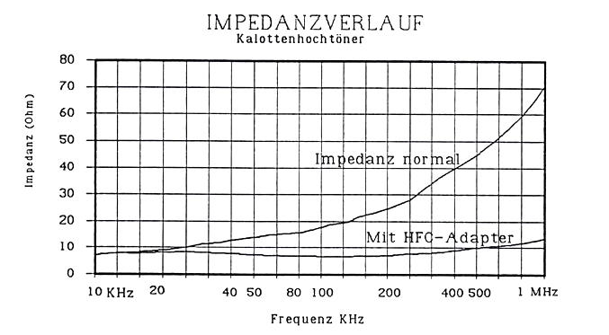

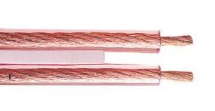

What I took on board from Twisted Pair | Electronics and Electrical Engineering Tools | EEWeb Community was that it is quite hard to get below 50 ohms characteristic impedance with cables. You usually end up near 150 ohms, like with the Cambridge Audio Symphony 400 cable. I think those conductors could be closer.
I suppose exotic methods involve paralleling several cables to get near the 8 ohms of most speakers. Is that Litz Wire?
I quite like the 6 moons audio review of what is essentially Zobel termination of speakers and cables. 6moons audio reviews: OCOS &*Enacom.
I always find that Zobels with bass or tweeter sound smooth. Maybe they work at many levels? 😕

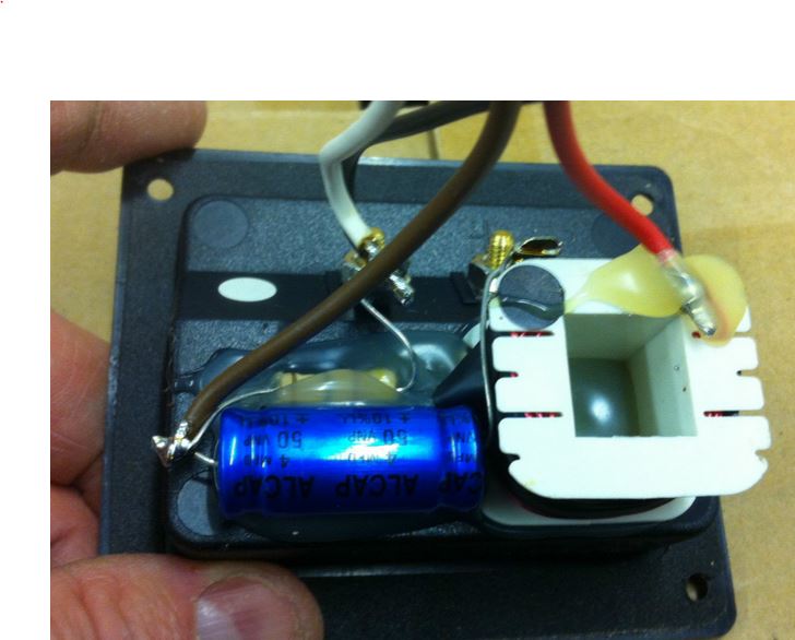

Lastly here's a 47R resistor termination of a tweeter crossover on the metal tweetered first order 3.3uF Mordaunt Short MS10i. Why was it there? Somebody had an idea. 😎

The hostility is to incorrect ideas, whether new or old. The significance of characteristic impedance for speaker cables is incorrect, thoroughly incorrect, no matter how often you repeat it. I am truly puzzled at your stubborn insistence to spread nonsense.
You would probably need superconducting cables to get 8 ohms at audio frequency. You have to get resistance well below inductive reactance from below 20Hz.system7 said:I suppose exotic methods involve paralleling several cables to get near the 8 ohms of most speakers.
How many times do we need to say something before people get it? Not rocket science; you can read about it in any reasonable EM or radio textbook. Not the simple ones, of course, as they just present the RF theory of transmission lines as though it was the whole story - maybe this is where the confusion arises?
You can understand the confusion by looking at the 6Moons link that system 7 posted. If one won't read the basic literature but is eager to lap up the utter nonsense published by audio magazines that are in the business of encouraging ignorance and loosening credit cards, one will believe all sorts of nonsense with a religious fervor. That's system 7's right, of course, ignorance is not a crime, but perhaps websites that do not have a high population of technically competent people might be more "friendly" venues for his silly ideas to be taken seriously and escape criticism.

A parallel pair will run 120 to 150 ohms when one examines the inductance per foot and the capacitance per foot. At audio frequencies, the load determines the final relationship between line voltage and line current. If that relationship is not that of the cable's L/C criteria, then the line cannot propagate that audio signal to the load at prop velocity.
The question I asked on the stripline, how long until the load reached 10 amps?? It was a loaded question. The correct question should be...how long until the load reaches a percentage of the DC value predicted by the load resistance. Because the answer depends on the load to line impedance ratio. The actual question is, how many transits are required to achieve a specific percentage, say 99%. In the example given, that is several hundred transits.
A very good question. A double braid locks out the internal inductances of the conductors, which ends up as 30 nH per foot. 8 ohms requires something on the order of 10 nH per foot. A cylindrical braid does that, flat wide stripline conductors can do that, so can lots of paralleled twisted pairs.And just how do we make a 150 ohm twisted pair at all audio frequencies?
