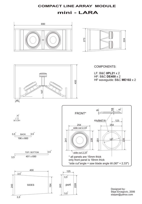

well doing some measurements two RCF HDL20A pre side is only little larger than the bose F1. to a point where i could probably get away with it, one per side for small venues without a problem.. the cost of genuine RCF even second hand puts them out of my reach, but I'm sure the cost of building similar would make it possible even, if i have to cope with one per side for a few months..
I've found a few plans about that don't seam to difficult. the question i have now is would i be better off with pole mounted line array style boxes or standard trapezoid style box.. for throwing the sound to the back of rooms??

did you look at the link to Mr Morris's design?
single elements and for that matter two'sie's of array elements do not perform in the far field as intended (insert complex physics and math explanation here)and if i'm following your thinking with respect to footprint/size turning those on their sides is also problematic...

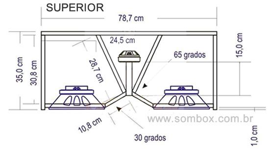

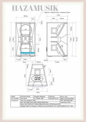

the SMT 12 design looks promising and the hazamuzik one is similar to the Morris design so those would be potential candidates.
yes i did try to look, but the link wouldn't take me anywhere ?

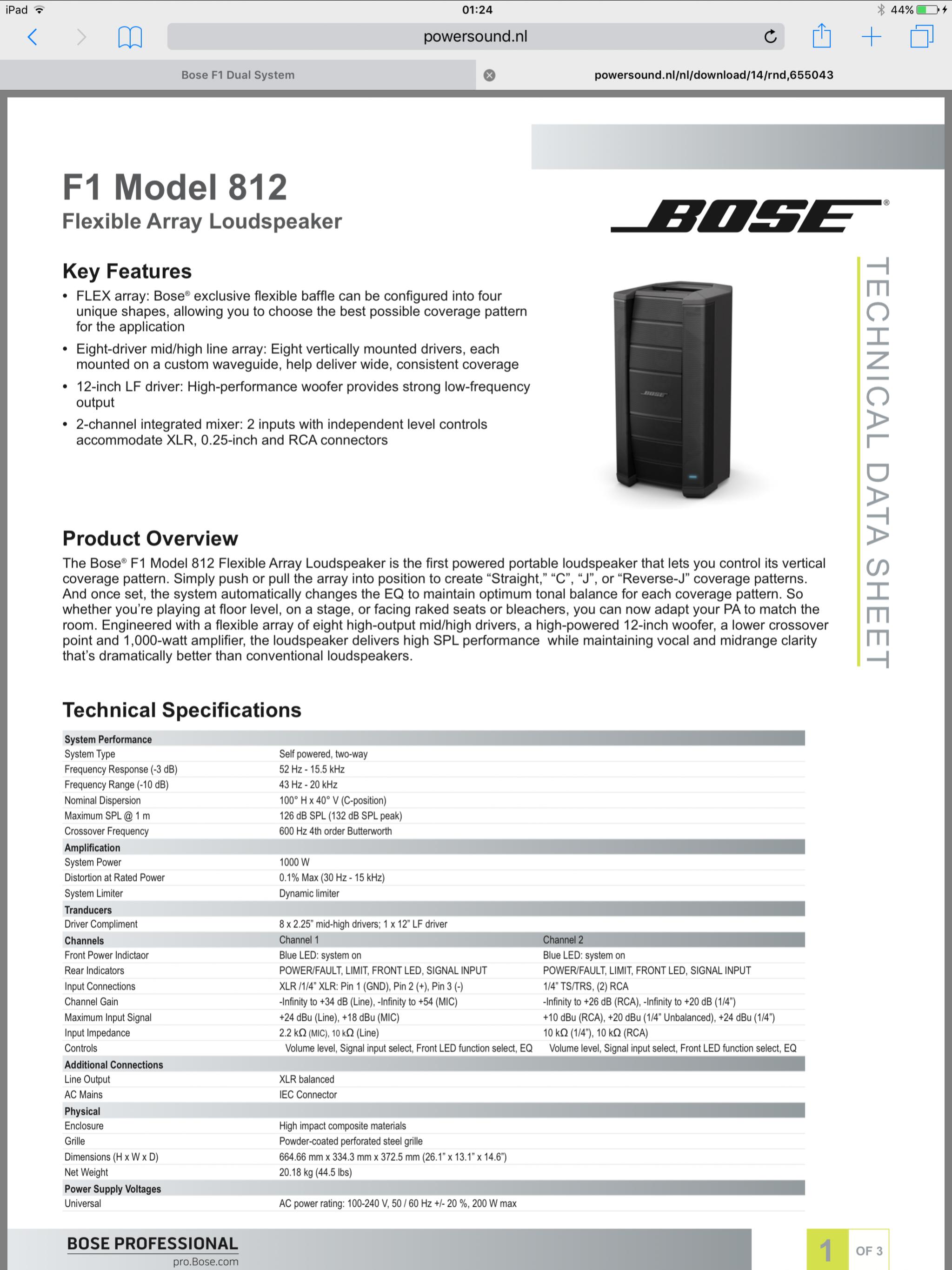

I did some SPL readings today the Bose, with 1 sub and 1 mid/ high.. at 6ft away I can get the kick drum to 85db before speaker clip. And I can get the main vocals to 108db before clipping the speakers... sooo might help give a better idea of what I’m dealing with.

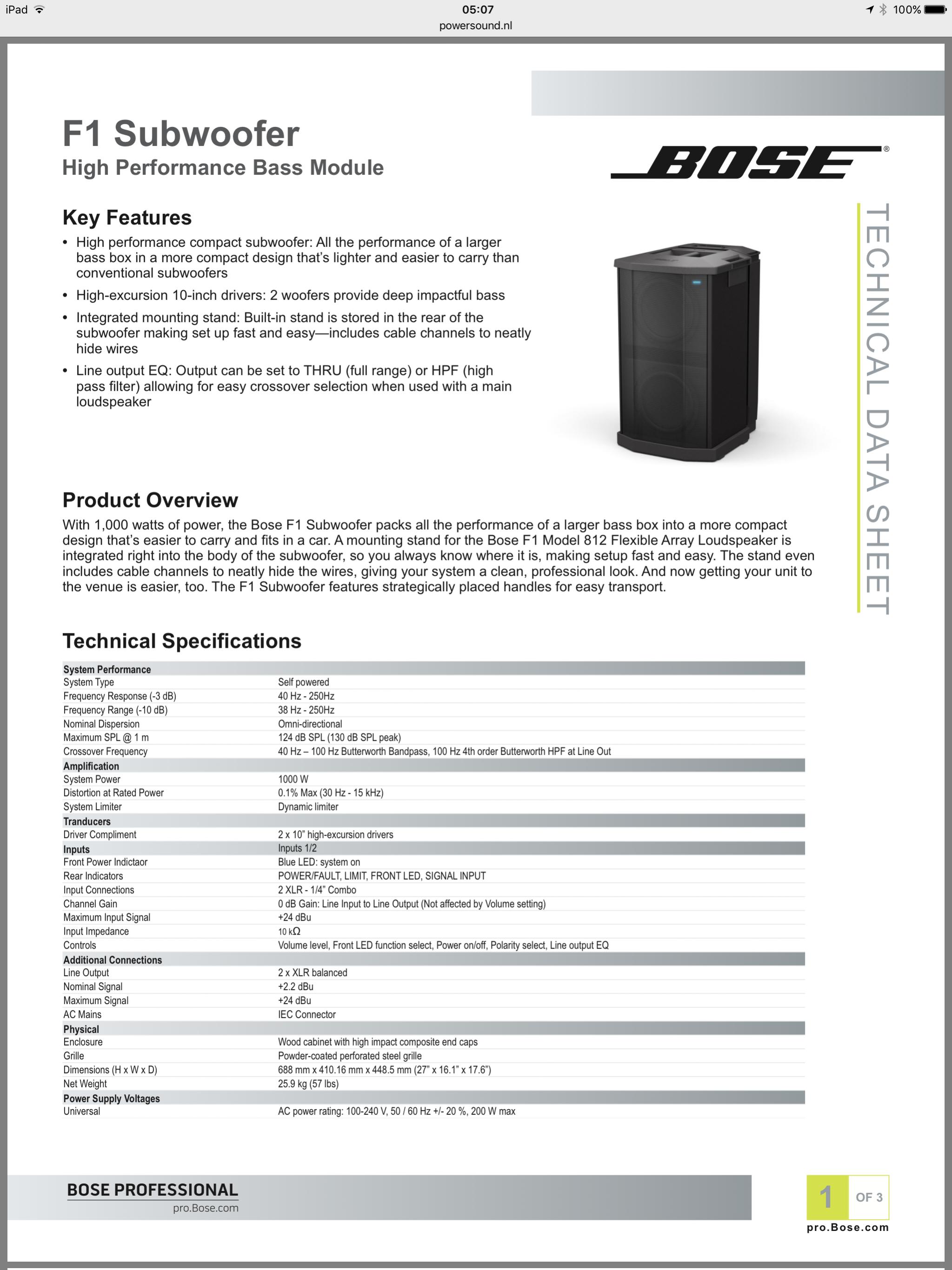

Today I tired every possible way of hooking everything up just incase I missed something. And although I can manipulate the bottom end a little more depending if I use the aux feed for the sub.. no matter what I didn’t the average db stayed the same, the speakers started to clip.. still tones of room left on the channel faders..... with an iPod playing I can get 118db before clipping on the top and 122db in the sub.
Here the Bose specs if that’s any good..... I’m just becoming more and more disappointed with them every time I gig them. They seam like really good iPod speaker but that’s it.
Talking to a pro engineer Friend of mine and the Bose expert and nobody can see anything wrong with the speaker or the way I’m running them, I think it’s just a case of a hype that the speakers can’t live up too..
