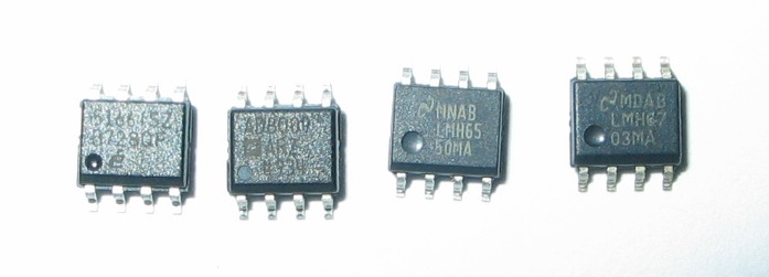

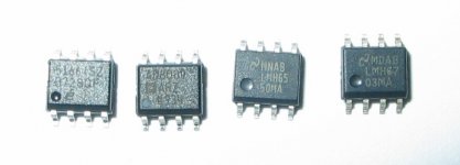

About CFA: have some of those 8-leg critters here. Not only from Analog, but also from National and Intersil. Picture is bellow.
All of them bought with my money, not through free sample program.
And about DMM: It is an internal joke, started HERE.

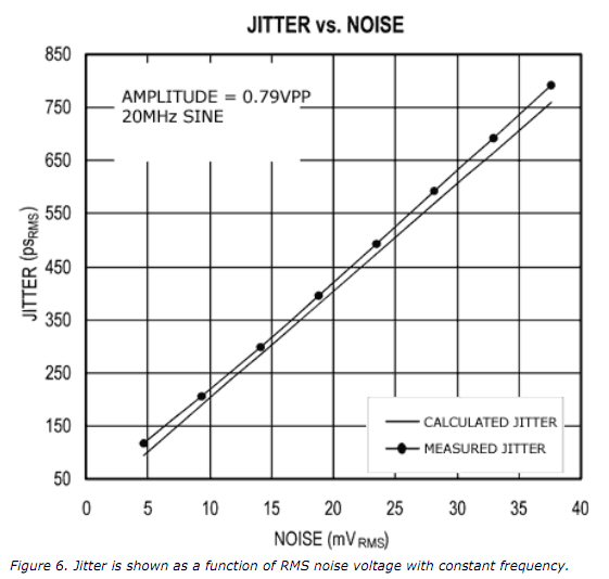

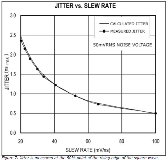

Jitter vs. slew rate:-
The lower pic shows jitter vs. SNR for a sine wave zero crossing, but obviously square waves have a transition point too.
You can see the app. note these are taken from here:- http://pdfserv.maxim-ic.com/en/an/AN3631.pdf
For myself, however I think that concerns about random jitter are overstated, based on the conclusions of this 2004 study:- http://www.jstage.jst.go.jp/article/ast/26/1/50/_pdf
...which found an audibility threashold for random jitter of 250nS.
If anyone knows of any more recent studies, particularly ones that contradict this, I would be glad to know of them.
