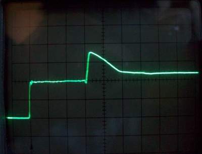

"your" circuit - it's not your's in any way - is exactly the configuration, which is producing this kind of reflection on it's input, shown here below.
It is not +- 1.5 ohm difference. Yes, the reflected wave really is 80 % of the incident wave on the screen there. For > 4nsecs.
Your - not, Eliot's receiver will produce less of it, ~like 30% of the incident wave.
Plus never really reaching 75ohm, like in the shot - so it is everything, but 75ohm.
Beautiful, refined design really. Not worth the price to listen to people like stratus46, when there are THIS capable RF experts at hand.
Ciao, George
Ps.: Vertical is 500mrho, horizontal is 5nsec in this TDR plot
No, it's not mine, I credited Rod Elliott with it. So what's your point?
What isn't?
Yes, the reflected wave really is 80 % of the incident wave on the screen there. For > 4nsecs. Your - not, Eliot's receiver will produce less of it, ~like 30% of the incident wave.
So why are you showing us this? It's not the receiver in the circuit. So what is your point?
What?
No-one can make sense of what you are trying to say.

You have produced a plot of some device showing a reflection, but not the device in question. Why?
You repeatedly attack me on a personal basis and attempt to discredit me because I have disagreed with you. Please try to refrain from this in future. What is at issue here is not my competence as an RF engineer, but the relative merits of the circuits.
w
Oh, looking at your plot, you say 5nS/div, so the rise time is 1nS or less.
I had been only talking of the special merit of this special circuit shown by You,
and saying that it is far from a good termination, on it's input.
If that, a good termination and reflections created are important or not, was not my subject this time. Though, in this thread quite some other persons were discussing exactly that.
