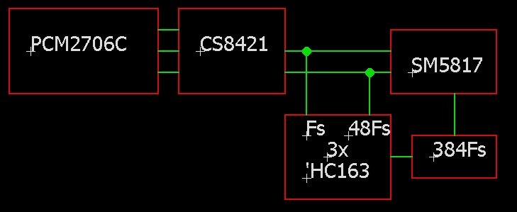

You could use one of these
Change a resistor or two, add 2 74HC163, stick it all on a bit of veroboard and, in combination with the PCM2706C board, you are good to go.

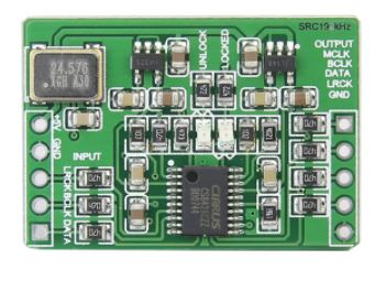

It is an example of an asynchronous sample rate converter. It converts all incoming sample rates within a given range to a set output sample rate
and as part of its function it can perform format conversion.
It could be any sample rate converter, the CS8421 is just an example. This particular board is relatively easy to reconfigure
by simply changing resistor values.
In this case it would act as a bridge between the clock domain of the PCM2706C and clock domain of the cd player.
The PCM2706C board would provide the input signals to the CS8421 with its input side in slave mode. On the output side, also in slave mode, the cd player system clock, 384Fs, would provide the input clock signals to the SM5817 and the CS8421 clocking out the data in the same format as that of the CXD1130. In short, data would clocked into the CS8421 at 64Fs and clocked out at 48Fs the clock rate used by the CXD1130 to clock data into the SM5817. In this setup the CS8421 would not need the 24.576MHz clock or any clock. It is only a little more complicated if you wish to keep the cd player side operational.
