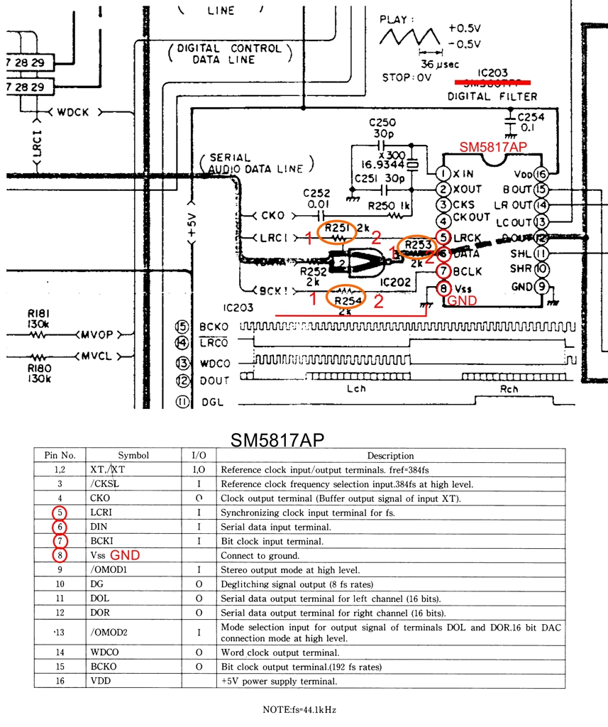

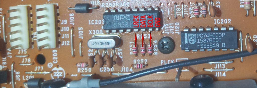

I did the connection diagram.
Do I have to connect before or after the resistors? (Point 1 or point 2?)

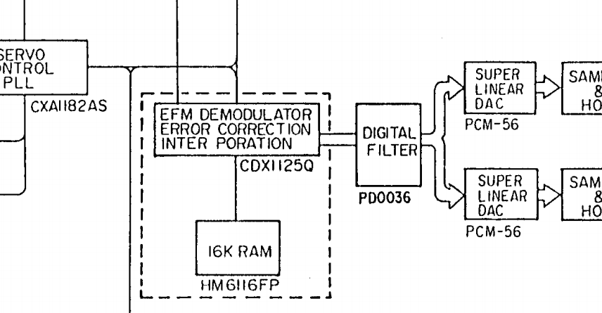

I would use pin one, but they need to be off the board, no connection to the CDX1125.

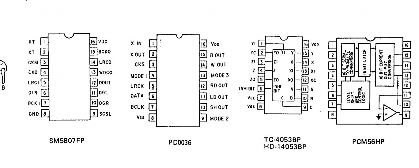

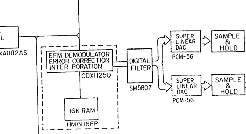

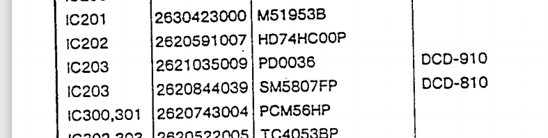

Checkout these pictures from the manual, it is for the 910 and 810 and uses different DF's but the same circuit.

LeeHooker, when connecting the spdif receiver DIR9001
to filter SM5817,
connect all outputs from the dir to the resistors by removing them from the board, and leaving the connection only from the filter side (lrck-r251, data-r252, bclk-r254).
If there is no sound at the output, it may be necessary to switch the date from r252 to r253, eliminating the inversion of this signal. You can also remove the quartz from the inputs 1,2 of the filter and bring the MCLk signal output the dir to pin 1 of the SM5817 .
OK. So...
RECEIVER to SM5817
Gnd ------------> Gnd
MCLK ----------> Pin1 (unsoldered - on air)
Pin2 (unsoldered - on air)
LRCK -----------> R251 (on air) ---------> Pin5
BLK ------------> R254 (on air) ----------> Pin7
DATA -----------> R252 (on air) ---------> R253 ------> Pin 6
If no signal then
DATA -----------> R253 (on air) ---------> Pin 6
RECEIVER to SM5817
MCLK ----------> 100 Ohm ----------> Pin1 (unsoldered - on air)
If no signal then
