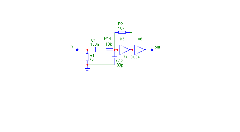

has anyone got a circuit 75 R spdif consumer to ttl levels, i have been using this one but having problems with oscillation (elekor design i think) tried using different versions of the ic.

Reduce R18 to 1 K. Reducing it past that probably won't help much. Get rid of C12. Make sure that it is the HCU04 version.
Some guys say that it has a tendency to oscillate with no input......I never had problems. Bypass, bypass, bypass. Keeps leads short.......etc.
Jocko

1st make sure that it is 74hc_U_04
The U stands for unbuffered. each inverter is just a komplimentary fet-pair. with R2 X5 is driven to his working point (yes it's analog !)
2nd the circuit should work fine 🙂
i use the same circuit without R18 and without C12.
Some people vary R18 between 0 - 10K, some people use a 10k resistor from output X5 to ground ...
telefunken use in his DA1000 a transformer with a transistor after instead.
There are many ways 🙂
Regards
Jobstens
Leave R18 in. The open-loop gain of an inverter is usually around 20 or so. Some may be a bit higher, but 50 is definitely the upper limit. Lowering it after a certain point buys nothing. Except:
Taking it out will lower the input Z. While 1K in parallel with 75R won't throw it off too much, 2K will lower it less.
Jocko

I don't know why you had trouble with it. An 'U04 inverter is only a pair of CMOSFETs tied together. It doesn't get much simpler. Did you use the right one...........i.e., unbuffered?

yep im sure i tried the unbuffered types different manufactures too, the thing is very unstable (oscillation) when left open circuit, i want to have 5 of these stages on a pcb what i require is a circuit that works the complexity is not a problem as i am not what i would call a 'noob'
