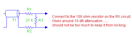

Hi, Just a minor problem, but I fail to see your circuit terminates the cable with 75 Ohm.
The diodes Jocko keeps complaining about have no sonical impact.
Part of the termination is on the primary side of the transformer, and the rest is on the secondary side. The two 150R resistors give 300R of loading (termination) and this in parallel with the 100R on the primary side gives 75R. Be sure to note the the two logic gates are not really there... this is really a differential output opamp.
(Actually there is a small problem in that the 150R and techinically in parallel with the 1K resistors, for 130R each side, or 260R total. This in parallel with 100R on the primary side gives termination of 72.2R)
If the gain of that op-amp is high enough, the inputs should look like virtual grounds. Haven't built one to confirm the actual value.
And don't you mean it will be 150 ohms in series with 1K divided by the op-amp gain?
Aha. I had forgotten to switch my brain to differential output mode and made some errors in logic. You are right that if the opamp has high enough gain, then the inputs should become just like virtual grounds and the termination will be accurate. However, it's not a given that this is the case for all frequency components in the S/PDIF signal. The circuit that 300_baud posted doesn't list the opamp used, but it had better have a very high GBP.

Another tweak that Jocko recommended to me! For me, it removed the last bit of harshness in my system. I wouldn't say it's 10x better, but there is a slight difference. Besides, it's easy to implement and doesn't cost a whole bunch of money either.
BTW, these three resistors go in front of the zobel network that was shown in jocko's spdif input circuit as shown in a few messages before.
Take care guys,
300_baud
