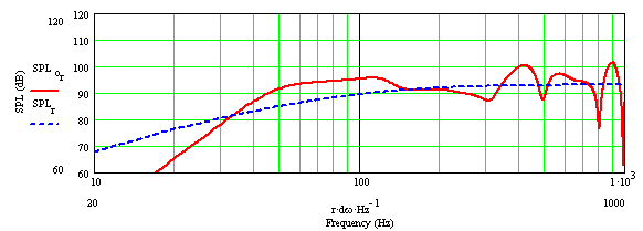

Would changing only the horn expansion affect the ripple around 100hz.? If so, couldn't that be used to eliminate or greatly reduce the ripple by having the 2 horns different, but equal in length so you don't cause any phase issues?
Good question. Yes, is the answer. Something I'll have to look into at some point. There's pressure differences too, with the lower mouth seeing a greater reflection boundary condition than the upper. Experience suggests it's not really an issue though -the 126 sounds beautifully ballanced even at high volumes -for an impartial view, see Steve's write-up of our recent (& very enjoyable) Fostex and tube amp bash: http://web.mac.com/scress1958/iWeb/Steves_Tube_Trials/FostexFest.html
The ripple at ~ 100Hz in the 207 horn is actually the upper cut-off of the horn. It's more a point of view than anything else -some designs go for a wide-bandwidth of operation, some a narrow. This, and the 126, are a relatively narrow bandwidth designs, and operate in electrical terms like reflex enclosures below this frequency, down to their lower cut-off. This sort of thing is much more common in PA and Arena horns I believe.
