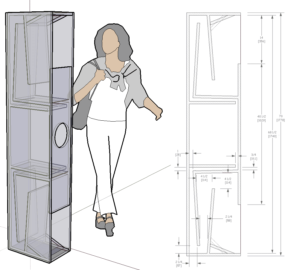

First CAD drawings are now complete. Dave suggested calling it the Son of Harvey doublehorn, which sounds favourite to me. Only question is -do we need a Daughter of Harvey doublehorn for the 16x series? 😉
Best not -yet. Dave'll be after me with a shotgun if I suddenly drop another on him. 😀
Scott
Scott
Scottmoose said:First CAD drawings are now complete. Dave suggested calling it the Son of Harvey doublehorn, which sounds favourite to me. Only question is -do we need a Daughter of Harvey doublehorn for the 16x series? 😉
No, no, 16x "of Harvey" was expected, from Son of Harvey, spawn of Frugel-Horn, comes Iris, Duagher of Harvey Horn ... a lovely mix of the finese of the smaller & the bass & dynamics of the larger...
Sounds very viking... that family can join Fonken, Mama Fonken, and Papa Fonken, and maybe Baby Fonken.
dave
here is the sketch... plans are non complete, but enough to build one. Mail me if you want one.

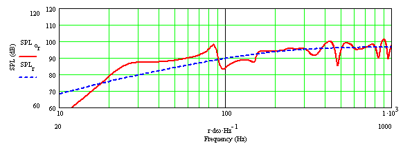

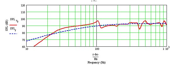

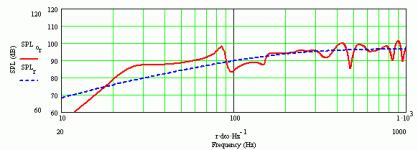

Son of Harvey with the Fostex FE208ESigma, just in case anyone wanted to know what happens when you put a lower Q driver in it.
Something good, that's for sure... 😉 FE206E looks similar. In room, they should be flat to the mid 20s (apart from a bit of ripple, which isn't much as horns go), with sensitivity up around 96db for 1w. The original 126 based Harvey Horn, with valves, and in a decently sized room will give a solid 40Hz; far lower than I anticipated, so I'm being a bit conservative here -I have a suspicion that ~20Hz is on the cards if current experience is anything to go by. These things really do couple to a room well.
A Daughter of Harvey double horn with the FE166E? Best get MathCad fired up... Be nice to complete the family.
