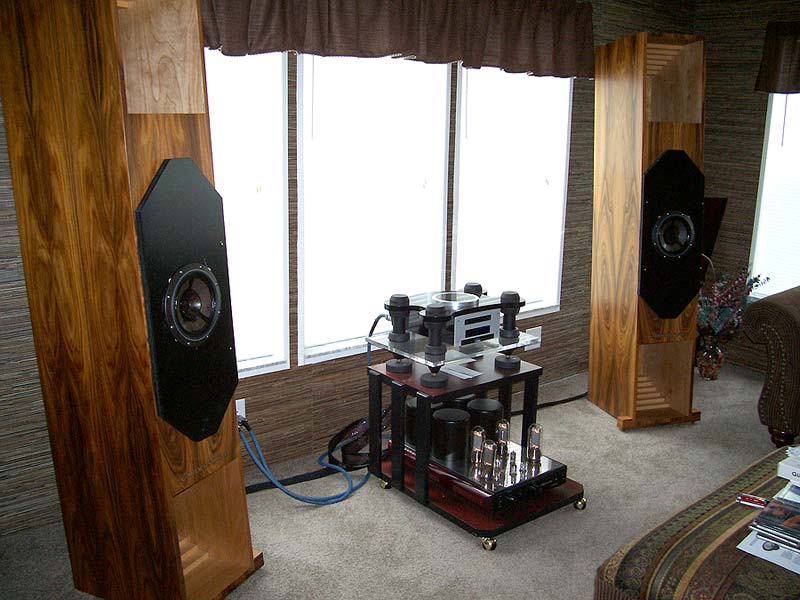

Madison/Sachiko Improvements
I purchased my Madison speakers aka Sachiko from Jeff Carder of CarderSound, one year ago this July 2009. Since then I’ve been trying various improvements and/or tweaks in an effort to progressively extract every last bit of musical refinement from the Madison/ Sachiko speakers.
The latest improvement/tweak is the addition of the black panel on the front of the enclosure, please see photo below. The purpose of adding this panel was twofold ---{the panel now being used isn't a permanent one}--- first it was to expedite the exchange of different 8in full-range drivers in order to rapidly compare the sonic qualities of these differing drivers ---{because the panel isn't permanent it can be screwed into as a driver requires without worry of marring the cabinet}--- secondly was to test if it's addition would improve the cabinets sonics.
One Saturday I had two friends over that are also members of the SETriodes forum and Central Florida Audio Society. We compared a Fostex FE206E, FE206ES-R and a Lowther DX4 in the Madison with the panel installed. I should mention that both of the Fostex cones were treated with a little known process that's incredible in it's ability to ameliorate the problems single full range drivers with whizzers are noted for, without causing any tradeoffs in the areas these drivers excel at, whereas the Lowther driver was stock.
After careful listening we came to the conclusion that the installation of this front panel aided in increasing transparency & detail. It's certainly not a night & day improvement but for the cost of a couple pieces of wood and the time it takes to cut and mount them it's a worthwhile improvement. Best part is you can try it by mounting it to your front via some of the existing drivers mounting screws & then screwing your driver to the new front panel! If you don't like what you hear you can always easily remove it with no damage to your existing cabinet, no?
If anyone is interested in other improvements/tweaks I've tried don't hesitate to ask. I'm always happy to share what I've learned with other full range driver aficionados. One I'll be happy to share right now is lean your speakers backwards! If you'll look at the photo I provided I've done this with my speakers and doing so improved imaging & soundstaging quite dramatically. Strangely enough it also seemed to provide a better balance of all the frequencies as well! Heck you should at least try it. It costs absolutely nothing but a few moments of your time. Once I leaned my speakers backwards I could never go back to how they sound firing straight forward again...
PS: Photo was too large to attach. Send me an email at thetubeguy1954(at)yahoo(dot)com and I'll be happy to send some good pictures of the front panel and the speakers leaning.
Thetubeguy1954
Where is that photo??
Tyimo
Tyimo
Tyimo did you miss the end of my post? I stated PS: Photo was too large to attach. Send me an email at thetubeguy1954(at)yahoo(dot)com and I'll be happy to send some good pictures of the front panel and the speakers leaning.
I just sent it to Dave aka Planet 10 and he said he'll make it small enough and then post it. Thanks Dave!
Thetubeguy1954
Tyimo said:Where is that photo??
what is the panel made of.....rubber?
I could see cork layer on wood panel working too...
