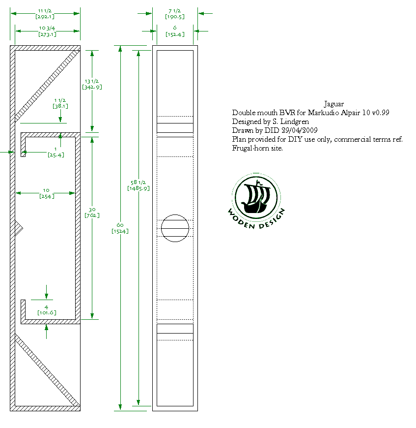

For the Markaudio Alpair 10: Jaguar -first pass plan. Like Lotus & the new Riley box for the Alpair 6 (next on the list), it'll accept 1 unit, or 2 in series. Bit previous, as Dave hasn't had chance to draw up the 'proper' plans yet, but as interest in the MA drivers is unsurprisingly increasing, I figured the time had come for an intitial airing (although I want to make it plain the walrus is innocent, and cannot be held responsible).
Been wondering, and given the recent designs this seems like a valid place to ask:
When you design a box for two drivers, does it matter if you hook them up series or parallel? Do T/S params or box design care about this your choice here?
I didn't think so, but then I realized I wasn't sure...
Yes, it does make a difference. All three boxes of this type I've done for the Markaudio drivers (3rd for the Alpair 6 coming shortly) assume series wiring.
2 drivers in series, Sd, Vas, Re, Le, Bl all double. SPL remains per single unit. 2 drivers in parallel, Sd & Vas double, Re & Le are halved; effective increase of 3db in practice.
Ah ha. Once again, that which seemed simple from a distance sprouts further complexity when approached.
With your advice I am fore-armed. Thanks.
It's just something to be aware of. For e.g., with the MA drivers, I went with series wiring because they're already relatively low impedance units, so parallel wiring would drop things below 2ohms, which is a nightmare load for most amplifiers.

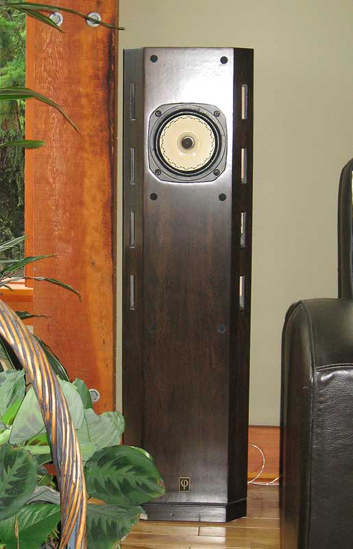

Lurking for a while, first post.
Wondering if there has been any further development on the curved fronts for the saburos?
Have had a set of mules set up since Christmas and these just keep getting better! Would like to see if there is more performance to be squeezed out of these yet.
Would the curved front change the sweet spot for the listening position, or does listening position stay similar (same) and time alignment is more correct?
Listening room is 14'x50', current sweet spot approx 13' out.
MANY thanks to Scottmoose for these designs!

archrival said:Would like to see if there is more performance to be squeezed out of these yet.
If your drivers are stock there is a whole lot more you can get out of them.
http://www.diyaudio.com/forums/showthread.php?s=&postid=1773260#post1773260
dave
Followed that thread with much interest, build was going on about the same time.
This pair of drivers is probably approaching 450-500 hours.(previously in iBIB and A126) Basket arms have been damped, magnet to basket "junction" has been filled for air flow, 5/16" underlay on back of magnets to reduce reflections. Have not yet found puzzlecoat.
