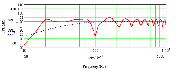

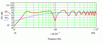

If you want to take it to extremes, boost internal width to 15in, depth of the sealed end to 5.375in, depth of the terminus to 21.5in, & shift the driver 79.875in down from the sealed end. See attached. This is with 0.25lbs ft^3 of damping above the driver. You can damp the peak at tuning down by increasing the density to 0.5lbs ft^3 if you wish, but I thought you might like the extra gain for the sim. These are for sub duties, not use as woofers, so I wouldn't run them too high -below ~60 - 80Hz or so. You could go lower of course, but I'm thinking that with 8ft build material, this is as large as practical for a simple single fold design.

No, just the usual stuffing to suit (if any) in the peak and since it will be BW limited to LF, none elsewhere.
For 'stereo', ideally you would put them in diagonally opposing corners, i.e. left front/right rear for example, but this requires a very low XO point for use with ~full range mains. Otherwise, both corners of the sound wall and accept the 'sawtooth' response it yields if you don't tune them individually to complement each other, which is well beyond the scope of the casual DIYer. Thanks to our poor LF hearing acuity, this isn't nearly as obvious/bad sounding as it implies though.

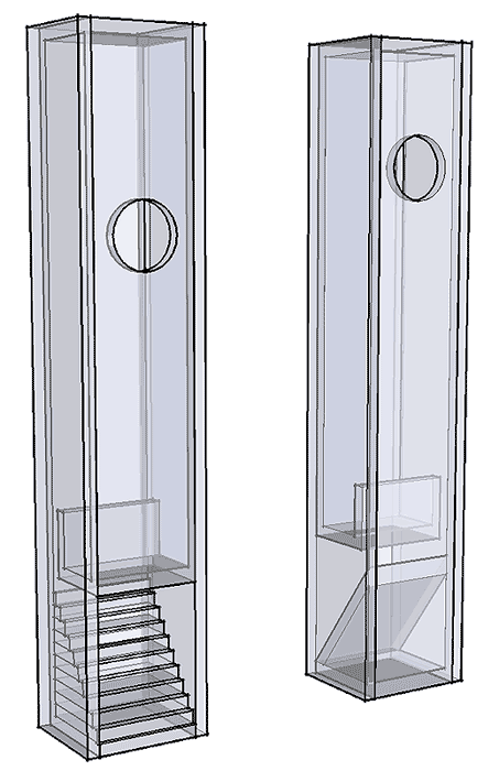

Popeye (aka half-Olivia)
We may be slowing down, but the flow hasn't stopped...
http://p10hifi.net/tlinespeakers/FH/download/popeye-1v0-map-230908.pdf
This one is also leading to Olivia 2v0
dave
dave
