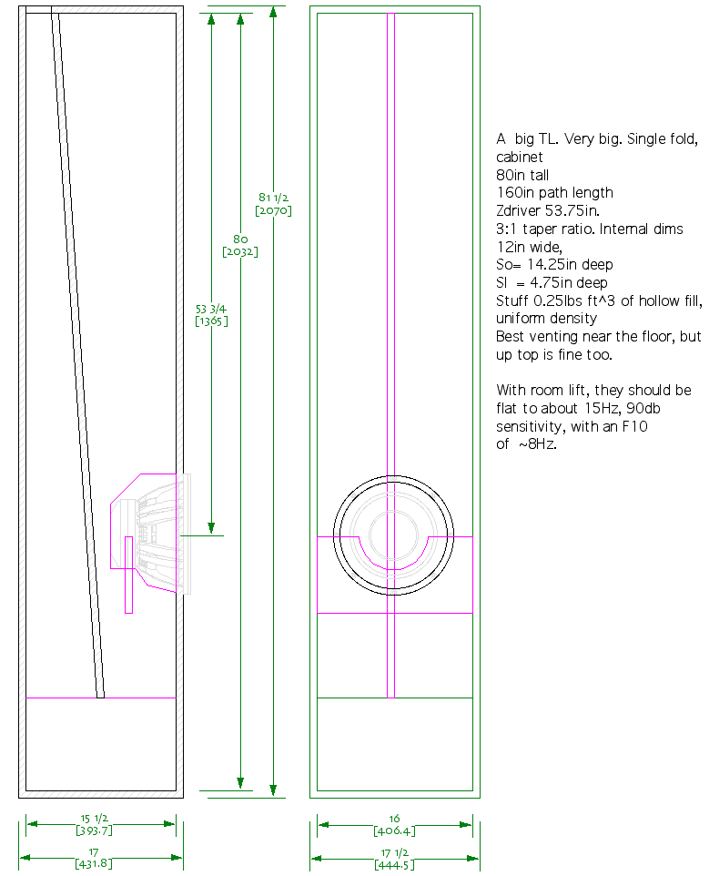

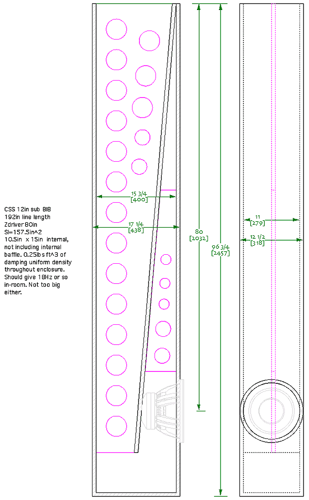

For sealed you don't want to go any bigger than gives you a system Q of 0.5/
You can have problems with too large a bass reflex as well...
You want large try this...
dave
nuconz said:while it might work well in a small box, won't work "better" in a big box? [/B]
dave
