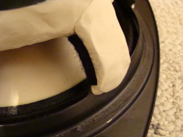

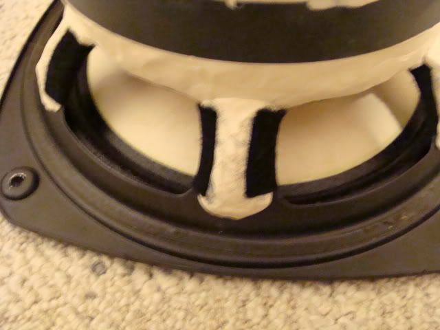

Hello all. I got some time to put some more damping in the cabinet as well as apply the felt to the spokes as was suggested. I found a way to apply the felt without using glue which I view as being a plus. I simply cut the strips to size and wrapped them around and smashed them into the modeling clay slightly. I then came back over the top with more modeling clay to seal it all together. Right now I have the carpet matting on the top, bottom, and back of the chamber. And of course the matting on the back of the magnet. I did not apply any felt to the magnet but I may later. I suspect I'm at the level of diminishing returns. I took care that the matting didn't inpede the port at all.
From a subjective viewpoint there is undeniably a cleaner sound coming from the speakers than before I added any damping material. I don't know if I have to much damping material in the cabinet or not but it sounds very good to my ears.

Marsfrogie said:Hello all. I got some time to put some more damping in the cabinet as well as apply the felt to the spokes as was suggested. I found a way to apply the felt without using glue which I view as being a plus. I simply cut the strips to size and wrapped them around and smashed them into the modeling clay slightly. I then came back over the top with more modeling clay to seal it all together. Right now I have the carpet matting on the top, bottom, and back of the chamber. And of course the matting on the back of the magnet. I did not apply any felt to the magnet but I may later. I suspect I'm at the level of diminishing returns. I took care that the matting didn't inpede the port at all.
