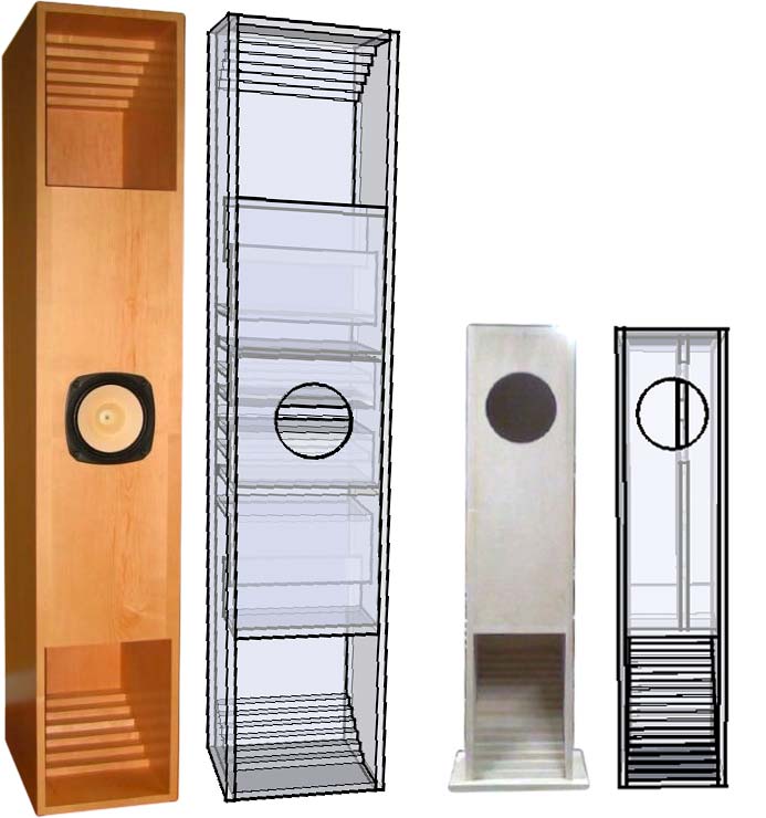

The Brynn is a BVR - yes? If so how do you get around the FE126's limited Xmax (advertised as 0.35 mm by Fostex) in a bass reflex cab? When I try to model this driver in the Fostex recommended BR (or a MLTL or TL) the Xmax is exceeded at freqs below 100Hz at only 1w of input. Could the Brynn be modified to turn the large box into a small compression chamber and the "vent" into a longer linear horn? That way the FE126 could be better controlled at low frequencies.

Too bad he doesn't give any credit to where he got the designs. I do know it says on the frugal horn site that these designs are open for people to make for profit, but you could at least give credit where credit is due...

Well, it's nice to see that my cabinets (& Dave's CAD plans of them) are apparantly well-regarded & been used to good effect. It's quite flattering actually. Especially when they think one of them is worth $6,500pr.
They are open source designs, but there are some stipulations we make. Firstly, that at least a link back to the frugal-horn site and reference / credit (or should that be 'blame?') is given to the people who actually designed the cabinets. A donation is not required, but a nice gesture too. I wouldn't say no to a free pair of the double horns for example (though that's a trifle optimistic).
The other stipulation is that in the case of all my cabinets, & the Metronomes (the others I'm not sure about -Dave?), a commercial license of Martin King's MathCad software is needed for commercial production, even if it's not used by the manufacturer, as this was what was used by me in the design process. Unfortunately, these points haven't been made very clear on the site as yet, so partly our fault. Even so. it would have been nice to know that they were going to make some & to get some feedback on the cabinets, which is what it's all about. First I've heard of it. Thanks for the heads up George.

The 0.35mm Xmax is a bit low in an ideal world; it should still sound OK at modest volumes though as the 126 overloads quite gracefully.

I can see that Scott has already addressed this in part, and he's certainly better qualified to answer the technical aspects far better than I, but I think that by the time you modified the Brynn to the extent you describe, it would be on a different branch of the Frugalhorn/ Spawn family tree.
As of the time of this post, Dave's website or server is offline, but I'm sure mr Moose can clarify where that would place it.
In practical terms, overloading the Xmax isn't a huge issue in my 200ft^2 listening room.
1 watt RMS into FE126E in either Brynn, Buschhorn MKI, Frugalhorn or ronC's A126 is more SPL than I need for my listening tastes - YMMV
Driven hard enough either the FE126 in any of the referenced enclosures or 127 in Fonken or Mileva can certainly be overloaded - but in my experience, more gracefully than the CSS FR125
